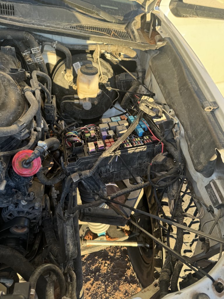

    Not ideal with how I have my fuse box secured. You think a wire could’ve been getting pulled or something.

    So you think that’s definitely the problem lol. Just run through all the fuses, replace them if blown and just make sure thier isn’t any pulling going on with the wiring to the fuse box?

    The whole engine bay is a problem.
    And I don’t mean that to be offensive.
    No fender liners and a jank fuse box mount??????!

    Yea I was looking to get the most up travel I could get with a 35 so just decided to cut out the wheel wells entirely lol

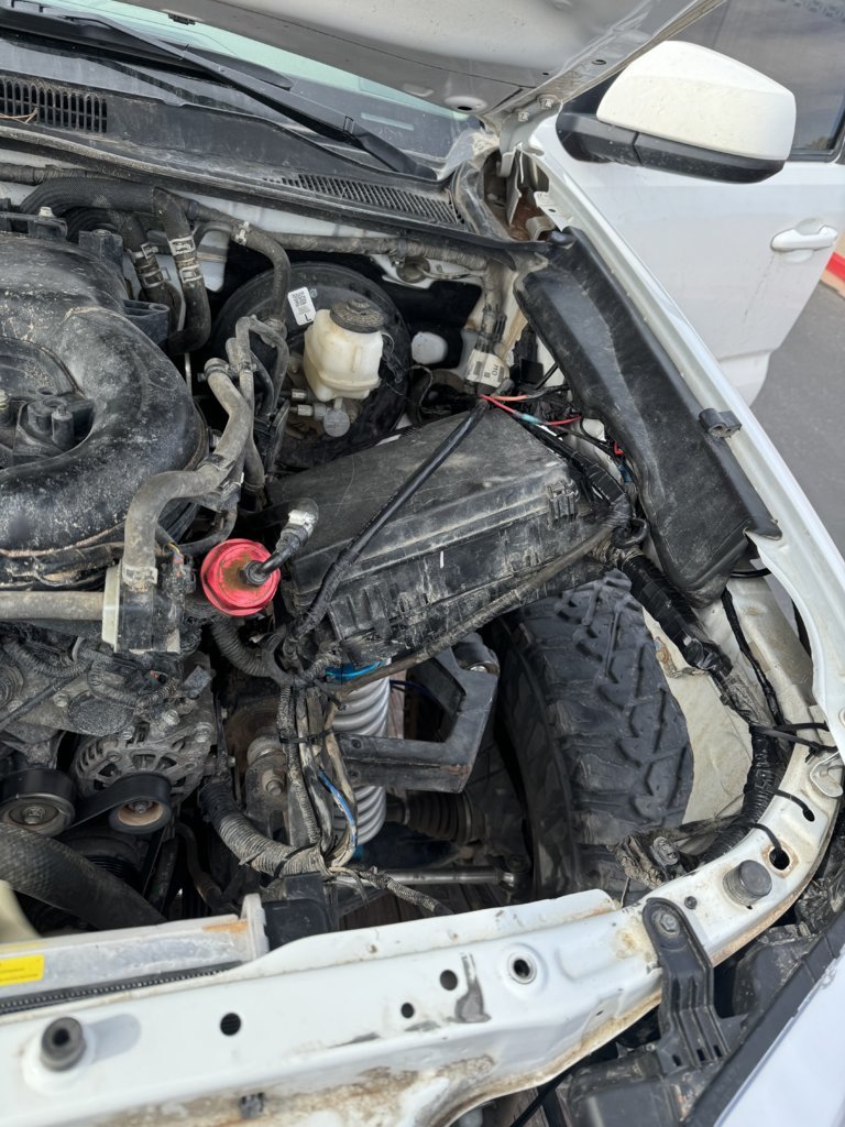

    It’s a desert truck and doesn’t go through much mud or rain. My plan was to mount my fuse box/ abs system/power steering to the engine cage I bought from te designs. Many people have cut out the wheel wells. I just noticed a 40 amp fuse for battery charging was blown so I’m rapping that now and then go from thier.

    Batteries mounted in Backseat, made sure all connections are nice and tight. I’ve resecured my fuse box and cleaned up the area and secured everything much better. Thier was a 40amp fuse blown for the battery charger, some lines had exposed metal that was able to touch other things and I also found a wire that fell out. All is in tact now. If it’s still going to limp mode I’d say its gotta be the broken intake plenum valve, I’ll check that next if I’m still having issues.
