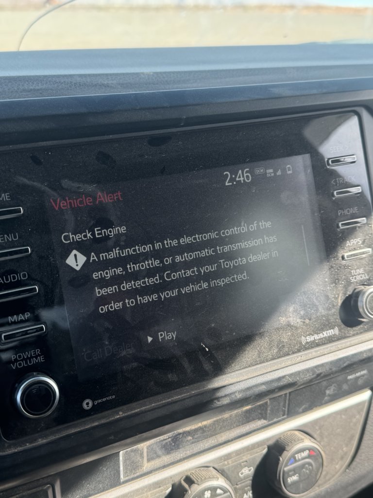

    This is the message I got this morning after tidying up the engine bay and securing everything properly.

    You still have the same codes?
    And do you have your own scan tool?

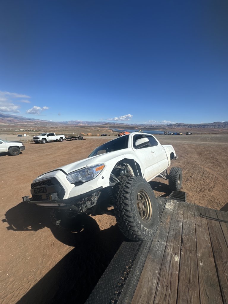

    It’s super common for the wheel wells to be cut out lol. It’s totall

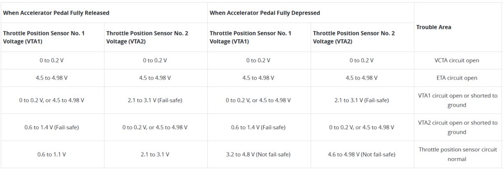

    What happens if you replace both and the issue is still there?
    There's a wiring harness between the TB and ECM.
    And there a possibility that something is physically stopping the throttle plate from moving.
    Both the parts you are "replacing" are not cheap.

    Yea that’s what they told me. They didn’t want to look any further into the vehicle with how modified it is. I mentioned to the tech that he should check voltage on throttle and explained the same thing you told me to do. He would’ve done the test but I figured I just save my money and spend it on a scope meter to have. Thank you for the voltage chart provided. I will find a graphing scope meter.

    Bro what? This truck has full custom suspension on trailing arms and a +5 kit up front. Just because the stupid wheel wells were cut out don’t mean it’s destroyed dummy. I know you guys like to keep your little tacos nice and neat and never beat on them. The engine and trans are fine, all it needs is some electrical fixes. Otherwise I’m saying fuck the 2g 3.5 and throwing in a 6.2 ls3 baby!

    It’s a one of a kind build, it works really well through big whoops and go fast shit.

    I'd check the throttle voltage with a scan tool.
    Then move to the TB or wiring and on to the ECM depending on the findings.
