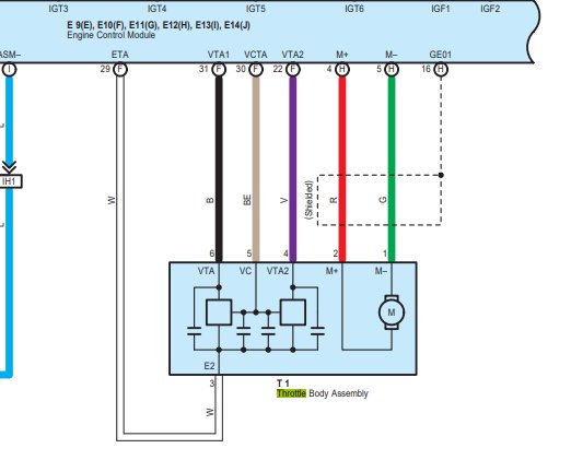

    @Booleo I did check out the Insta.
    That's actually a pretty sweet rig. And now I understand, - "Why"?
    My first guess would a wiring issue. Even more so if you ran the truck hard with engine bay the way it is in the pictures.
    I'm betting something got pulled loose. And would not be surprised if something is broken somewhere.
    I'd want to check the wiring integrity to the ECM.
    You can do at least one simple test right at the TB.
    It will check the 5v ref and ground.

    adding some colors. White is ECU ground, Beige is 5V reference

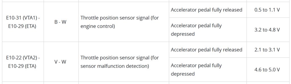

    @Booleo , have you tried to unplug TB connector and plug back in?

    Yes my go to every time has been to disconnect throttle body and battery for a couple hours and then it comes out of limp mode.
    I tested the throttle body connector from port 3/5 and got a 5.05v steady reading.

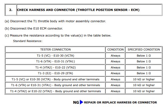

    Check connector pins for the tension, oxidation, etc.
    Get a scanner and test TPS voltage as described in post 26.
    You need to verify if other wires are not damaged by checking resistance between TB connector pins and ECU connector pins. If all good, replace TB

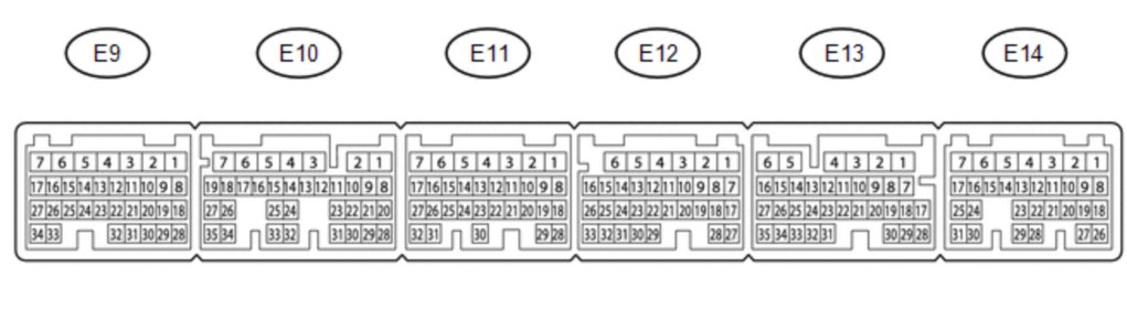

    If OP knows how to back probe.
    He can do it "faster" at the ECM
    Check it right at the ECM.
    We know Ground and VC are good. (He checked that at the TB)

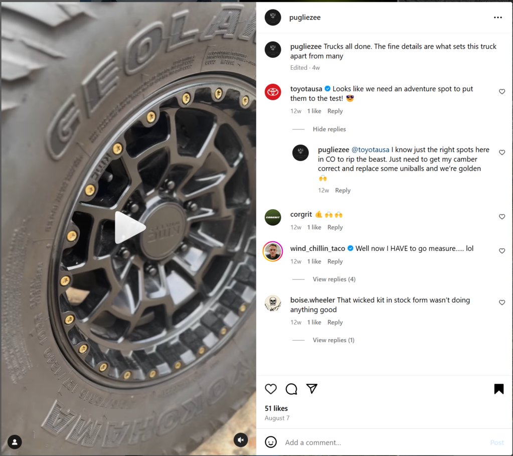

    What tires are those? They look like skinnies. I have tentative plans to go up to skinny 35’s, but the tire options are few.
  15. Nov 1, 2024 at 7:10 PM
    #55
    MGMDesertTaco
    MGMDesertTaco Come on, live a little...
    Jan 30, 2021
    #354573
    10,470
    They look like Yokohama geolander mt's g003.

    I checked out that tire but don’t see any skinnies above 33”.

    They are Geolanders. But I don't know the model.
    I'm not a tire guy.
    You all should seriously check out his IG.
    Good stuff.

    I see xxx/76r16 which suggests they are 32” non-skinnies. The picture angle must me fooling my eye. OP said above he was running 35’s. Old pic?

    Ok. I missed this earlier.
    Should one follow Toyota flow chart.
    It basically says,
    Open live data on your scan tool.
    Monitor the following data PIDs below, while wiggling the wire harness (at and) between, the Throttle body and ECM.
    Throttle Position Sensor No. 1 Voltage
    Throttle Position Sensor No. 2 Voltage
    And Throttle Position Command
    If any values change while wiggling the harness and connectors, fix issue.
    If not, replace TB.
    If TB does not fix issue, replace ECM.... (Yeah, That's a 50/50) o_O
    ---Since it says the TB is sticking OPEN. You might want to have a look at the TB and see if it's sticky/gummy. Have someone press and release the gas pedal while watching the TB.
    Maybe it's super dirty and sticky. If so, it wont shut as fast as it needs to, and this will cause the CEL to come on.---
    Booleo[QUOTED][OP] likes this.
