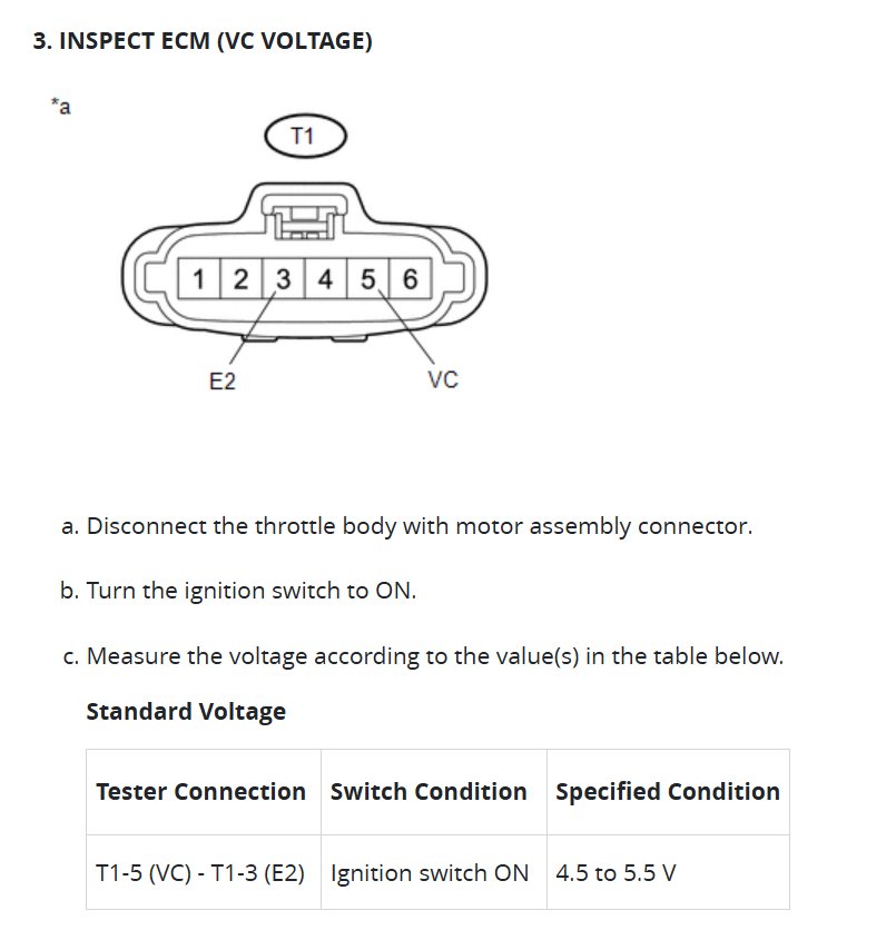

    I’ve got a volt reading of 5.03 volts at the t1 connector on pins 5 & 3.

    are you getting p2103? If yes, see below

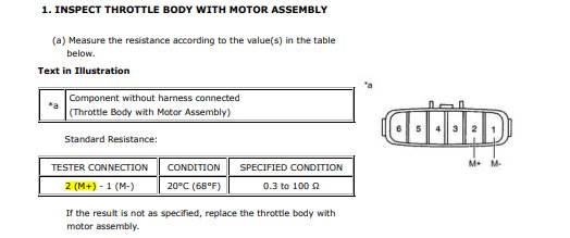

    if you checked and confirmed the wiring, next step is replacing parts. Check TB motor resistance

    Just checked resistance is at 004 on option 2000 with no decimal.

    so the resistance is normal. how did you figure out that you need 8Amps to move the motor? did you apply the current at TB or at ECU end? TB should not care if there is a limp mode. ECU controls it.
    Did you probe the wiring resistance from TB end to ECU end? See attached for some information on TPS voltages and resistances.
