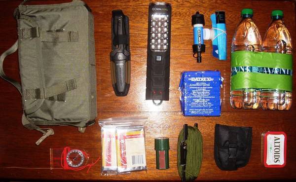

    I also wanted to share this. When I deployed I really liked that all of the vehicles had go-bags. In a contingency environment, these usually consisted of ammo and some MRE's. While I don't need 500 rounds of ammo at home and my day-to-day routine doesn't take me to areas where I would need this kit, I still like to be able to take spontaneous off-road trips and I feel more comfortable doing that with this kit. If the vehicle has a failure or gets stuck and is not recoverable, I have more than enough supplies to get to help. I put two of these together, one for my truck and one for my wife’s vehicle.
    Right to left, top to bottom:
    .30 cal Feeder Bag from First Spear (discontinued)
    Gerber Myth Field Dress Kit
    Goal Zero Solar & Hand Crank Flashlight
    Sawyer Life Straw
    Datrex 3600 Calorie Food Bar
    2L of Water
    Sunto Compass
    2 Mylar Blankets
    Stormproof Matches
    100 ft of Paracord on a Spool Tool w/ Bic Lighter
    Pocket Chainsaw
    Basic Fishing Kit in Altoids Tin
    Since this picture I've added some Baddest Bee Fire Fuses. They're made from beeswax so they supposedly don't have a shelf life like Wet Fire.
    Everything fits perfectly into the feeder bag with the exception of the 2 liters of water. I’m planning to run a circuit under the seat of each vehicle to keep the flashlight charged at all times.

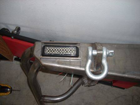

    Since I ordered a bumper that has an integrated tow hitch, I wanted a surface mounted reverse light that wouldn't require removing too much material from the bumper. I wanted something that was low profile and preferably LED. I did not want something that hung down below the bumper and could potentially be ripped off or damaged by a rock or brush. What I came up with are Star DLXT strobes for emergency vehicles. They can be programmed to use different patterns, including a solid burn. They're definitely not as bright as Rigids or other popular lights but they're surface mount, low profile and should be plenty bright for what I need.
    http://www.911lights.com/products/dlxt
    I had a little trouble deciding where I would mount these on the bumper. If I mounted them outside the shackle mount, they would throw the light where I needed it but would be vulnerable to backing into trees, swiped fenders, etc. If I positioned them inside the shackle mounts, they would be more protected but I would likely have a hot spot in the center and not much light on the edges where my mirrors can actually see. The solution was to mount them outside the shackle mounts and have tabs welded above and below the lights to protect them. Here it is mocked up:
    I intended to take more pictures of this but my camera battery died after the first two pictures. I'm going to try to get the tabs welded on Saturday along with some expanded metal that I cut out for the 4" fog light openings in the All-Pro front bumper. After that, the bumpers, rock sliders and skid plates will be going to the powder coater.

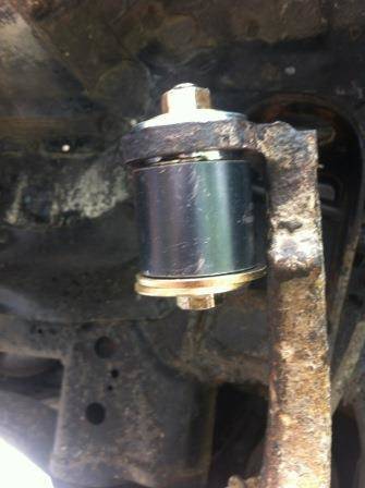

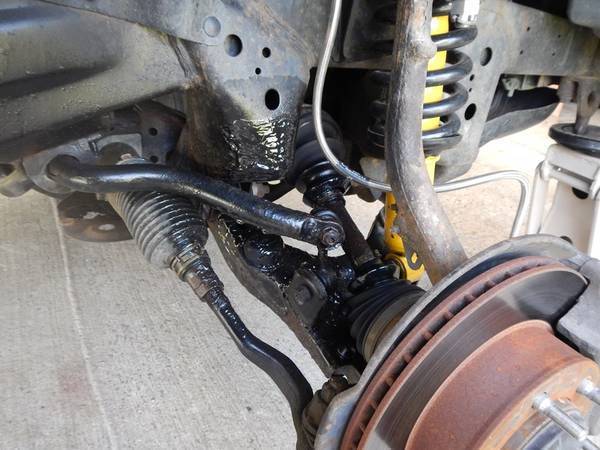

    I had intended to not do anything on the truck before doing the tune-up. However, the engine is running well and this past weekend my dad was available to give me a hand with the suspension so I decided to tackle that first. Unfortunately, by the time we finished the front, storms were moving in and we weren't able to do the back. We installed OME nitrocharger shocks with 882 springs and Light Racing upper control arms. Here's the front finished:
    Removing the upper ball joints was a bit of a challenge but we managed to get them. We found the best way to remove them was to separate the ball joint from the upper control arm with a three jaw puller, then cut the bolt off of the ball joint with a grinder, put the fitting from the ball joint press on top and press the ball joint fitting with the three jaw puller. Pressing the fittings in for the new ball joints was actually a lot easier than I expected thanks to a setup my dad rigged up:
    The upper portion is just a grade 8 washer that protects the press fitting from getting marred by the impact socket. The lower portion is a receiving sleeve from a ball joint press and two grade 8 washers. The upper and lower portions are connected by a grade 8 bolt with the nut on top. We cleaned the opening, greased the press fitting, then heated the spindle and hit the nut with an impact. Each side pressed in in about 30 seconds.
    Today I took it in for an alignment and had the shop install the Crown Performance extended stainless steel brake lines that we didn't get around to Saturday. This is the third vehicle I've taken there for an alignment in the past month so they installed them for practically nothing.

    After replacing the ball joint with yet another NAPA ball joint, I still had my suspension knock. Just to be sure, I replaced both lower ball joints with Toyota OEM but STILL had the suspension knock.
    After taking our trip I took the truck to 3 different shops, including the dealership, to figure out what the knock was. One of them finally diagnosed it as play in the left CV axle allowing the CV axle hub to 'slap' the differential when going over bumps. I replaced the differential needle bearing with a bushing from East Coast Gear Supply this past weekend and haven't heard the sound again. Hopefully that issue is resolved.
    I did get to do some minor trail riding on our trip but since I was the only 4WD there, the tractor was broken down and my winch wasn't wired yet, I didn't want to get into anything too hairy.

    I finally had some time this past weekend to get the winch working. I managed to cram a Warn ZEON 10-S into my All-Pro bumper but had to either trim my grille or relocate the solenoid. I really wanted to avoid trimming the grille so I wound up mounting the solenoid remotely. My truck does not have cruise control which left a large open spot on the passenger side of my engine bay. This was just a little further away from the winch than the relocation kit allowed so I wound up having to extend the cables by another 18" or so using 6 connectors similar to these:
    You can see 3 of them just outside the solenoid in this picture. The red wire you see is the 12V outlet that I installed in my xtracab space for my ARB fridge:
    Because the space was open but not completely empty, I wound up having to mount a plate to raise the solenoid up. First, I used a dremel to square up three existing holes that were for the cruise control so I could use carriage bolts. I wanted to use these to prevent sharp edges in the wheel well.
    Then I used 3 pieces of ~2" metal tubing to raise the aluminum plate above what I think I remember was the ignition control. The aluminum plate mounted via the carriage bolts and the solenoid mounts to the plate.
    The wires were then run from the solenoid, under the air box, through the headlight opening and to the winch. I cut a piece of fuel line open and wrapped the headlight opening to prevent the cable from lying against the sharp edge.
    And here's a shot of the bumper with winch and prolink:
