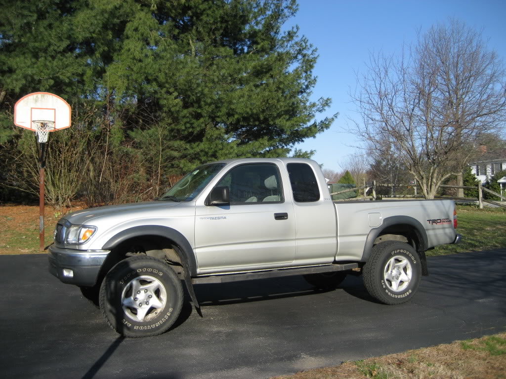

    This is my 2004 Toyota Tacoma XtraCab 3.4L V6 Manual 4x4 SR5 TRD Offroad in Lunar Mist Metallic.
    I bought it brand new in 2004 with 22 miles on it (some of which were my test drive).
    Truck is for sale:
    https://www.tacomaworld.com/threads...ed-cab-v6-manual-4x4-trd-off-road-sr5.535213/
    How it looks today:
    fQdxNSj0ac-cJJxanXhrdQ1k2p2et8VCqiXr12QY_d66480c3cb4ec119bf97621abad93b86fc5995b4.jpg

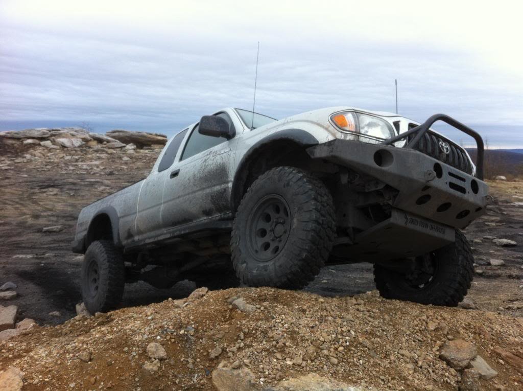

    And here's some of my favorite pictures.
    OBX - September 2012
    With the new toy:
    Rausch Creek - June 2012:
    Rausch Creek - March 2012:
    KM2's mounted:
    Jersey - February 2012:
    138462d1329761735-south-jersey-cold-weat_5ed0ae6474992d24fa84e9449b33d0b290c38f3a.jpg
    Beech Creek - January 2012:
    Rausch Creek - August 2011:
    Rausch Creek - July 2011:
    First wheeling trip at Rausch Creek - April 2011:
    Older pic from the mall crawling days but I like it. :notsure: And one of the oldest pics I can find of my truck.

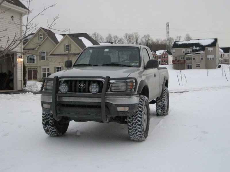

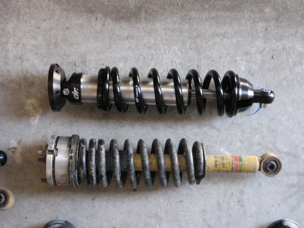

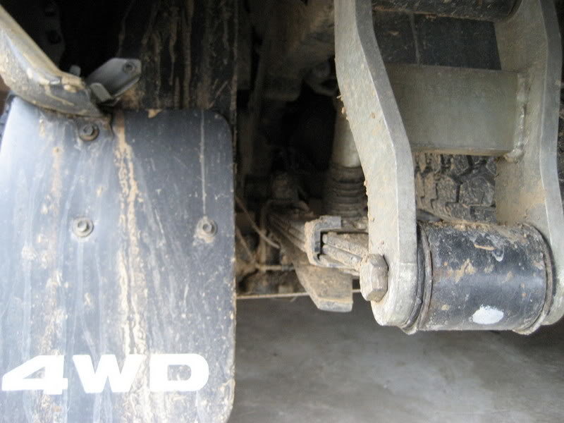

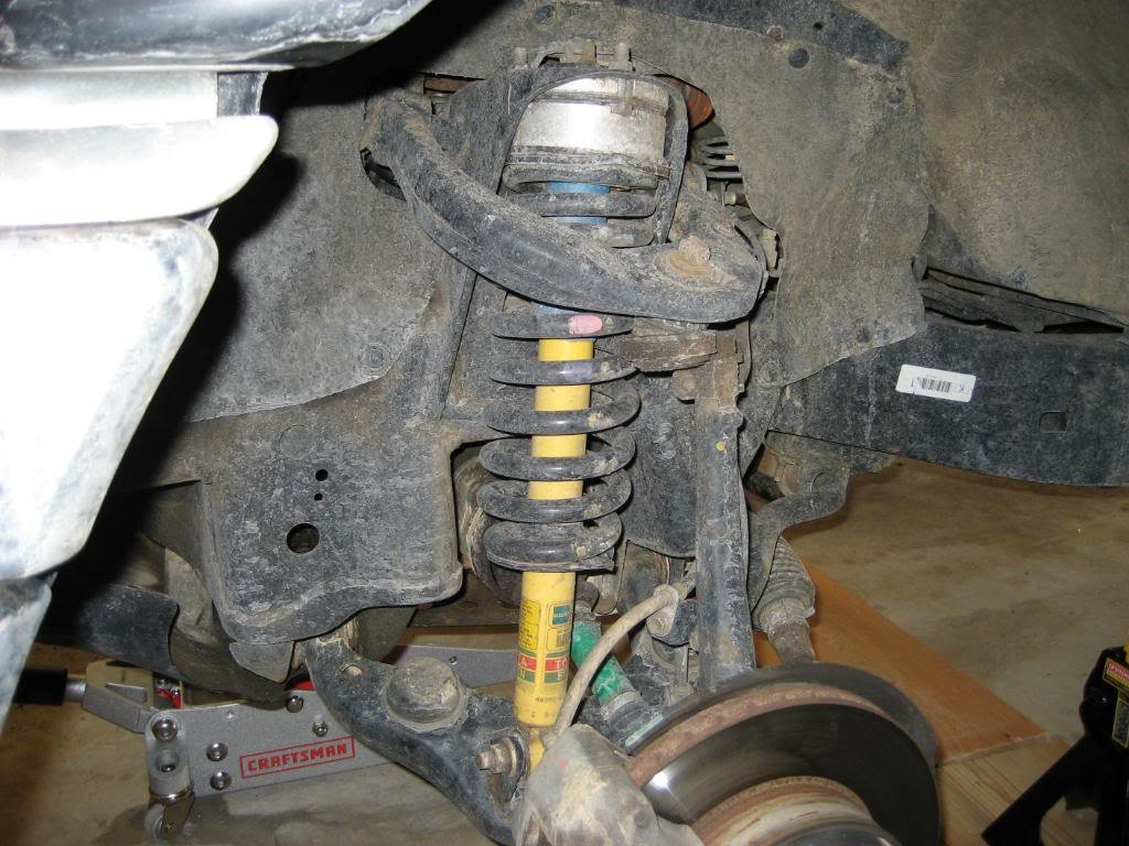

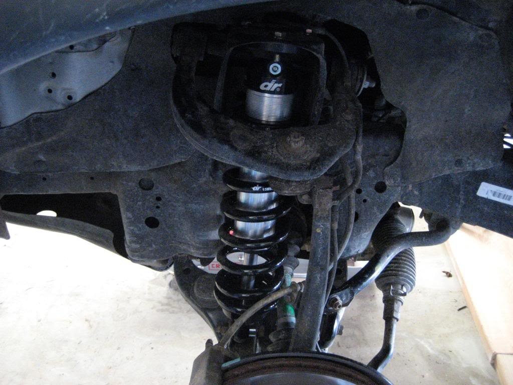

    Two years after I bought it I put my first lift on. Unfortunately I went cheap and put on spacers up front and extended shackles in the rear. I think it only took me a year to get sick of the ride so I decided to spend the money and get Icon Coilovers (then Donahoe).
    Spacers:
    Icons:
    Side by side:
    Ride was so much better after putting on the Icons. I think I put them on in mid 2007 and have had to get them rebuilt once in late 2010 because one was leaking. I keep the old ones around with the spacers still on as backups now. Came in handy when I sent the Icons in for a rebuild.

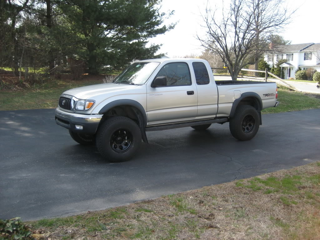

    Summer of 2011 I decided to to get some new wheels. I wanted black wheels and to stop using the 1.5" wheel adapters (or spacers if you prefer) I had to get the stance I liked. I went with 16" Pro Comp Extreme Alloy 8069 w/4" backspacing.
    Before:
    After:
    Here's a comparison of how it looks from the front with stock wheels vs. with the 1.5" wheel adapters vs. with the 8" wide wheel with 4" backspace.

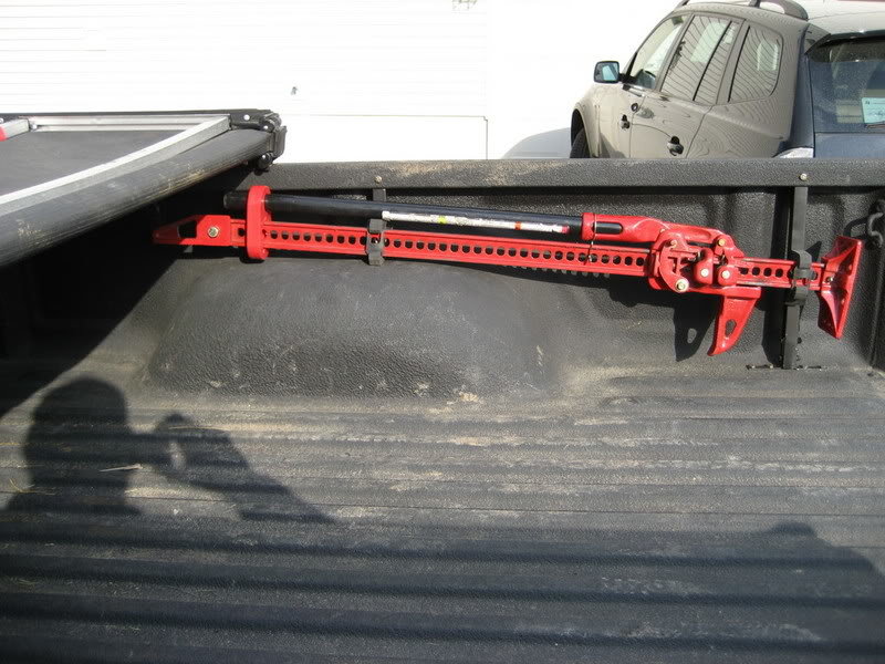

    I mounted my 48" High-Lift jack on the passenger side of the bed. I was able to position it so that I could still work the clamps for my Torza-Top tonneau cover. I used some square tube bolted between the bed rails and the the bed and a couple quick fist clamps.

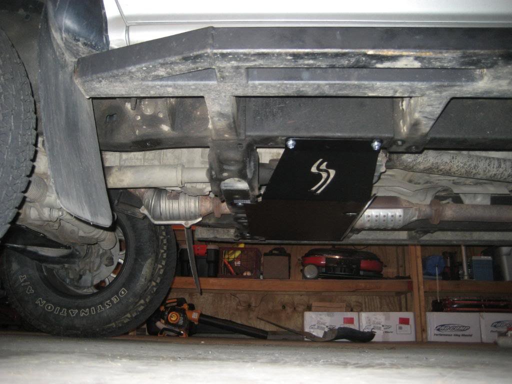

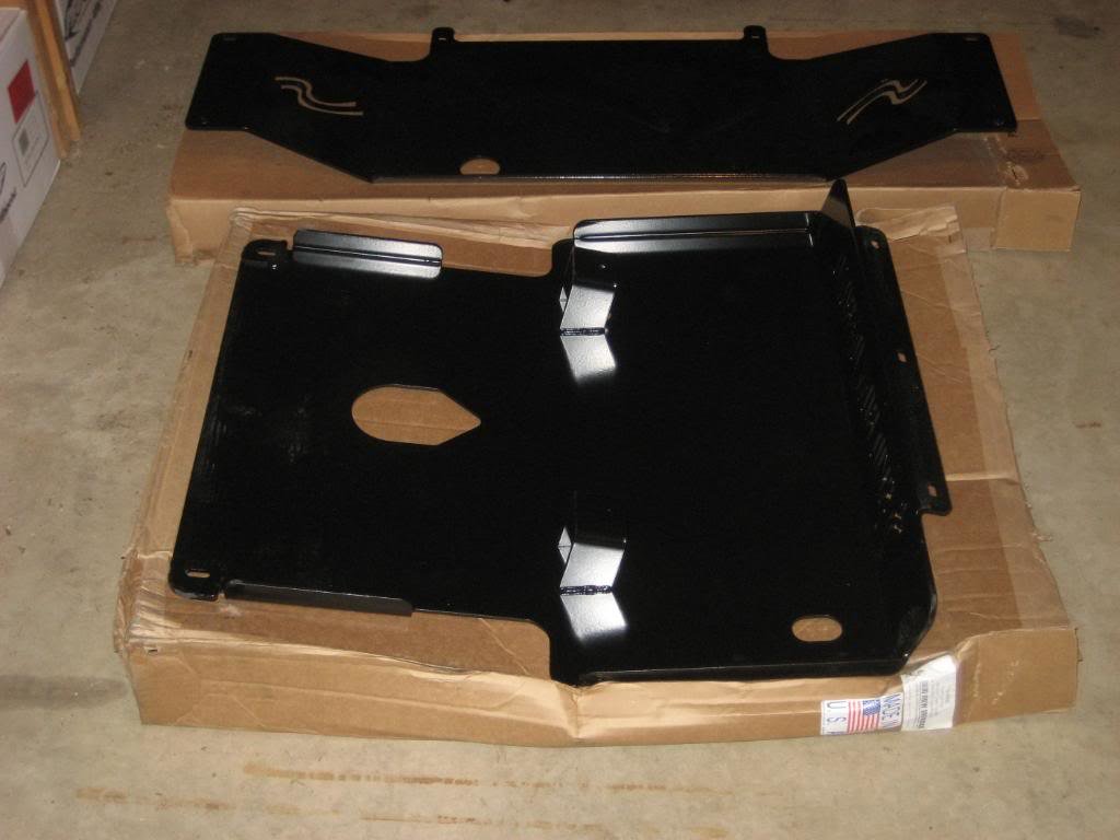

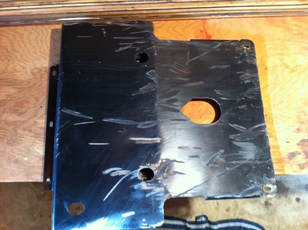

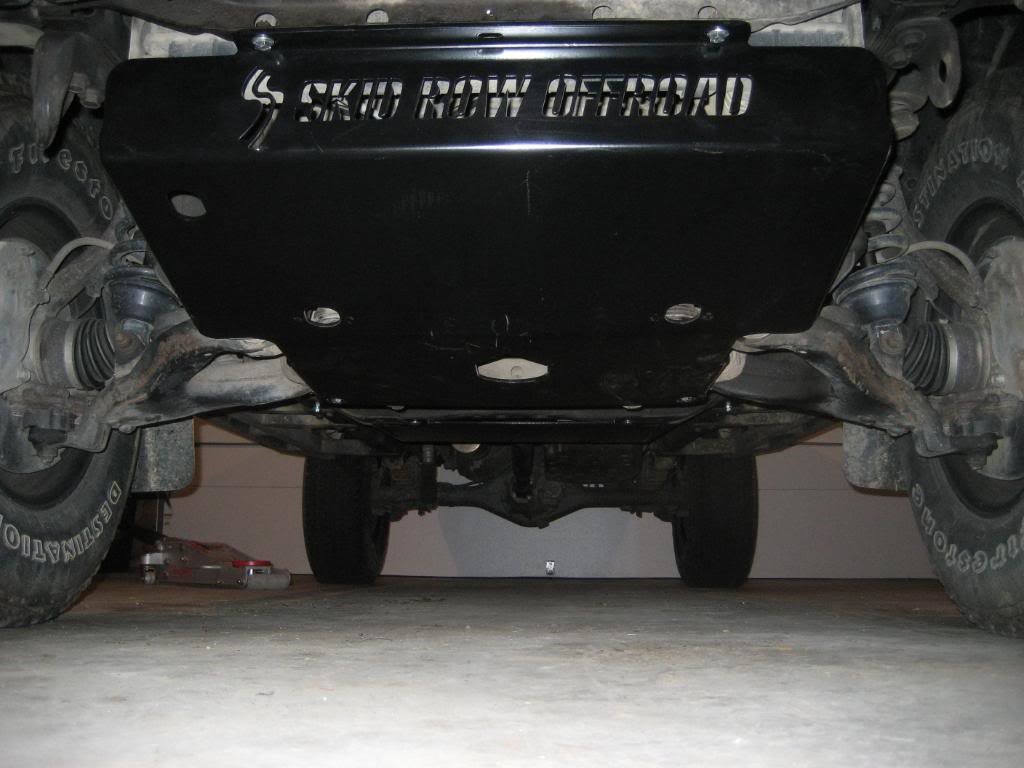

    Before my first trip to Rausch Creek I got myself some skid plates. I went with Skid Row skid plates. Mainly a Jeep shop they only make skids for 1st gen Tacomas. For a 1st gen the choices were either Budbuilt or Skid Row (I think some others may have started making them now). I preferred the stronger design of Skid Row's front skid over Budbuilts (support at the bend in the middle) and the three piece design vs. Budbuilts two piece design. I was also able to get them locally through a Jeep shop that sells Skid Row products for about the same cost as Budbuilts and they come powder coated.
    I bought just the front and transfer case skids so the front and middle of the truck were covered thinking I wouldn't be getting myself into anything bad enough to need to cover the gap in between. Well the last trip to Rausch Creek proved that theory wrong as the crossmember there has a nice dent in it now. I'm also not a big fan of where the front skid ends, the steering rack is a bit exposed. So I plan on getting the transmission skid at some point.
    Anyway, here's the skids when I first got them:
    After several trips to Rausch Creek I think I put the front skid to pretty good use:
