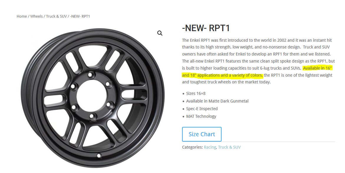

    My shit is all stock.
    I like these. Comparable wheel to what I'm running currently. I wish there was a bronze option.
    Although, it would seem that the "variety of colors" is not actually the case.

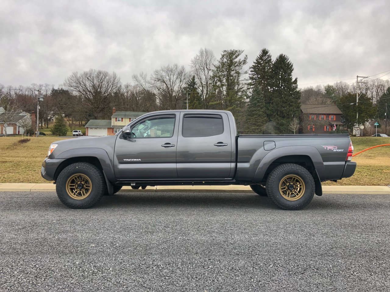

  13. Jan 25, 2019 at 10:19 AM
    #73
    thelate1
    thelate1 Well-Known Member
    Oct 8, 2018
    #268740
    195
    PA
    2013 DCLB Sport 4x4
    Here they are. They’re actually way more bronze than they appear in pictures. I love em though!

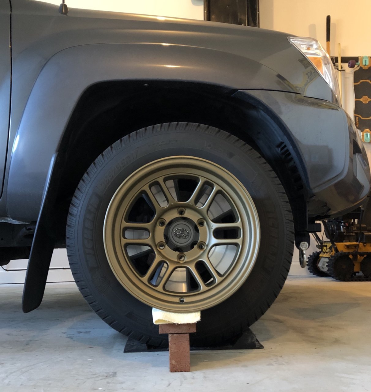

  14. Feb 10, 2019 at 3:30 PM
    #74
    thelate1
    Oct 8, 2018
    #268740
    195
    PA
    2013 DCLB Sport 4x4
