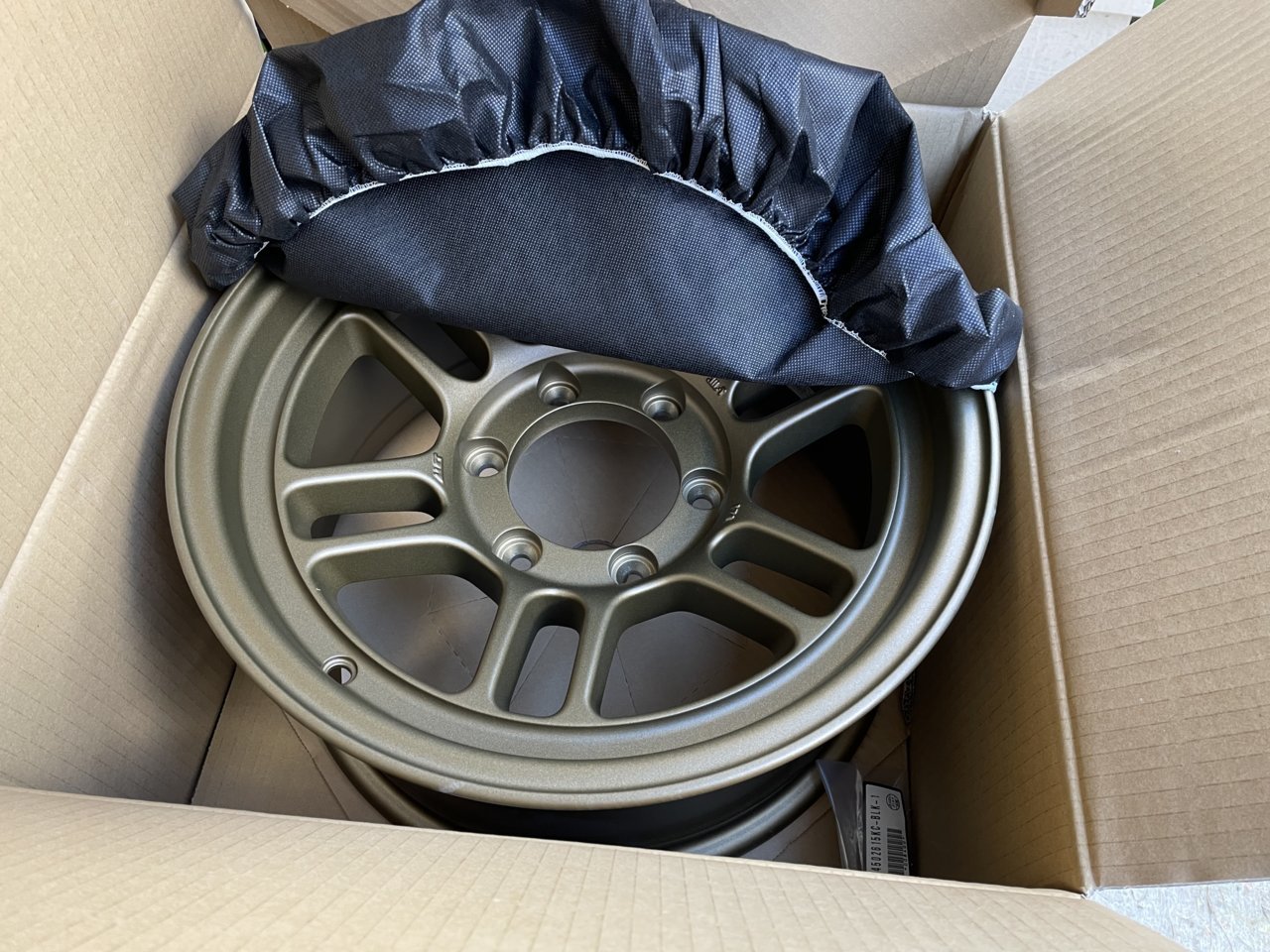

    Wheels arrived yesterday and I have an appointment to get them mounted with new rubber on Monday. I just remembered to check the bore size on the box and sure enough it’s 110.5 and not 108.5. So I quickly ordered 106 to 110 rings and they should be here tomorrow.

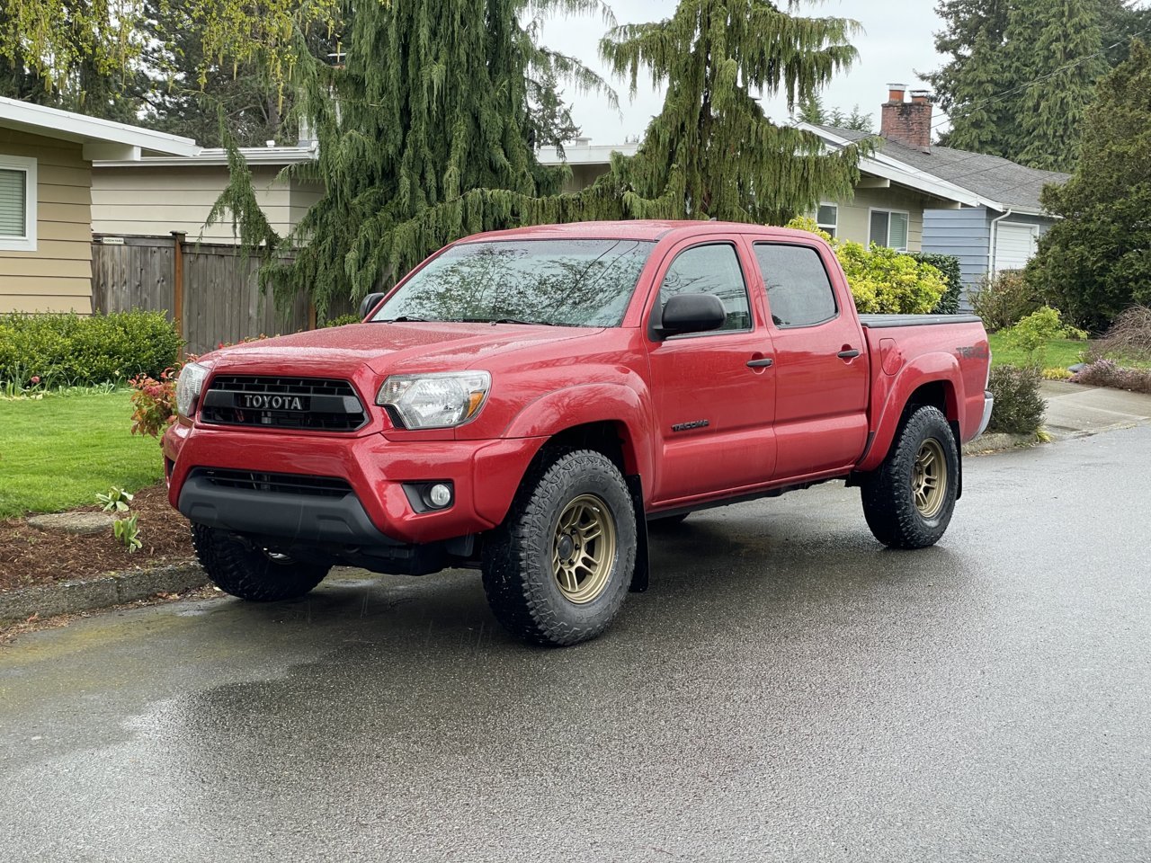

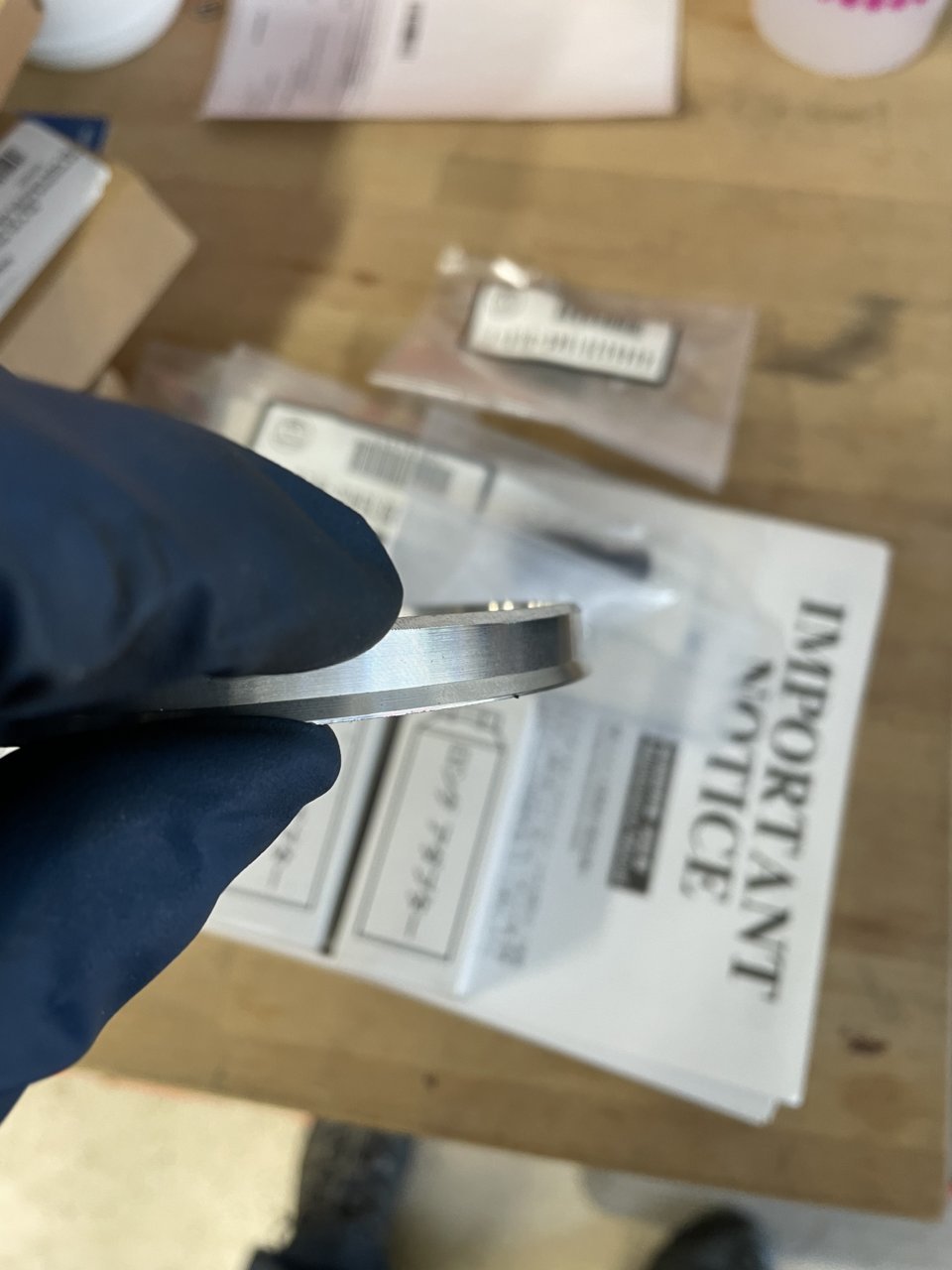

    Got my wheels on! A bit of an adventure getting there. Got my 110-106 rings on Sunday but when I went to test fit them they didn’t sit flush in the wheel (over 1 mm above the mating surface). The center bore on my wheels narrows from 110.5 to roughly 108.5 at a depth of 8.7 mm and my rings were 10 mm. I ended up filing down the outer corner of the rings until they sat flush.
    That worked well and I got them mounted yesterday with new 265/75r16 ultraterrains. Love them!
