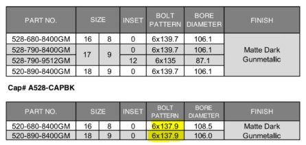

    The bore from non cap version seems incorrect to me

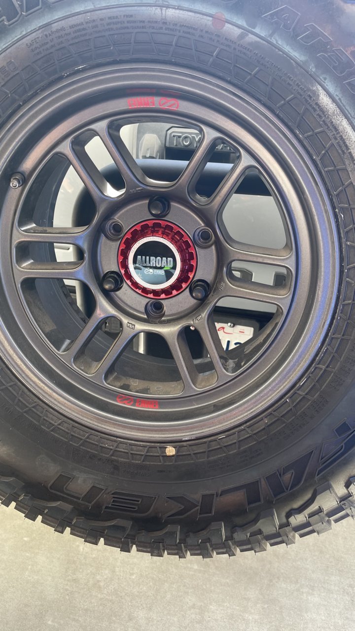

    Enkei Allroad RPT1 center caps. 106mm bore so I had to use push-thru center caps and epoxy these in to fit. My enkei's are the Og 108.6mm bore.

    Nice.. mine are also the ogs with 108.5 bore :D

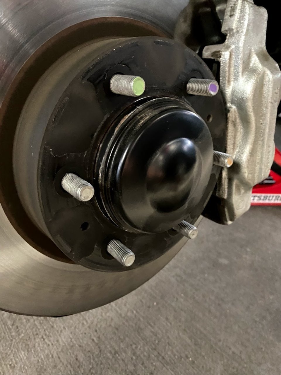

    I made the mistake of buying my wheels before I read this entire thread, and I think I'm in a bit of a bind.
    I got the 16x8 106.1mm bore, thinking that since they were the same size as the stock rims, they would work, but on further inspection, I understand the issue with fitment people are talking about: the hub has a metal cover that pushes too deep into the wheel (see photo).
    Without that, the actual 106.1mm part of the hub only extends ~10mm, while the inside of the wheel has ~12.5mm of room, so it should fit without that black cap.
    My question is: is that cap essential for some reason, or is it just a dust/water cover? Is it possible to remove and replace with something else (e.g. one that I 3D print to be flush)? Looks like from https://www.tacomaworld.com/threads/wheel-hub-dust-cap-damaged-required.574082/ it seems "strongly recommended", but not essential to the proper functioning of the hub.
    Otherwise, is the best option to get spacers to avoid that cap, or just return the wheels (paying for shipping and the restocking fee) and get the ones with a 108.5mm bore?

    Thats a bummer; I am about to place an order for 16x8's. What is the Enkei part number for the wheels you have?
    The dust cover in your photo covers the axle nut and hub bearing seal, you are probably fine 3d printing a cap for it.

    it's totally fine without the center caps...my FN wheels have been cap-less for 75k miles and haven't had a single problem. Been through mud/water/dust...never a problem.
    Have you ever tried to remove that factory cap? It's on there REALLY good...takes quite the effort to remove it. Doubt any water or dirt is getting past it.

    Yep, that's the PN I have. I was curious if the 2WD didn't have the covers (if it's an OR/PRO thing?), so maybe?
    Good to know; I've seen some other threads asking how to take it off and the answer seems to pry really hard (and usually destroy it...). I doubt something I 3D print will be quite as good of a seal (though I've been thinking of adding a bead of RTV or similar to seal), but sounds like it's probably good enough!
