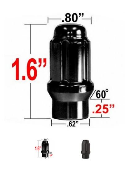

    Here is the Gorilla ET lug. There is no way these will work b/c the diameter of the lug hole in the Enkei is 0.51"

    The hole size is the main concern. There isn't much clearance on these wheels.

    I figured you guys were just blasting the nuts on without them seating properly. LOL!

    Where did you find the info on the wheels?

    I just measured one with my calipers. I had removed one trying to measure for some hub rings. Trying to determine if it is the slight bore mismatch of my KO2s that are causing some vibrations.

    DAmmit youre gonna make me take one of these wheels off and double check that it fits :annoyed:

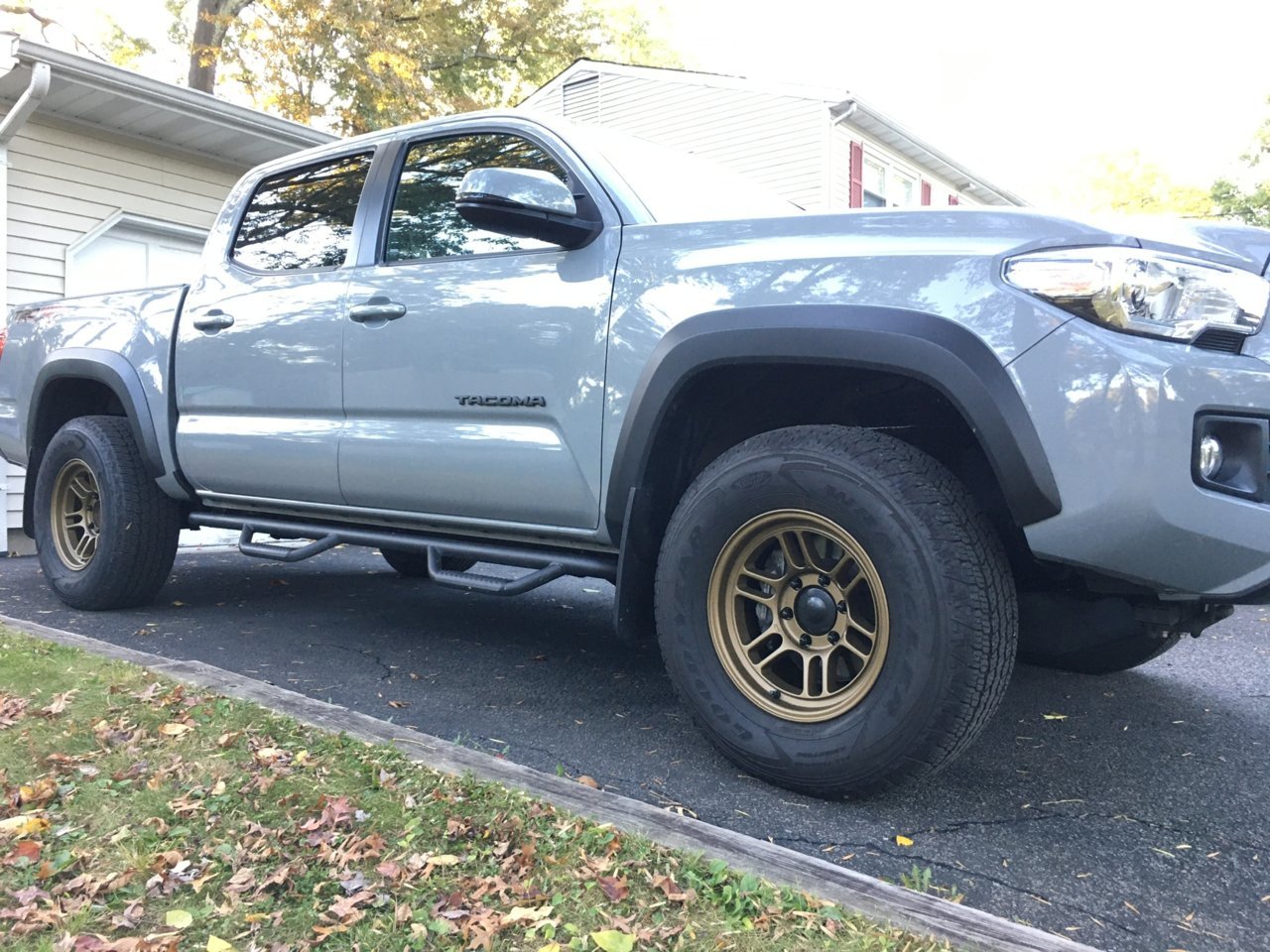

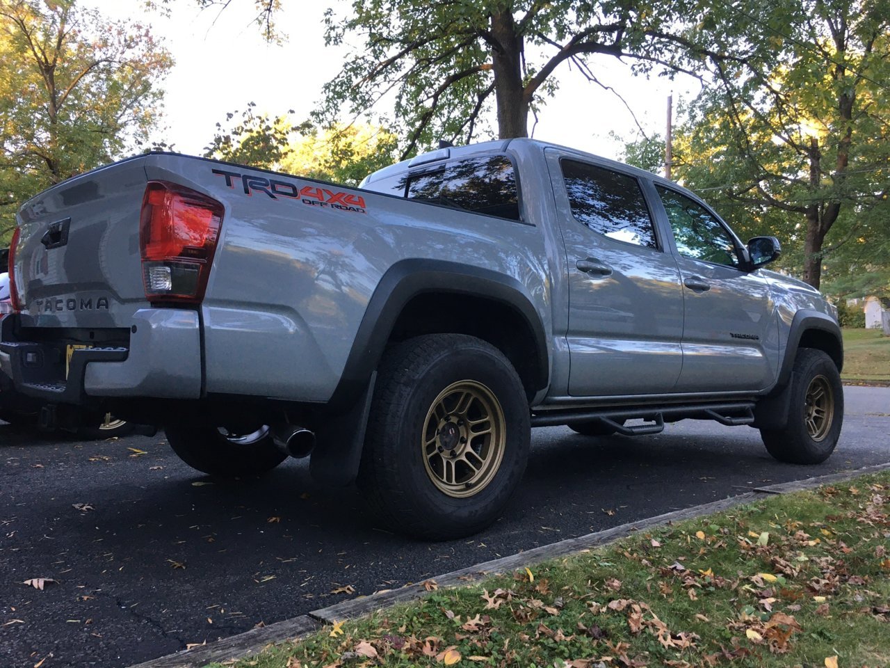

    Put these on last night. 71ABA2C0-07C5-45F5-9896-91155E4CDA6E.jpg46A12966-7CF4-4817-AE9C-EE8B26B52A95.jpg

    Anyone know of any centercaps that fit these wheels?

    Enkei ALLROAD are the correct caps but never seen them in person.
    Looks good without caps to me.

    It just feels so unfinished to me without. Especially the rear wheels.
