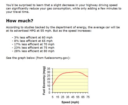

  12. Nov 20, 2018 at 9:20 AM
    #312
    hiPSI
    hiPSI [OP] Laminar Flow
    May 21, 2017
    #219544
    12,127
    South Carolina
    2024 Long Tundra
    I have driven several hundred miles at 75-80 mph. Enough that I know it gets around 15-16 mpg at that speed. I typically drive 70-75 and get around 19-20 mpg.
    Here ya go and this works with adding a load too, although it is not quite as dramatic.
    NMTrailRider[QUOTED] likes this.

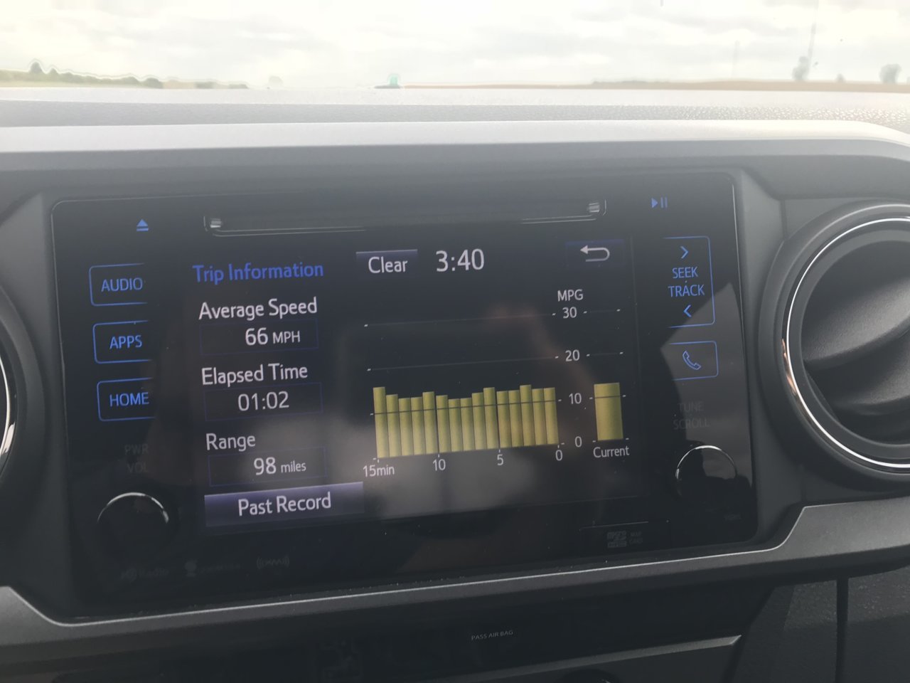

  14. Nov 20, 2018 at 11:20 AM
    #314
    NMTrailRider
    NMTrailRider Well-Known Member
    Sep 28, 2009
    #23469
    5,292
    New Mexico
    This was one of my last trips with the truck on the interstate. This is what it looked like for 3 hours.
    shakerhood and hiPSI[OP] like this.
