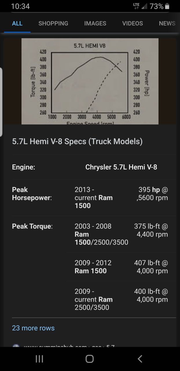

    I dont need to rev it to the moon at all to get the power. I shift 2300-2500 normal driving. All engines make peak tq and hp at high rpm, 3.5.is not an exception. For example, look at how high in the rpm range 4.8 vortec's peak hp and tq is achieved. Pretty much same rpms as 3.5. Completely disagree that most truck engines are designed the opposite. Doesels, yes. My 4.0 ranger made peak tq at 4200 and peak hp at 5000, strange right.
    Look up v8 engines peak hp and torque and you will see.
    Edit: FYI i attached numbers from a 5.7 hemi. Peak tq at 4400 rpm?! How strange.
    Guys just repeat the same shit on TW, how this 3.5 needs all that high rpm to make power. Bullshit.

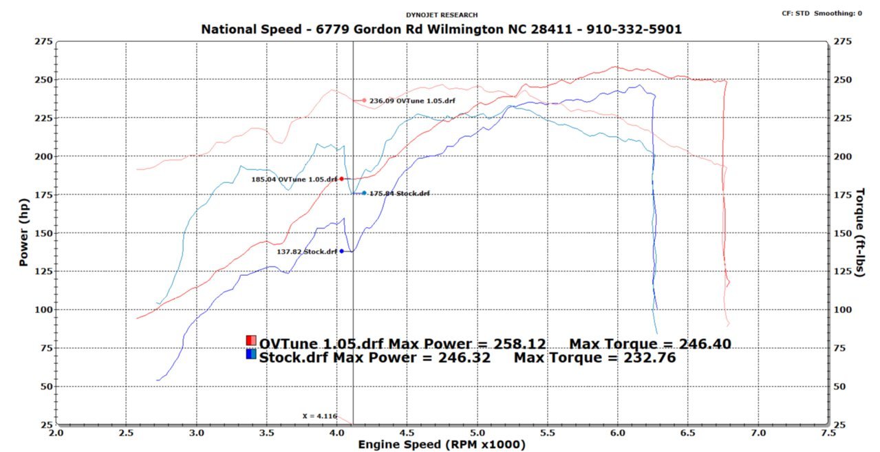

    Look at at the area below the peak. Your graph for the 5.7 has it making more tq at 1000 RPM than we make it peak. Our engine is soft on the bottom end. It doesn't make over 200 ft pounds of TQ (at the tires) until about 3700 RPM. At 3000 RPM its making a whopping 165 ft pounds. Real stump puller we got.
    It makes enough to get by but needs to be revved to make power.

    I can see it in the 5.7 graph, not sure how accurate it is though, as i pulled up the first one in google.
    Of course a v8 will make more torque down low, no question about that. Im not sure about your graph, as i have seen dyno charts from 3.5 on here and it showed it made 80% of its torque at around 2k rpm. It sure feels like it to me, Ill try to find it.
    My work van with 4.8 vortec operates 150-200 rpm less than my taco on the same roads with normal driving. If you want that chevy to go fast, you have to let it sing, just like the taco. Thats why i find it a bit funny when guys say that they need to wind up the 3.5 to go fast. Well no shit, you need to get the rpms up of the v8 engine to go fast too. Maybe not as much, but still.
    I mean v6s in pick ups are not known to be super torquey down low, but imo the 3.5 in the taco has enough. Maybe because my truck came with 4.30 rear end stock? Probably thats the reason it drives fine to me. I rarely have to go over 3k going up hills, and we have some crazy hills here, never for a second i though i need more torque to make it up those hills. I did drive buddies AT off road with 3.90 gears, and it drove just fine. Mind you, it was like a 10 min drive.
    Like i said, maybe i just have low expectations, or i just got lucky with my truck, or is it because of the 4.30 rear end stock. Maybe its all of the above.

    That graph was from OV Tune thread. I assume if they posted it was legit. Everyone has different expectations. The gearing certainly helps the manuals I'd assume to feel like they have more TQ. I came from a 3.5 ecoboost and that's probably why it was such a shock for me. I knew what I was getting into, and still like my truck, but its weak down low. I don't understand how anyone can feel different about that but again we all have different expectations and experience.
