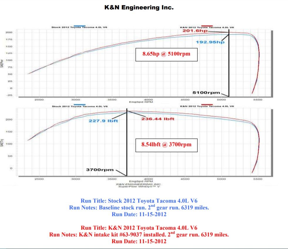

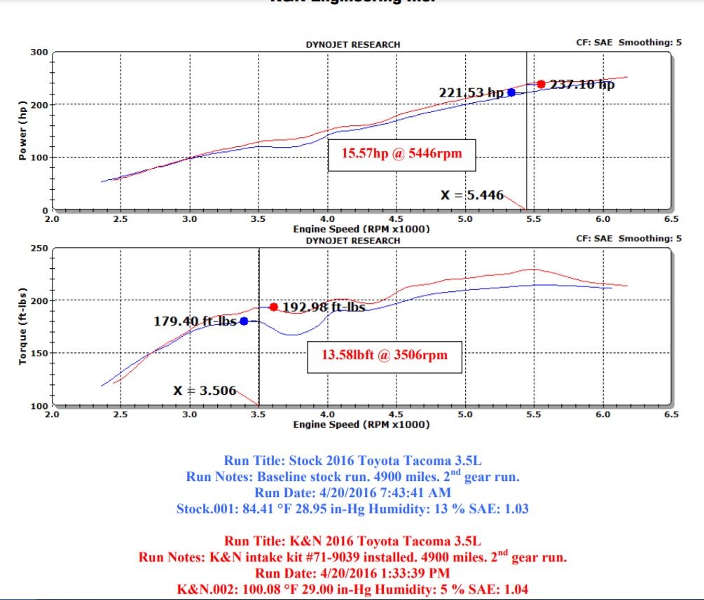

    Remembered K&N supplies dyno charts for their intake systems. As many would know, K&N is less than ideal source for real HP/TQ numbers but hopefully the tq curve shapes should give an idea of how these engines make power. Also, any dyno testing not done back to back or in a controlled environment (like a lab, not a heated garage) by a competent operator, is not comparable for actual power figures. So basically ignore the peak number, take the curves location on the x-axis with a handful of salt and so on...
    Looks like the 4.0L makes significant amount of peak tq very early in the RPM range, which matches my experience. It takes some right foot to get to that power, but if the pedal is pushed far enough it's easy to break the tires free from a stop and acceleration/passing tq feel linear and flat.
    I just test drove a 2016 last night, 42k miles and looked to be in good shape. I have read various opinions about it feeling gutless and I would have to mostly agree with that unless it's wound up near peak RPM. I felt that power would come on unevenly as RPMs rise and then a surge toward the peak RPMs before a gear shift. The graph shows that power comes on and wavers before a brief surge above 5k rpm. The dyno graph below shows a really ugly tq curve that winds up and down before the final peak tq spike around 5.5k rpm, though it holds pretty steady and flat above 4k, pretty much matching my observation exactly. Not a terrible trade off for the added MPG's, but something that will be noticeable coming from the 4.0L. I suspect that aggressive tuning for fuel efficiency and emissions is a big part of why tq is so unsteady in the lower 2/3's of the RPM band, but that is just a theory. If I am correct, some tuning could (should?) wake this engine up significantly as long as there is no hardware restricting tq production in lower rpm's but not at higher RPMs.

    It looks to be more like 1500+rpm shift and a atrocious tq curve shape to go with it. Ive seen tq delivery like that on other N/A engines. One that comes to mind is the 2.5L subaru EJ253. A tune to eliminate the CL to OL delay and some MAF calibrating made a huge difference on that engine. My somewhat ignorant theory of the 3.5L Tacoma engine, from having driven one and now seeing the tq curve shape, is that a similar tune to nail down MAF, clean up fueling and take out the O2 sensor feedback early may really give this engine some low RPM life. I should start reading the hundreds of pages in the VF tune thread.

    OV Tune will help but it can't fundamentally change the curve that much.
    It's not 1500 rpm difference lol.

    You'd be surprised, actually. No, peak torque doesn't change considerably.. but the whole area below that peak does.
    OVT allows access to power that this little V6 can produce down low.

    Just noticed your curve posted. Thanks for that! Look where the engine lives though between 2500 and 3500.

    I was using the rpm where each curve crossed 200ft/lb as a reference. Looks like about 1600+rpm delta.
