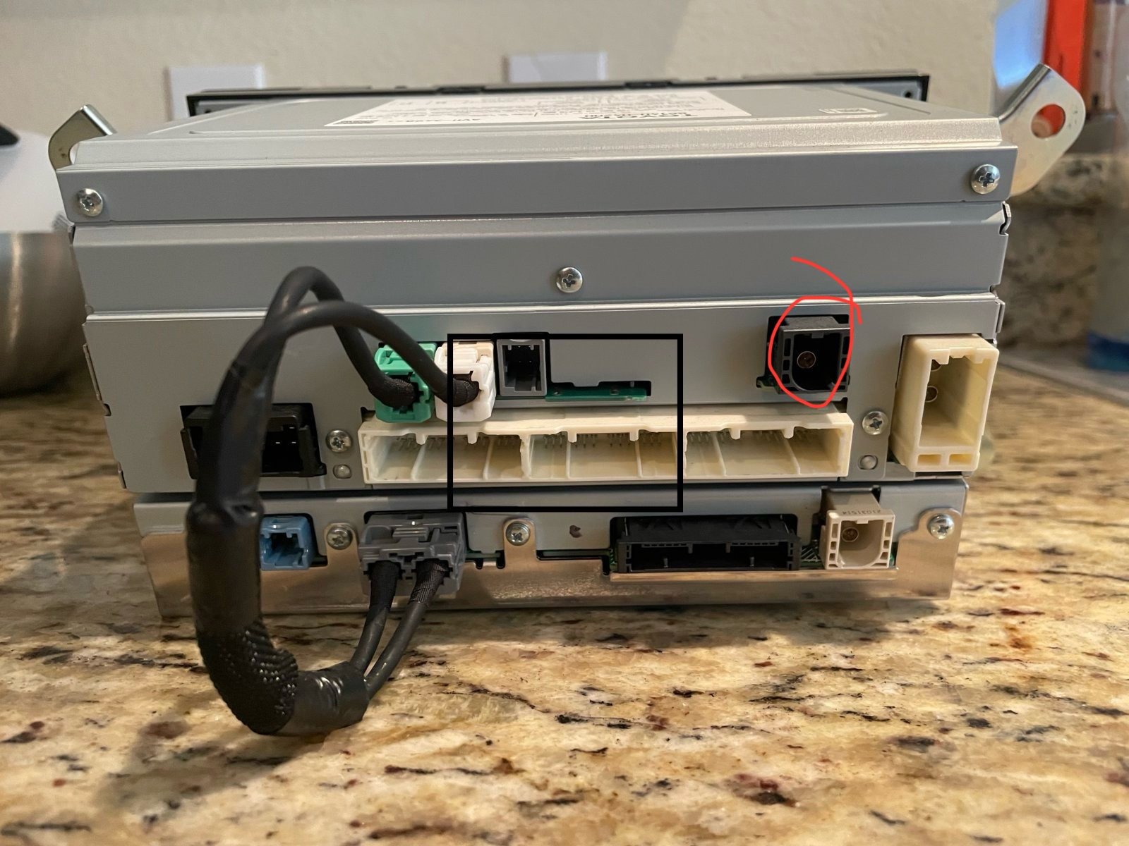

    Since I've had to reinstall the Entune 2 (long story), my radio time never set, and I didn't get a GPS signal. I thought it was going to be a problem with not having the antenna properly seated in the rear of the radio, but I pulled it out and everything is seated normally. Bringing up the diagnostic menu on the Entune 2 gave me the following message:
    B15C1 - GPS Antenna Connection Malfunction Break
    Clearing the code and retesting immediately brings it back, so it's antenna related.
    So here are a couple of questions:
    1. Could someone idenfity on the attached photo which connection is the GPS antenna? I'm under the impression that it's the blocky white port on the right of the radio, approximately 1/2 way up.

    I believe it’s this one I have circled in red
    for the wire itself, you can actually see the antenna up high inside the dash mounted on a metal plate. Just follow that wire to ensure you have the right one. I think it’s the white connector
    XM is the wire with the black connector and it should go to the black port on the bottom module
    don’t ask me why the colors are reversed
