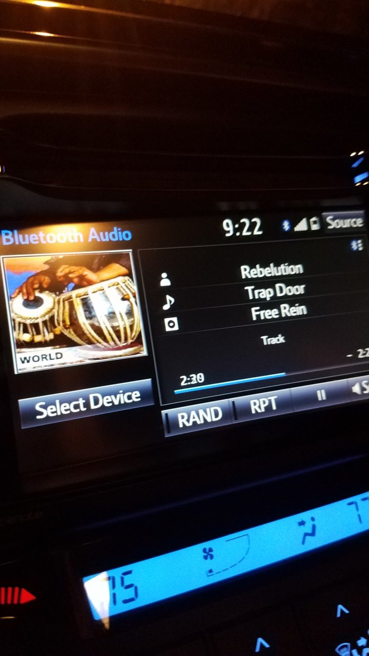

    Rebelution is an American band. :annoyed:20180625_222356.jpg

  2. Jun 26, 2018 at 6:26 AM
    #22
    MESO
    MESO Major Modder Vendor
    Feb 16, 2015
    #148809
    16,295
    State of Jefferson
    2016 DCLB TRD HELLCAT SWAP
    They are also badass in concert!
