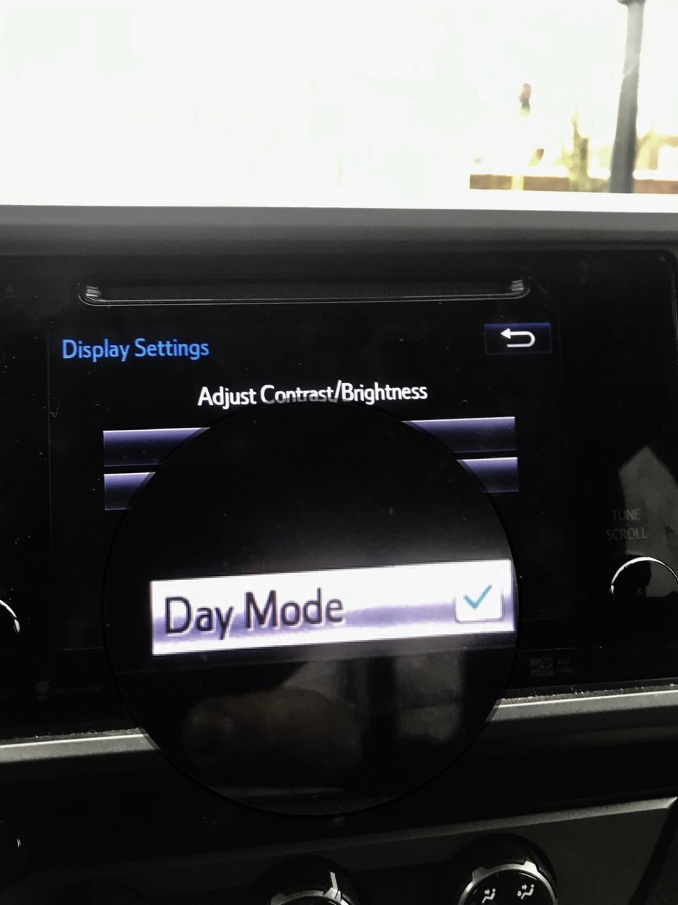

    So this has been discussed before but no solution found. On my Entune, the Buttons On left/right side (HOME, APPS, AUDIO, etc) dim with headlights. Not a big deal at night, but if raining, dusk/dawn is pretty dark and tough to see. (See picture 1)
    And before someone says anything, this is with the Instument panel brightness Maxed and “day mode” selected. (See picture 2)
    Can this be altered? With the illumination wire to the unit? Any ideas? Again, apologies if this has been solved.

    Day/Night mode is only for the display screen, side buttons adjust with instrument lighting control...
    ...what you're seeing is expected behavior.

    @TailHook I realize that. I didn’t know if there was a hack to fix it

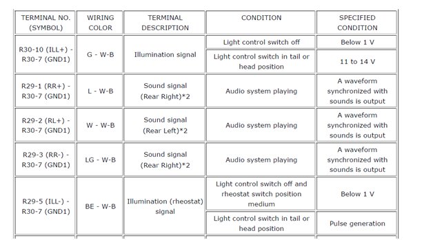

    ILL+ / ILL- is used by the radio. I have not tried this but you can disconnect them at the radio and fake ILL+ / ILL- differential < 1 V for always bright ' buttons'
