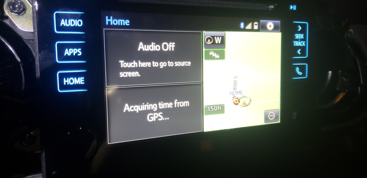

    Noticed today the clock was reading all dashes --:--
    Turns out it's in a perpetual acquiring time from gps. The unsync from nav option is grayed out. Any ideas on how to unscrew this?

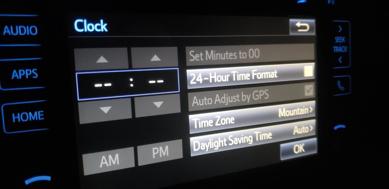

    yeah the setting to unsync with gps is greyed out. as in not able to unsync and set the clock manually.

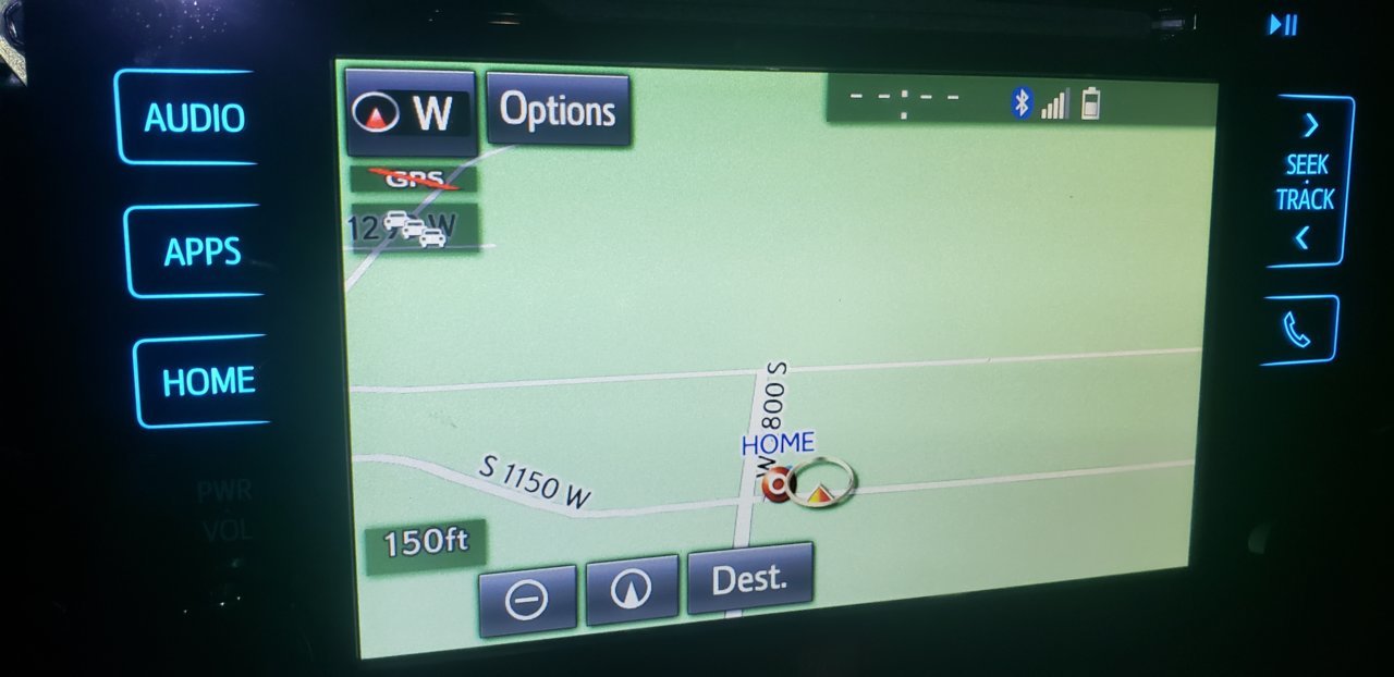

    Dealer thinks that an antenna is unplugged based on the red bar thru GPS on the nav screen. Anyone know how to full reset the system? I checked the back of the deck and it's all plugged in. He says that's why I cant unsync which is the stupidest design flaw I've ever come across.

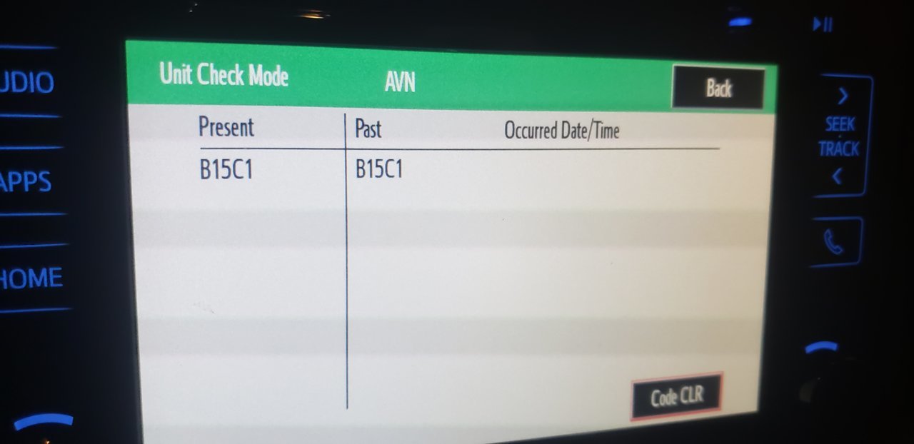

    Google says
    B15C1 = No GPS antenna connection ( Open circuit )
    Anyone know which plug on the entune is the antenna?
