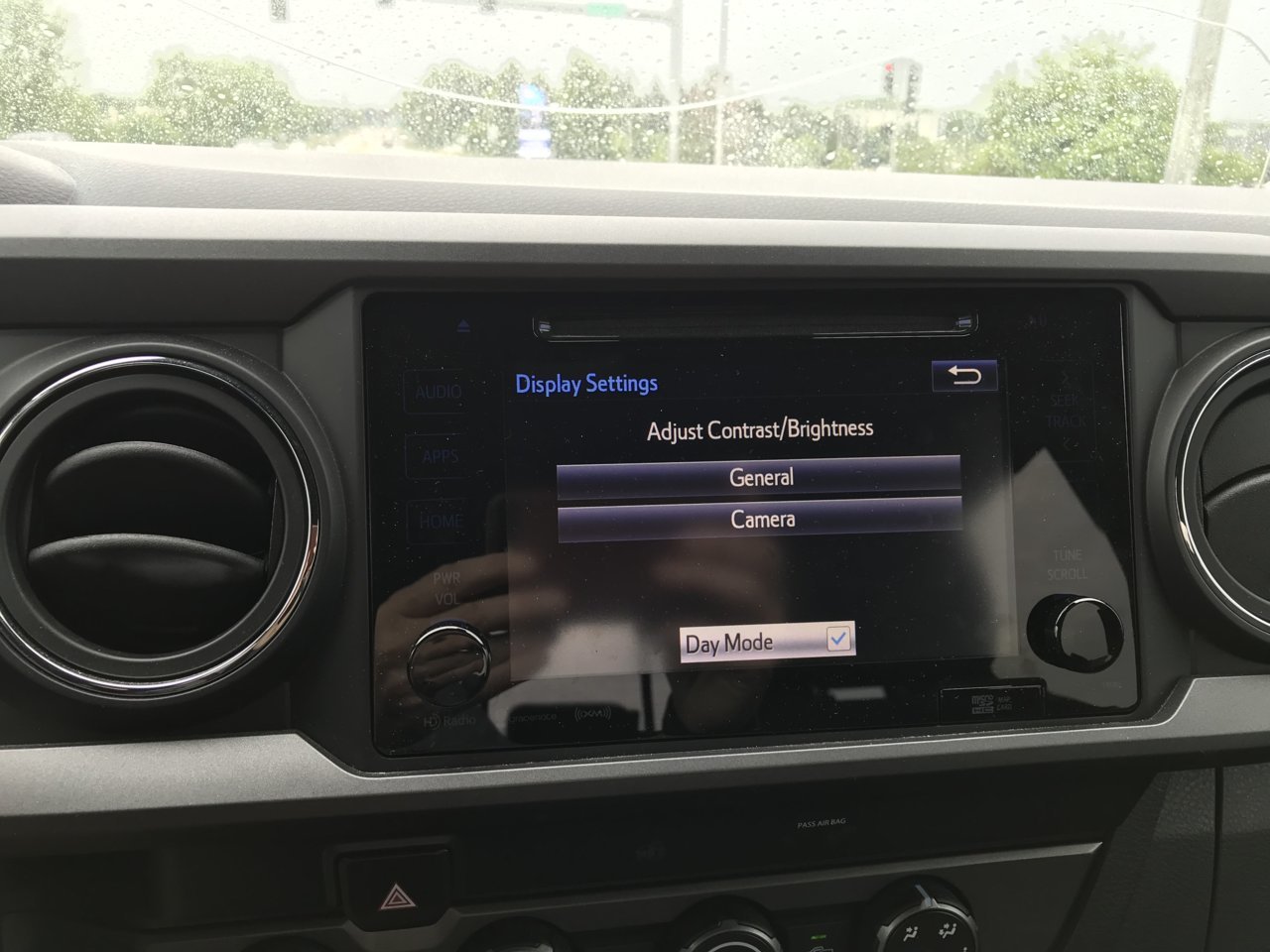

    Had to use day mode today since it was raining. Mine doesnt brighten up the buttons. Seems like it does for some people and not for others? I have a 19 OR but no auto headlights.
    Example with day mode on what buttons look like. They don’t change unless you turn the lights off.
