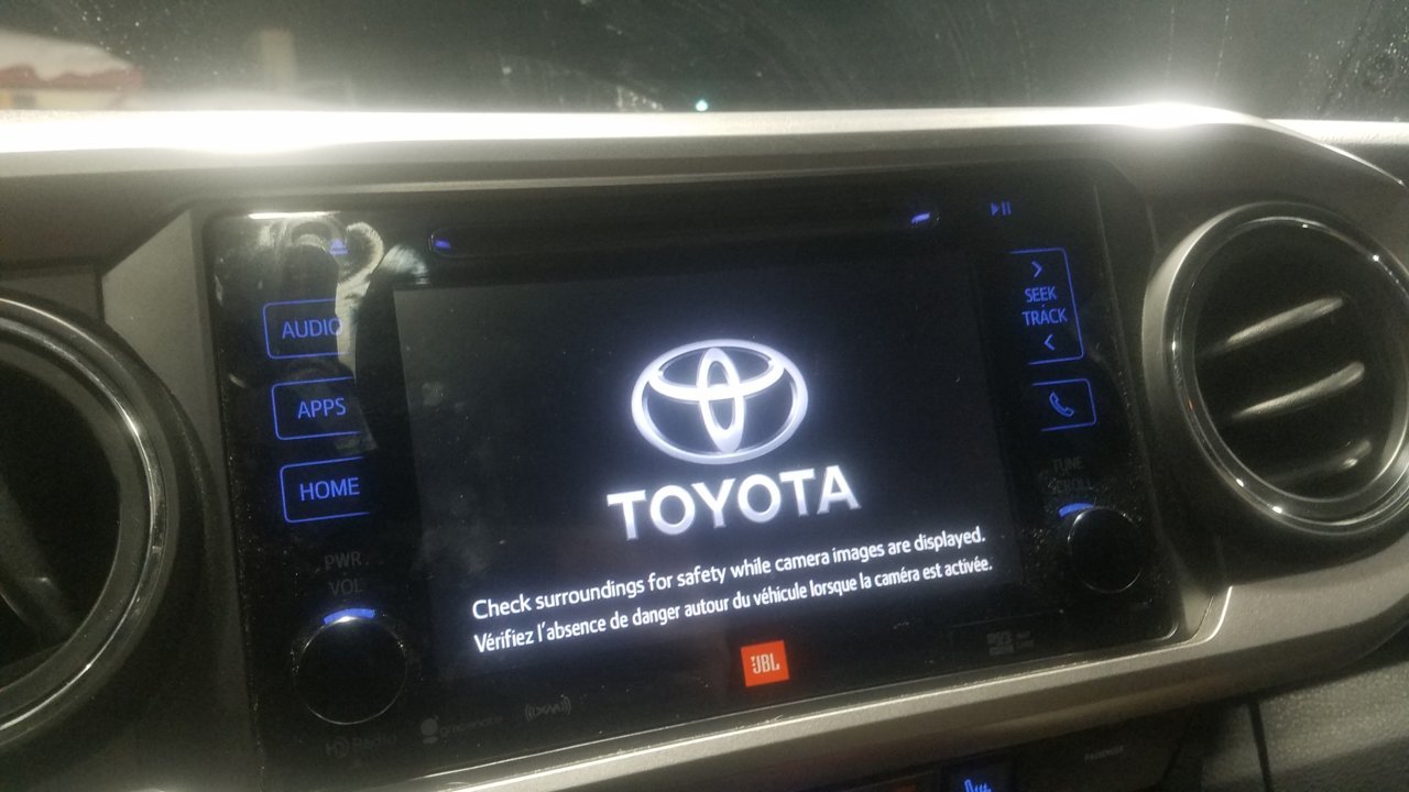

    Any one have the problem of the system completely frozen on the toyata screen? Only back up camera works. I have tried to reset. And no other buttons work, so I cant get to the update section in the settings. 2017 tacoma

    you reset by holding down the power button?
    Maybe try disconnecting the battery.

    Yes tried to pull battery, tried to hold down the volume button, I even downloaded the entune update on a jump drive and plug it in. But none of the other buttons work. :/

    Under warranty still? Take it in. Something else I'd try that shouldn't take too long would be to unplug the head unit and plug it back in. The trim piece that goes around the head unit just pulls off and there are only 4 bolts holding the head unit in. Really easy. Don't know if that would do anything but its simple enough to try.

    Tried pulling the sd card and reseating it? I don't know, just spitballin

    Lucky for me the warranty expired 17 days ago. I tried to pull it out of the dash and hook it back up and nothing. Still frozen. Uhg. I just tried to reset with and without sd card.

    I’m on my third head unit. Had constant problems with them freezing up on me. I found that when it did it, I could use my steering wheel controls and it would unfreeze it.

    Shoot, after reading all of the post on how crappy the head units are in the tacomas. and i still have not got it to work. I guess i will go with an aftermarket head-unit,
