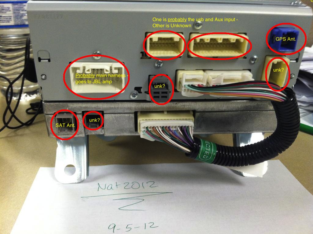

    I have never seen a "check antenna" for satellite radio. If it is indeed your satellite antenna though, that is going to be the blue connector located behind the actual entune stereo on the upper right hand side. I don't see how it could be though because those are some solid and beefy connections in the unit. Those who want to argue that I am wrong due to this picture floating around are wrong:
    I pulled apart the stereo yesterday and confirmed that the blue connector is indeed the XM antenna, there underneath a cover after you pull off over 21 screws it clearly has a label on it which says "XM."
