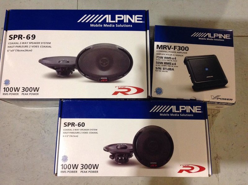

    2014 tacoma dbl cab off road
    None
    About $600 installed, but I knew someone who knew the owner of the place I used. Car toys quoted about $900. You could buy all the stuff for about $500 through ebay.

    None
