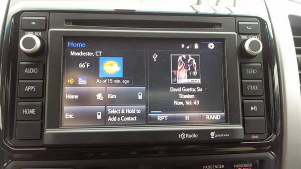

    I like the 3 panel display option allowing quick access to contact favorites, weather and audio.

    how did you do this? i am always flipping back and froth for the weather update.
    also. does anyone know how it does the current outside weather? does it have a sensor or uses weather channel info? I find its warmer outside then what it says.
