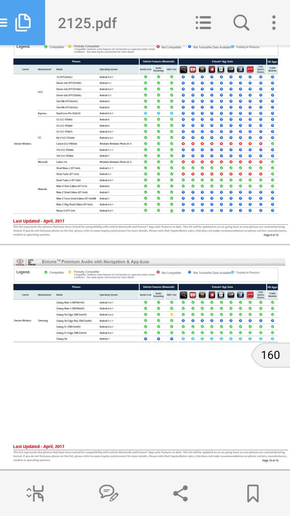

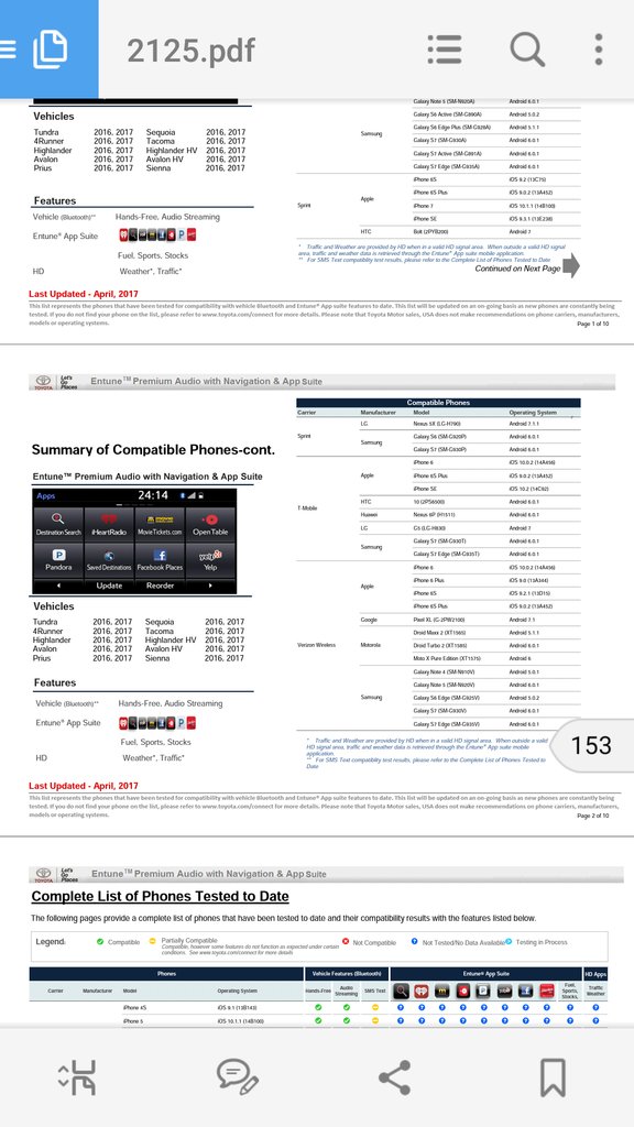

    Page 153 is my radio, scrolled down to page 160 for Verizon galaxy s7 all green checks, is that the wrong list?Screenshot_20170706-195707.jpg Screenshot_20170706-195723.jpg

    No, that looks right, you found the 2017-specific list. Mine was on the 2014-2016 list.
