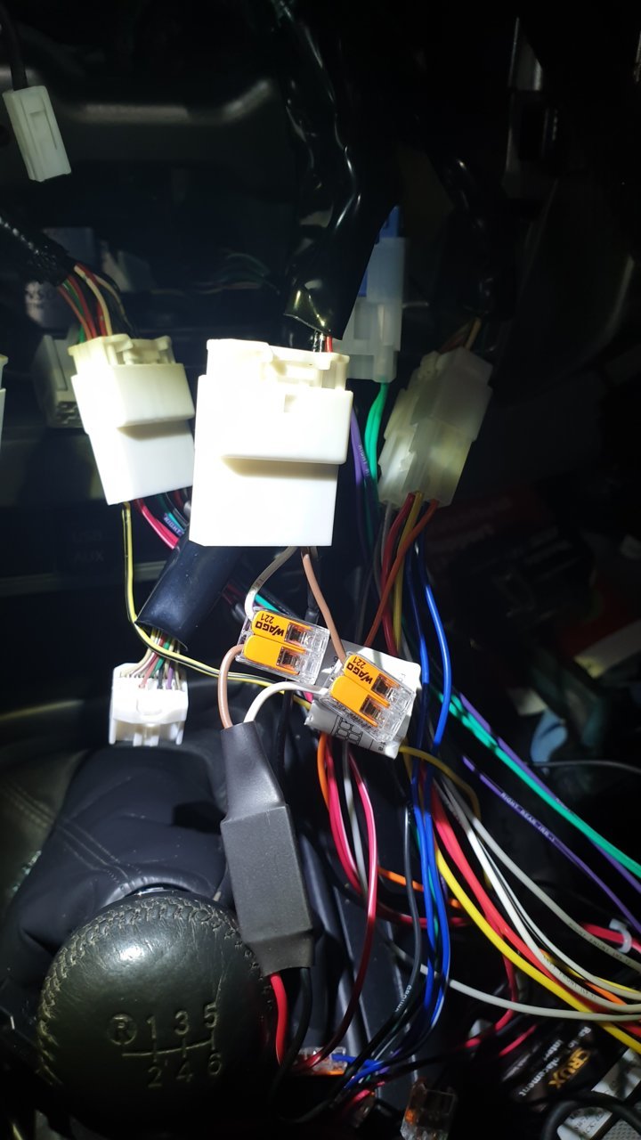

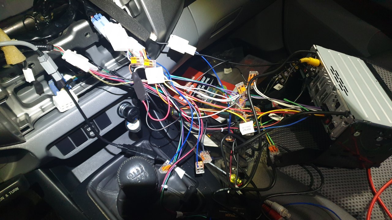

    I just installed the XAV-AX5000 in my Tacoma and it sounds light years better than the stock radio. I think perhaps you crossed some wires (positive/negative) potentially causing your sound issues. Nothing wrong with this head unit. That said, the Crux adapter for the steering wheel controls was crossed on the plug used to retain the stock backup camera. Brown and white wires were reversed so I had to snip and cross. Was getting "No Video Signal" prior to reversing the wires. You can see the cross I did below.

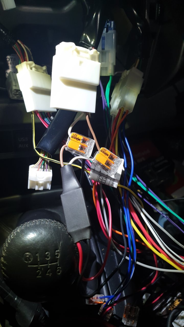

    Yes, it still works. The XAV has its own lines that it draws for the camera but I disabled them because the stock lines from the stock camera are better.
    Also, I had a helluva time getting it to work....because whomever wired the harness required to step down the voltage from 12v to like 6v or whatever the camera needs must have been drunk and it must have been a friday.....because they reversed the hot and the ground wire.
    I mistakenly decided to do this as it was getting dark...but luckily the rep from Crutchfield who answered the phone was very helpful....and also luckily for me I have and know how to use a multimeter.
    I was able to determine that the hot wire was reversed with the ground for just the wiring harness for the rear camera.
    Also luckily for me I was able to use my WAGO lever nuts to flip the wires without having to use traditional wire nuts. In case I was wrong, I would be able to reverse what I did.....but it wasn't necessary.
    Here is a pic of the wires reversed.
    Here is a pic before reinstalling the head unit.
    TRDRed likes this.
