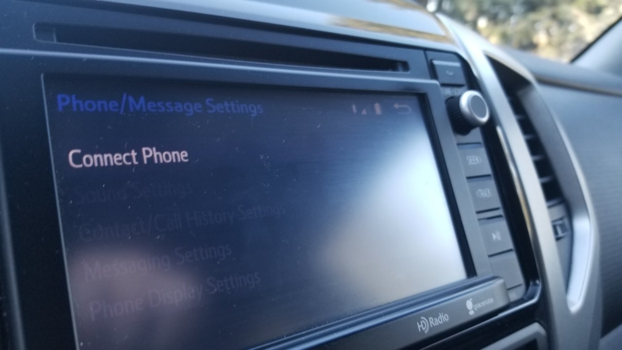

    So, I know so many people hate the entune systems which I never truly understood because mine has been fine for 2+ years. Well the good times have come to an end. I have the entune audio with the apps button but no nav in my 2014 tacoma. It's started freezing on one screen when I'm playing my Spotify through it (which is literally all I use it for pretty much). So it'll show the same song no matter what song is actually playing. Well now it's also not showing me certain settings. Like I'll go in to change a setting and all but one line will be blacked out and I can't change that setting. It happens for each of the settings but I'll attach a picture of just one so you can see what I mean. I called the stealership and asked if this is something covered under warranty (diagnostic and whatever they need to do to fix it). They said "I don't know" and then wanted to charge me $152 for a diagnostic fee that WOULD NOT be covered if they decided this was a warranty issue. I'm at 68,400 miles btw. So yea not going there. Anyone have similar issues? Know what to do?
    Thanks!
    Oh and the picture I chose is phone settings as you can see and my phone was connected so that wasn't the issue.

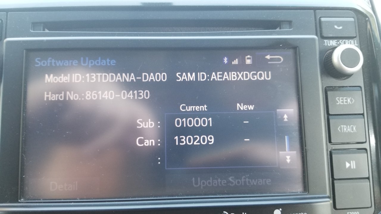

    They told me they updated it but I'm not sure if that means the firmware or not... Where would I look at on my entune to find the firmware version? And then where would I look at online to see if it's the updated one? Other than this website? https://securedp.toyota.com/download-app/downloads

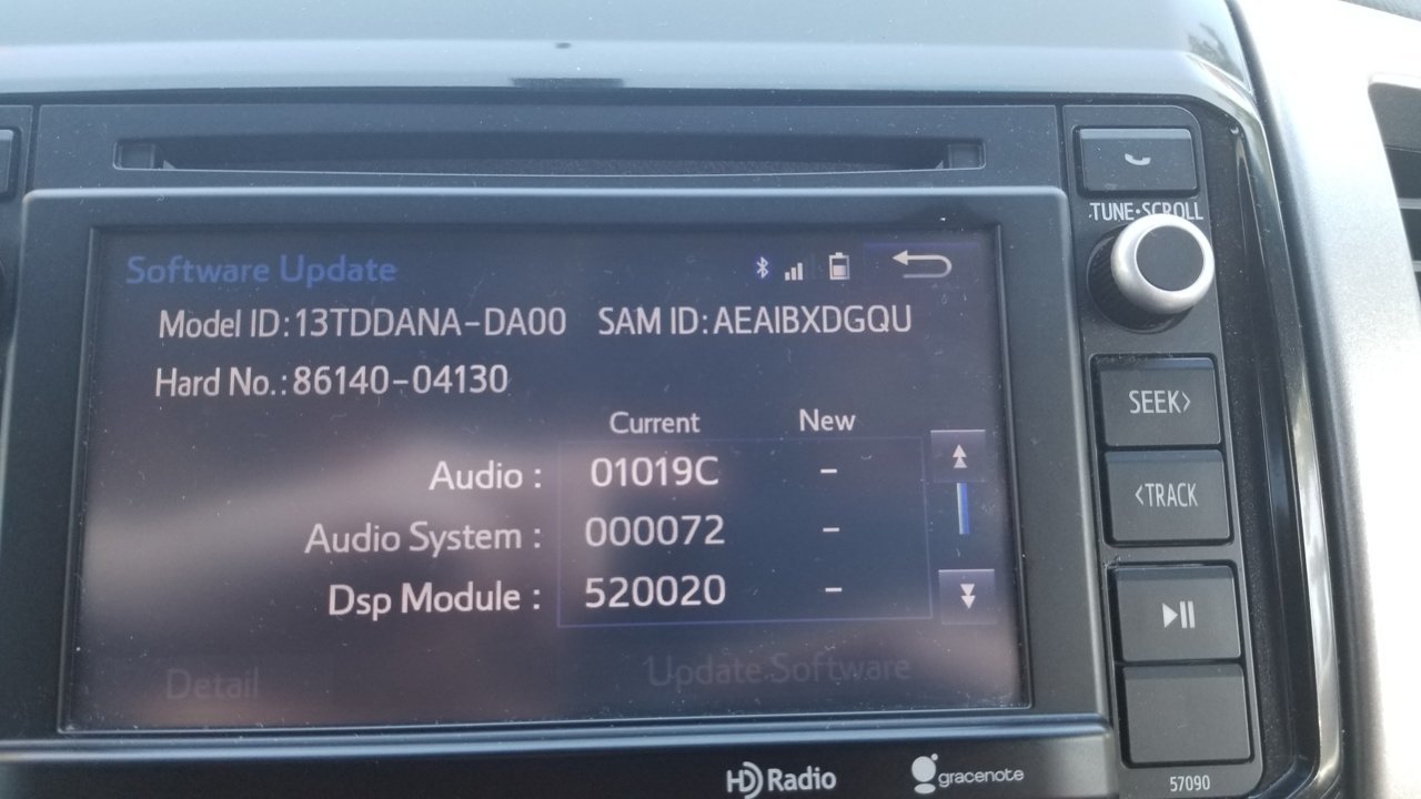

    My entune says last updated 04/2017 which is when it was at the dealership to get it looked at. Here's the software info

    Go to Toyota.com and look for the owner sign-in section. Look for the Entune update and compare that number to the numbers displayed on your unit. One of those should match if you have the latest update. It sounds like you do since the dealer performed the update but it can’t hurt to double check.

    Thank you. It seems like I already have the most updated version for the entune without nav. There is an update for entunes with nav for 2014 tacomas that says is supposed to improve intermittent display freezing which is what's happening with me... Ugh. I wish there was an update for the one without nav
