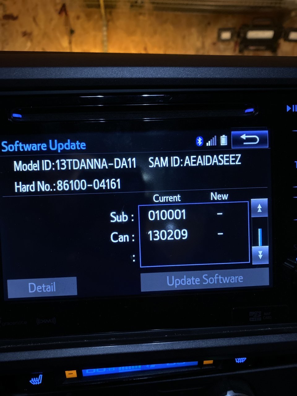

    You need to update the headunit

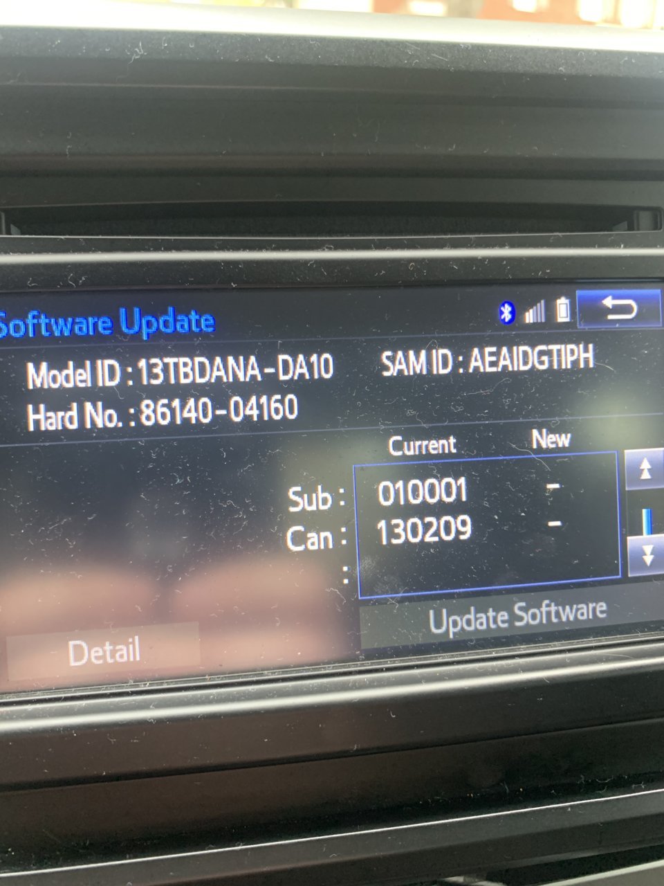

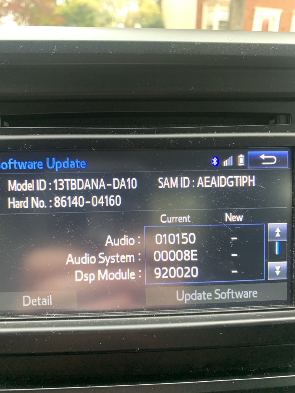

    Hey, @Shellshock .
    That is the Entune Premium with Navi. The OP has what Toyota calls the Base Audio. Model ID 13TBDANA-DA10.

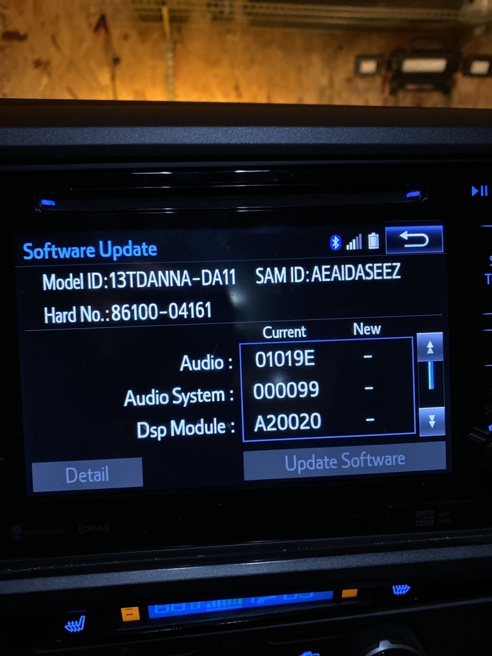

  17. Nov 7, 2019 at 7:53 AM
    #17
    tonered
    tonered bartheloni
    Sep 25, 2017
    #231055
    31,267
    tony
    Lynnwood, WA
    No. There are different FW files for each of the Model IDs. You can only install the one that matches. The Download website will sort that out for you, but if you happen to have a stash of FW, you need to pick the right one. The nice part is that it will not load if it is not the right Model ID or the same or older version.
    I'm PM'ed him the latest version that I have. You and I are on the latest version for 13TDANNA-DA11 that we were squawking about back in August.

  20. Nov 7, 2019 at 8:00 AM
    #20
    tonered
    tonered bartheloni
    Sep 25, 2017
    #231055
    31,267
    tony
    Lynnwood, WA
    :hattip:
    Sadly, the Download website doesn't show the Model IDs and the FW dump that we have doesn't give the Audio Version. LoL! It's never easy other than just test driving it.
