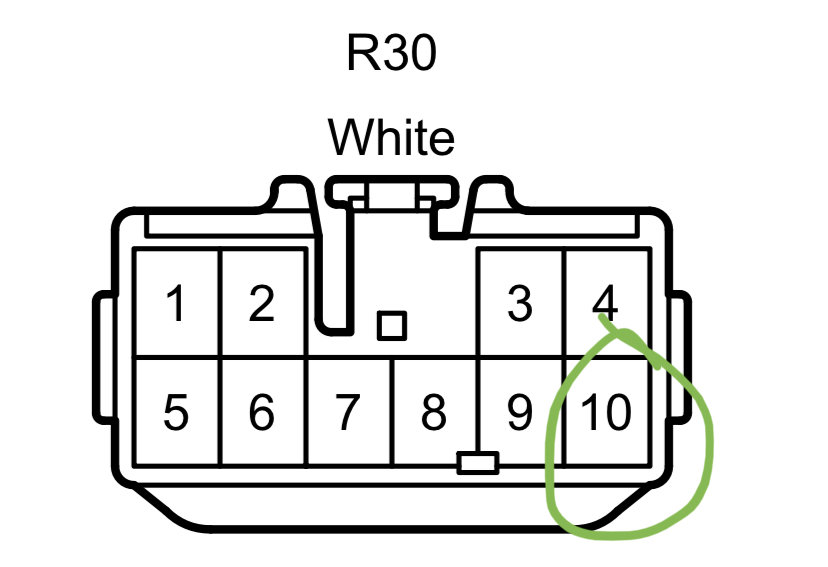

    Does anyone know of a way to disable the dimming of the Entune screen when the headlights are turned on. I've done the Full-Time Backup Camera mod, and when I turn the headlights on during the daytime (like when it is raining) I would like to keep the screen at full brightness.

    Cut the wire lol. But then it will never be dim, which sucks when it’s actually dark outside.
    I’ve installed a toggle switch before but it involves some cutting and splicing behind the radio

    Which wire?

    Green wire, pin 10
