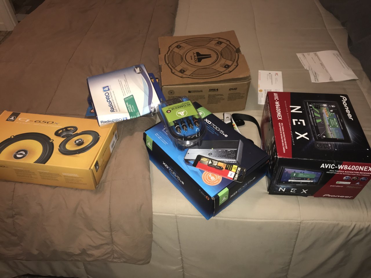

    Entune is garbage period. Toyota needs to address in the future. I upgraded my head unit

    Details? What did you replace it with? Pics?

    Still work in progress but the head unit is a pioneer avic w8400nex. DB6C4B85-DE00-4D3A-9923-A40E804D5D77.jpg
