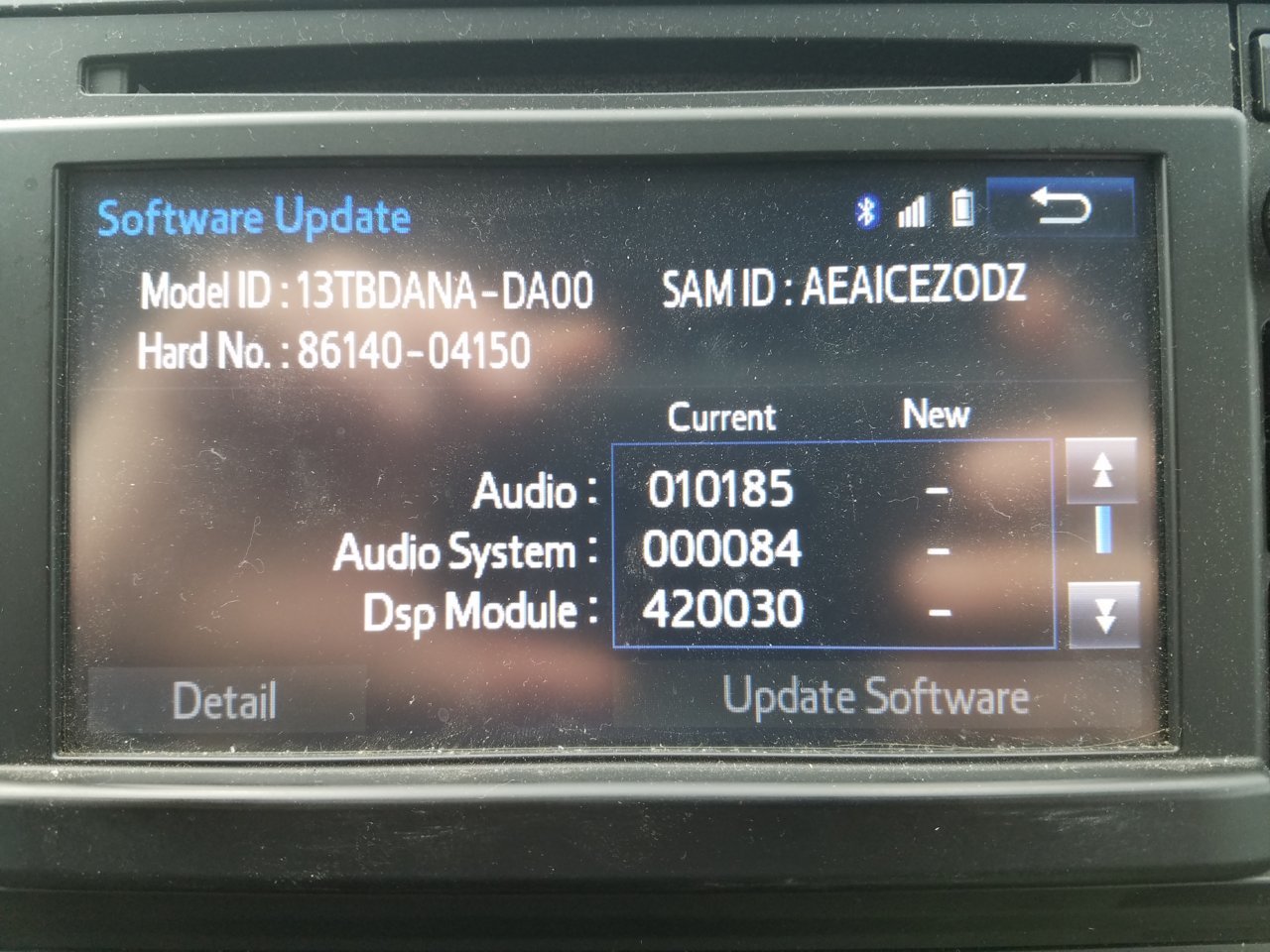

    Sorry that this is a little old, but Toyota just called me back... finally.
    They said there is no update for my model year? If my warranty is up, I have to go to a dealer and pay for a "diagnostic check" so they can tell me I have a know issue. Then if available I have to pay for a service that is free for other models???
    F them. I'll cut it out of the dash.
    I didnt ask for this crap radio.

    Post your current software version and I'll take a look

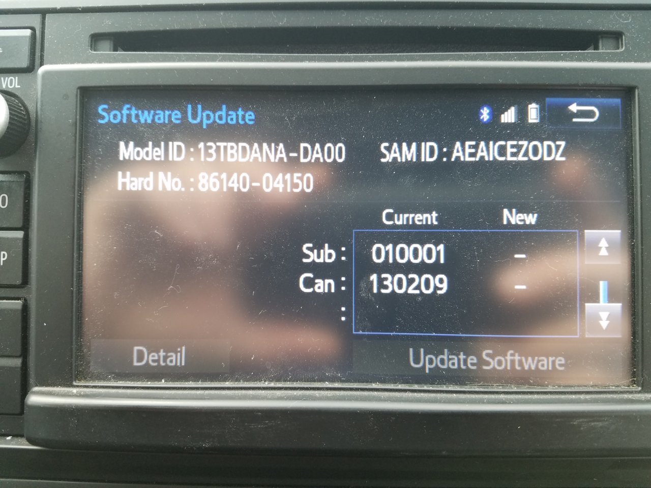

    Yeah... I tend go go from 0-60. Probably wont start cutting stuff out.

    There is indeed a update for it just need to find a way to get it too you.
    13TDANNA-DA00_0215.kwi is the file name if you can search it somewhere files 160mb
