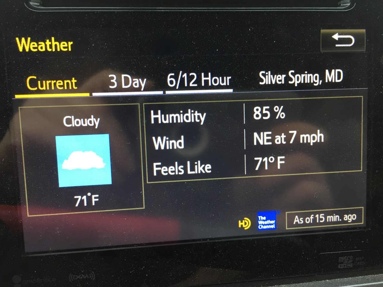

    So, I just checked mine (2017 Off Road) and it works without difficulty. I got the update “push” in the past two weeks. If you use the voice interface, press the steering wheel button and say “show weather forecast” and you should get this (after starting, wait 5 min for data load):
    Please note the “HD Weather Channel” icon in the bottom right of the above screen. As far as I know, that’s the source data. If it’s not there, something’s not right. I’d be interested to see if others on this thread have the same source? This is air broadcast BTW, no phone interface required.

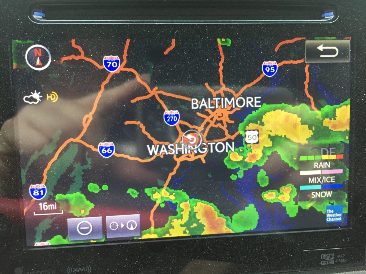

    You can also say “show Doppler weather map” and you should get this:

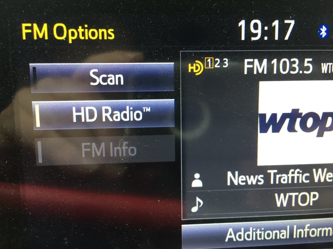

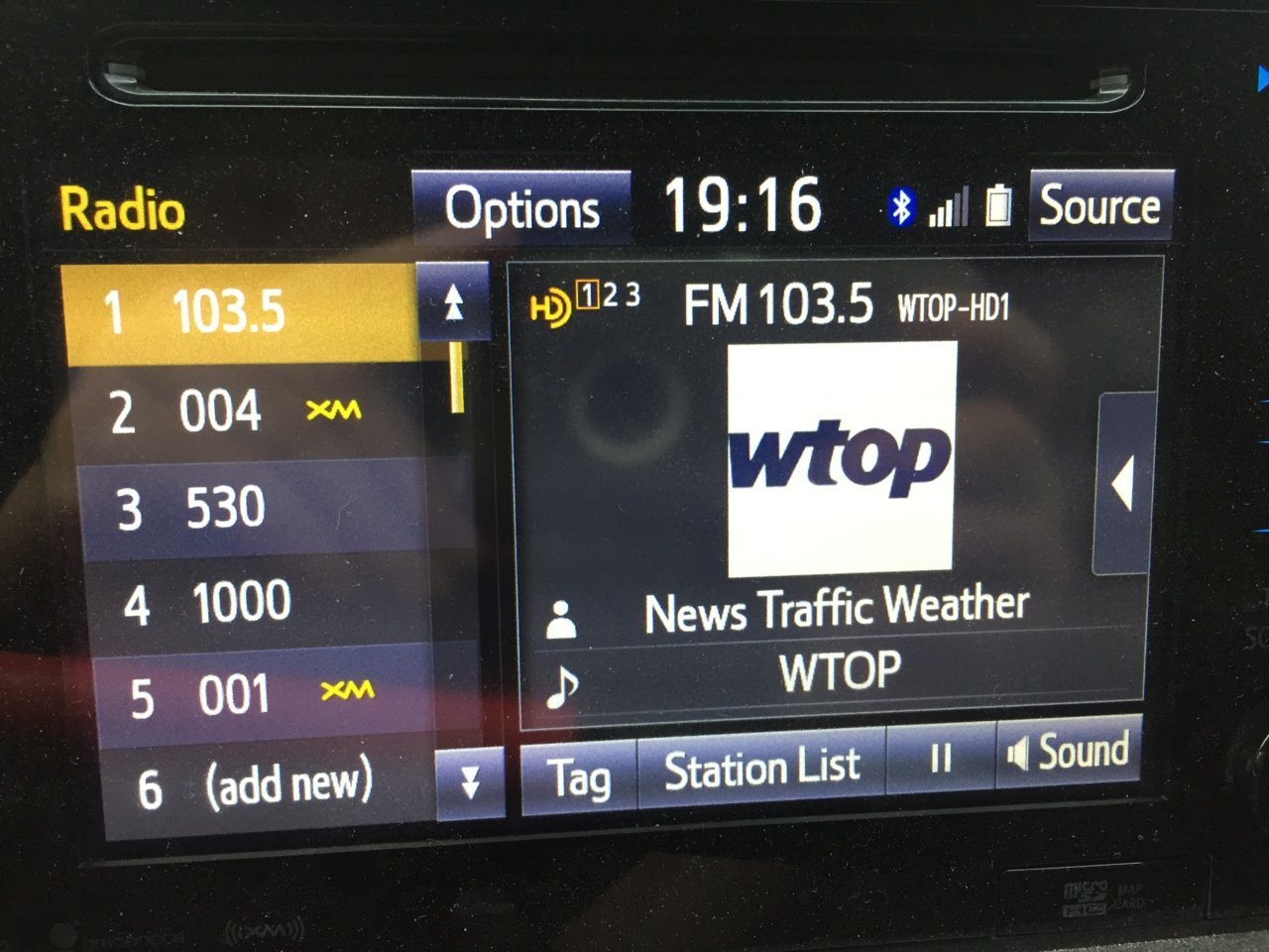

    If you go to the audio apps screen, then select FM, an FM station should pop up. The app should show if it’s an HD broadcast (note the “options” button on the top). This is WTOP in DC:
    Note the “HD” icon at the top left. If you push “options,” you should see this:
    Note that “HD” is active. That means HD is working correctly.
    So, I’d troubleshoot like this: (1) check for an HD weather icon on the forecast (also accessible by going to APPS then WEATHER then CURRENT WEATHER). If that won’t load, then (2) check the FM source for HD signal. If you have a GOOD signal, and FM is playing in HD, one of two things are likely the problem. Either the weather source data has dropped off HD broadcast, or there is a bug in the software.
