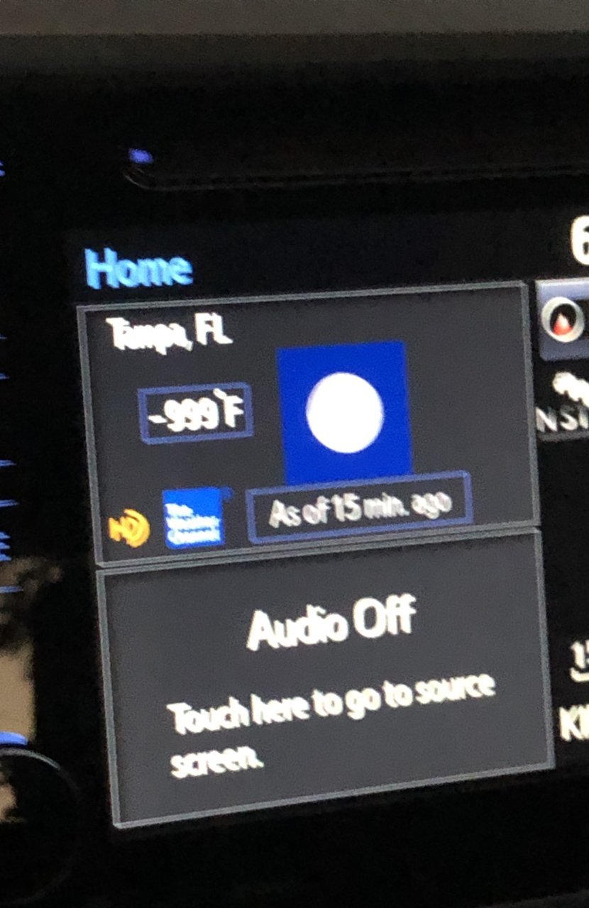

    19 Sport
    I think my Entune weather app is a little off this morning. There is a mismatch between the real temp and Entune.
    lpglarry likes this.

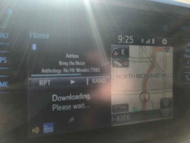

    Dallas area as well and having same problem. Dallas, Richardson, Flower Mound, Grapevine, Irving, etc...always picked up weather signal on commute to/from work. Now it just keeps "downloading". Any solutions yet?
    Thanks

    Stopped by Toyota of Dallas. Tech said he had not heard of any issues with Entune. Recommended I check if Entune app on phone was up to date, along with phone ios, if both up to date then delete the app. I mentioned I had it using HD only to pull data so phone would not be an issue. Then he said it would have to go to a tech and would take an hour.

    Same here. I commute from TMS to DFW INTL daily and after I got back from Colorado a couple of weeks ago the weather app says downloading. Weather updated the entire trip to western Colorado and back without an issue.
