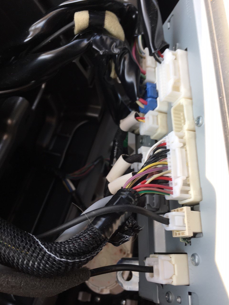

    @destin_meeks What does touching the two battery terminals together do? Just curious. I've pulled my head unit and no dice. This might be a last-ditch attempt but I'm leery of what this does. Thanks for any elaboration.

    Discharges the electrical charge being held anywhere in the circuit.
    OP, your issue isn’t a radio, it’s the software in the radio. That’s why they don’t have an answer for what happened. Software failure isn’t really quantifiable.

    it drains any remaining power from any capacitors to to get as close to a “reset” as you can get. Give it a shot, but don’t expect a miracle

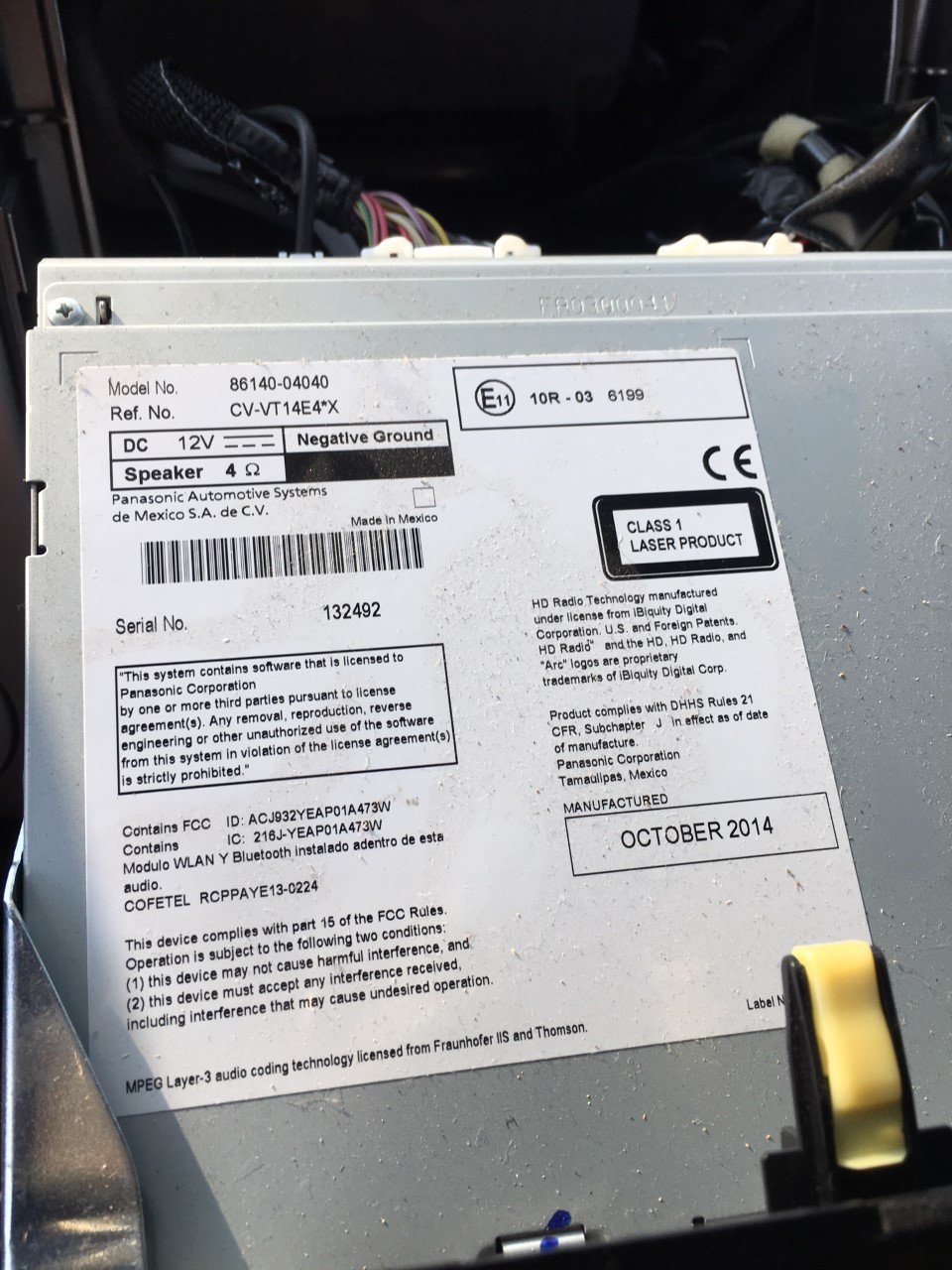

    Thank you all for your help, through some miracle or the warm October weather, I was able to get my screen working again.
    Question for next time, does anyone know if this is a nav or non-nav unit? I appreciate any guidance on this. This truck is three weeks old to me and the head unit has been out for one of those weeks...
