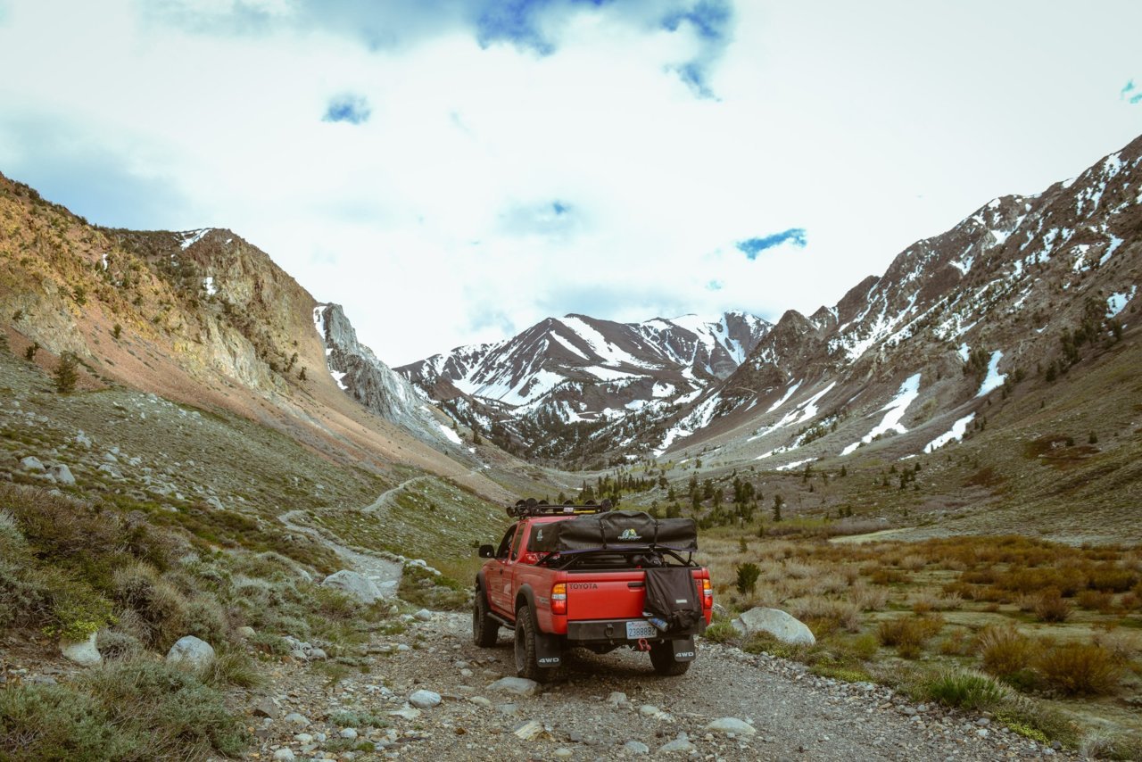

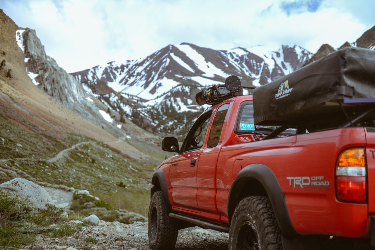

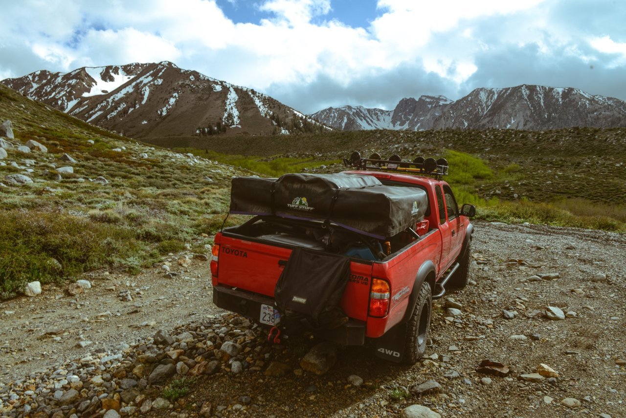

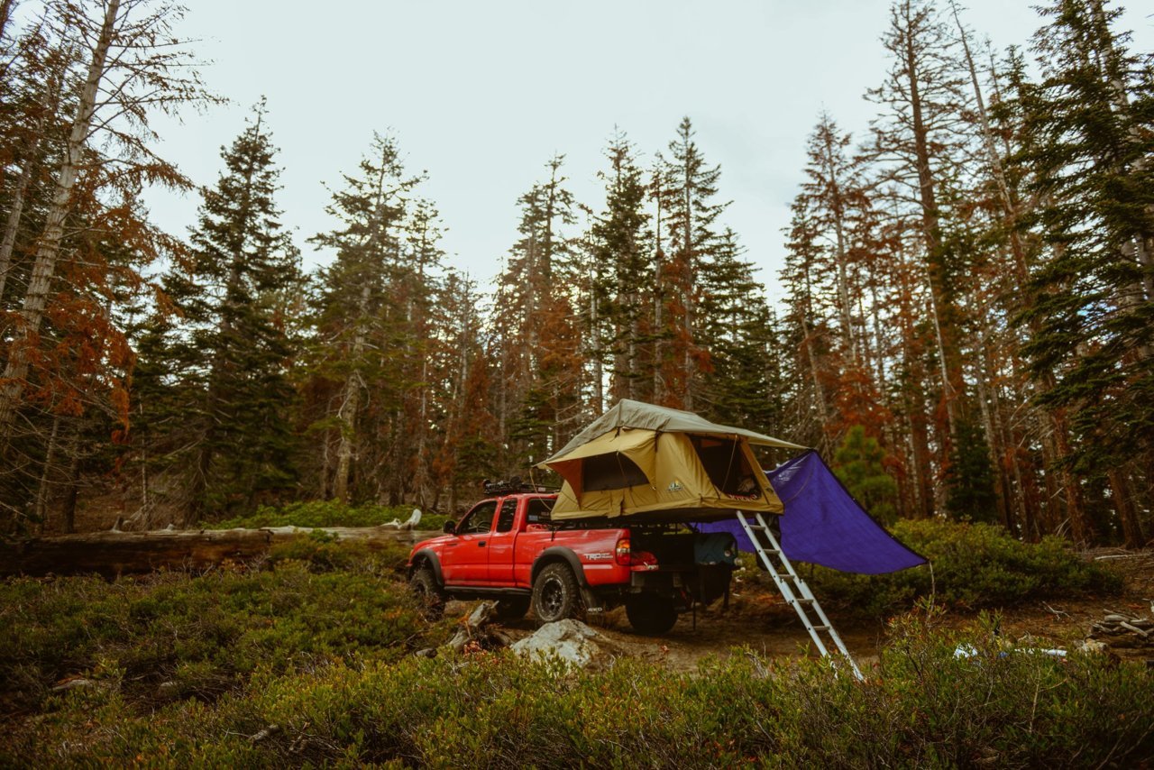

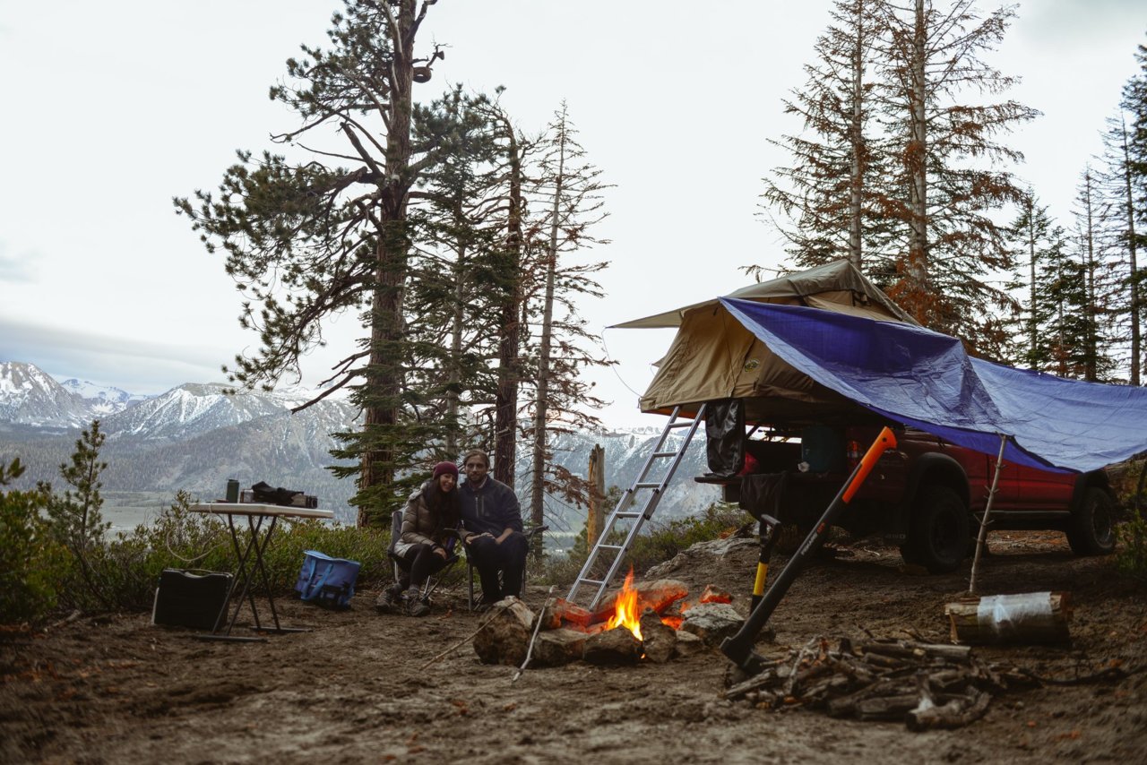

    Went up to the Southern/Eastern Sierras this past weekend to camp for a couple days and nights with my fiancé. Wanted to hit up Laurel Lakes, but could only go about halfway up the trail due to there still being too much snow out there. So we camped at the 2nd campground along the trail about a mile or two into the mountains, was a beautiful place to wake up to. Although we got rained and snowed on that night, which I wasn't all that prepared for...
    2nd day we hung out in the town of Mammoth and then wandered the trails up above there for a few hours until we found a cool camp spot accessible with 4x4 only and a great view.

    So this trip made it undeniably obvious to me that I had way more faith in my new Dakars to hold my camping weight than they deserved....they suck. They suck hard. I was riding on my bumpstops nearly the entire time we were on dirt. My stock pack + 3 leaf AALs held this weight better than the Dakars do.
    So I ordered the OME AAL for each pack, supposed to increase load capacity by 15% and add an inch of height. Hoping that'll level me out when I've got weight back there. If I still need some help after that I'll probably just get an adjustable shackle that I can raise the rear another inch with.
    Oh and the Dakars are noisy AF...have to spray water between the leaves every few days with a hose to get them to shut up. I really don't know why they get so much praise on TW...wishing I had spent more on a Wheeler's leaf pack or the AllPoo HD springs. Only good thing I can say about them is that they ride smoother than my stock pack + AALs did, but not enough of a difference to have made the switch worth it. Hopefully these new AALs help....the Dakar install was a bitch as-is and now I've gotta take them out again to add the new leaves lol. Fun times ahead.

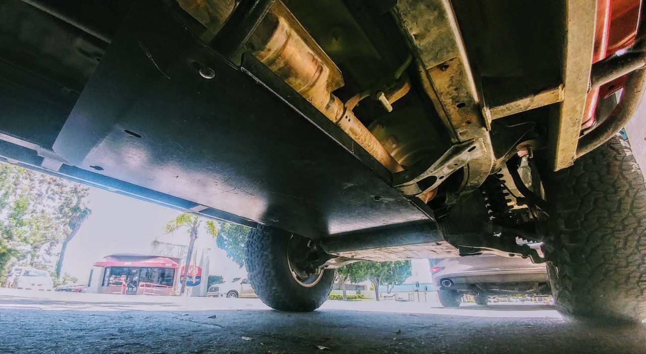

    Got my Budbilt belly skid installed that I've had sitting around for about a year. Much better coverage than the single t-case skid I had on previously, but goddamn is it going to be a pain in the ass to change out my fluids next time :bananadead:

    My front IFS skid is a 3/16" steel skid made by Budbilt, I bought it from another member on here though along with a 3/16" Budbilt belly pan that covers from the IFS skid to the t-case. I only run that one though if I think I need to for a hard trail, otherwise it's too big and bulky to keep on my truck all the time since it's still my daily driver.
    But the front IFS skid stays on, I really like it. It takes a beating pretty well
