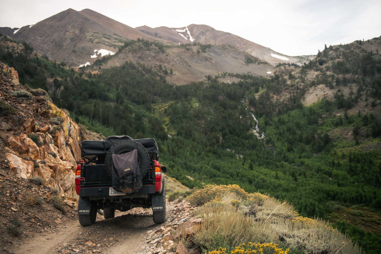

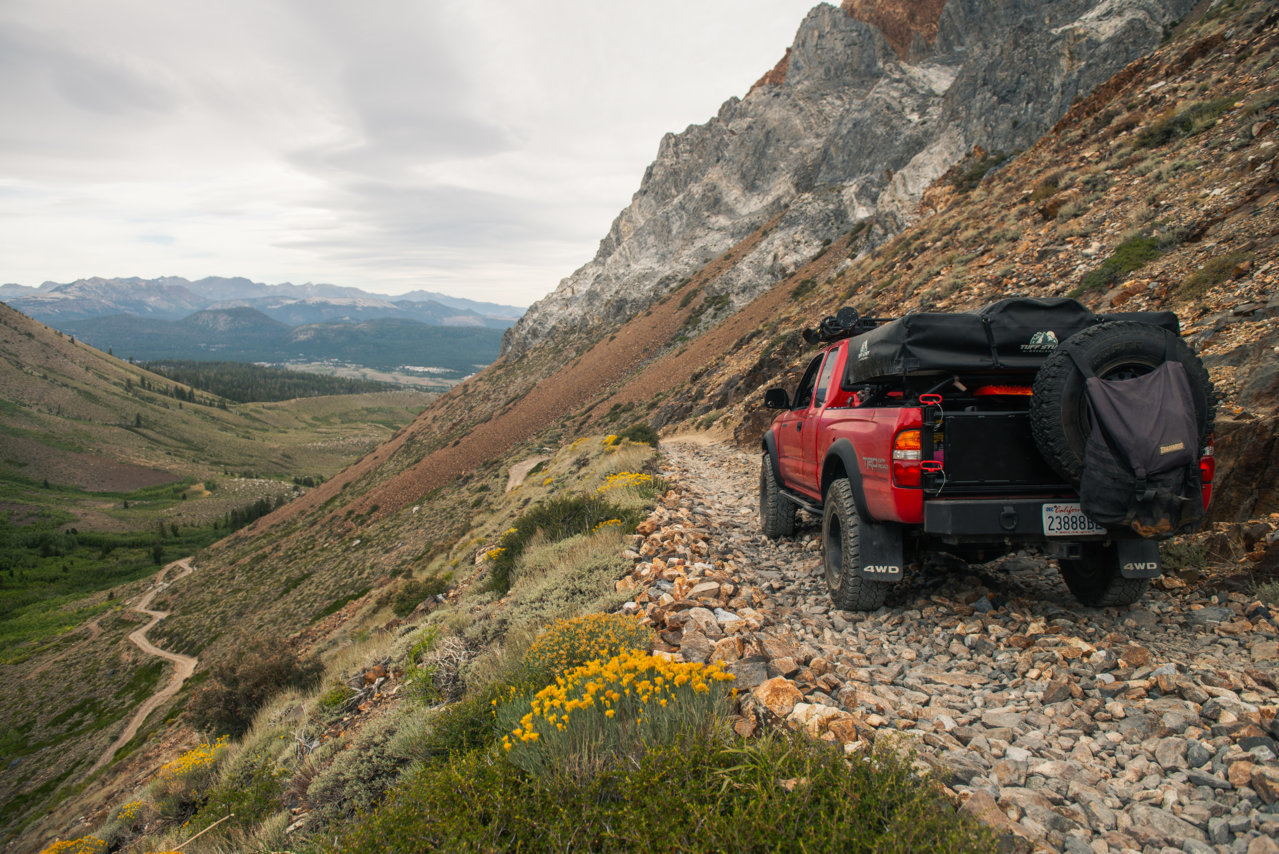

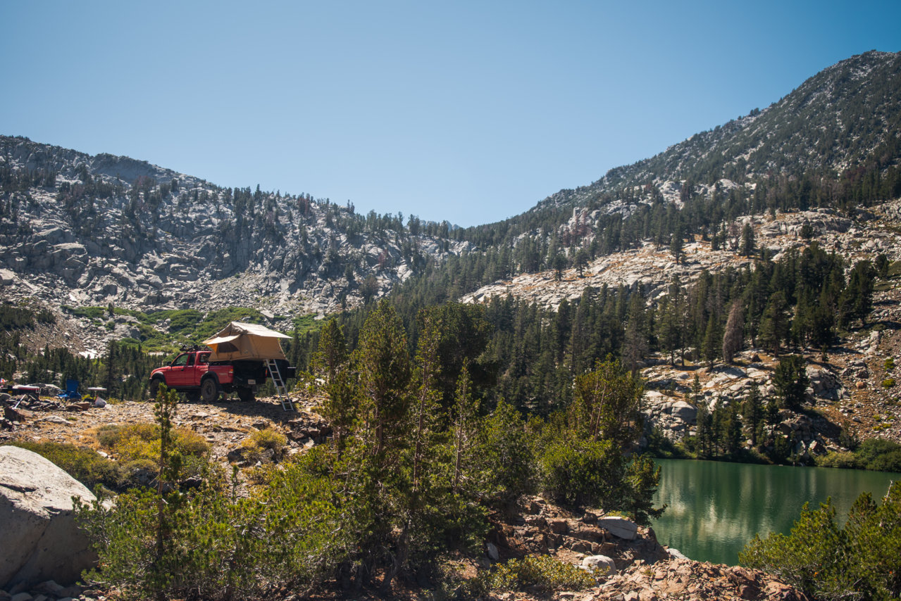

    Went up to Laurel Lakes this weekend in the Eastern Sierras near Mammoth. Lakes sit at about 10k feet elevation, trail to get there is about 4.5 miles long. Not challenging or technical but 4x4 and high clearance required, tons of loose rock all over the place and some pretty steep and narrow switchbacks.
    Great campsite minus the group of drunk frat bros and their ATVs camping across the lake and popping off rounds all day (I'm a grumpy old man, I know)

    Truck looks awesome. I really like that rear bumper. Super clean!
