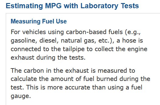

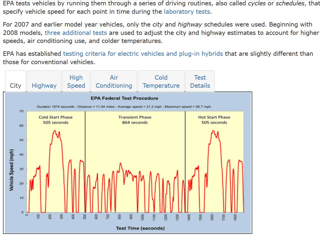

    Dude...
    Did you do... this?
    upload_2021-1-14_8-27-18.jpgor...
    this?
    You have to follow a specific program for a specific time at specific loads and speeds for all categories, then put them together. The whole EPA test is like 70 miles.
    You went out and drove a few miles and used the inaccurate instant mpg meter. You did no test and you sure didn't replicate the EPA test. Your results are just...

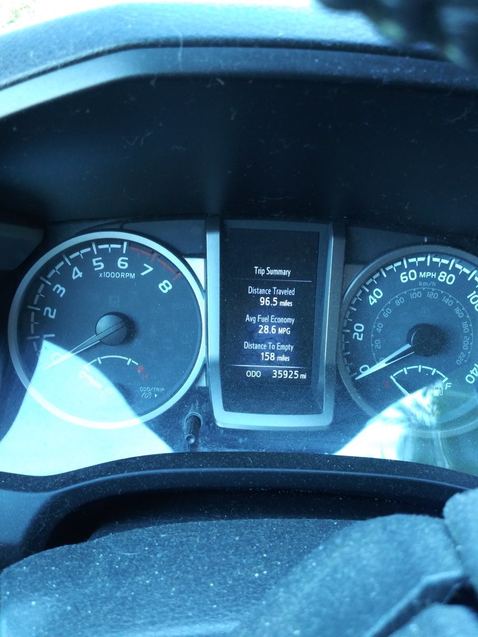

    It's definitely doable

    I already wrote very clearly what I did. Read my original post if you're still having trouble. And the EPA highway test is not 70 miles. Using a dyno is not EPA criteria for testing highway MPG. The EPA clearly states that the dyno is a limitation on their part because it's not practical for them to test 1000s of vehicles in real world conditions like I did.
    The highway test is for measuring MPG on guess what? The highway. Which I did and is more practical to real world results.
    As for measurement I used "Average Fuel Economy" with can be reset on the fly. I doubt you even know about this feature. And it simply measures miles and gas used which is accurate.
    The CRITERIA from the EPA for highway MPG is straight forward:
    - 10 miles
    - 48mph average speed
    - 60mph not exceeded
    - Warmed engine
    - No AC on
    That *is* the criteria. How many MPG my truck gets on a dyno is meaningless to me. This test is about the real highway. Reality.

    Look, how you did it is fine... for you and you only. It is one tiny data point on one day on one stretch of road for a short length of time.
    The EPA tests many different vehicles the same way with the same process. Sure, it's on the dyno because that's the only way it can be repeatable. Otherwise, they would be like you... run a test one day at one temp with the wind at 12 mph ad get a result. Tomorrow they run the same test but will now have different variables and get a... different result.
    Bottom line, if it's not repeatable (all facets of the test) then the results are shit data. I have been testing off highway mobile equipment for years. Some of it we do on test stands, some we do on a specific test track and some we do "in the wild." All of those will give you different results, for example testing fuel efficiency. The test stand will be results we publish because that is always repeatable. The test track will give you a different result but may be more meaningful to a company looking to buy 200 machines in the southwest. The test track would be set up to mimic their working conditions. In the wild testing is wildly variable, and in essence what you did. We only use that to determine gross limits, like is the machine operating within operating parameters. I can take a machine through the woods for one mile and get one result. One hour later I can take that same machine through the same mile and get different results because maybe the ground got wetter... or dryer... or ambient temps changed, maybe the humidity changed, maybe the track slipped a bit more, maybe I ran over that tree differently... my point is, your results are good for you. To publish and be taken seriously, they have to be 100% repeatable.
