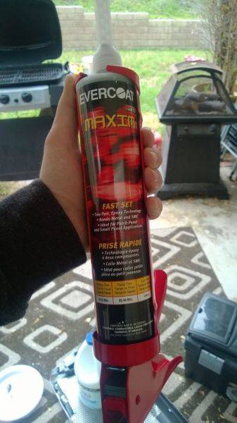

    If you guys want good shit, I highly recommend maxim epoxy. 2 part epoxy that mixes in the tip. You need a pretty nice caulking gun for it though. I use this on satoshis and havent had one problem. This stuff is awesome.
