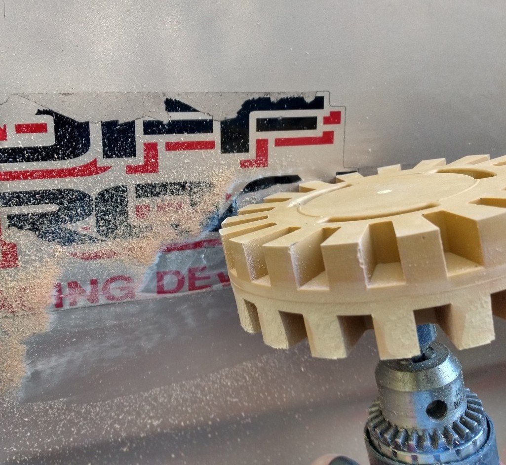

    1) Removing the old decal. The trick to using the eraser is to keep moving and avoid letting the wheel get too hot from staying in one location.

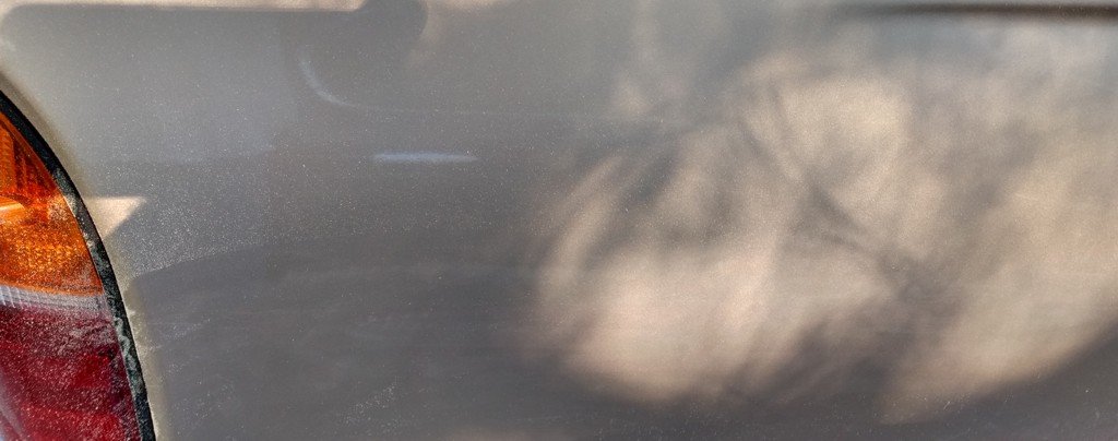

    2) After removal, there will be a residue of eraser dust and some small amounts of adhesive. Don't worry about the adhesive, it can be easily removed with Bug and Tar Remover.

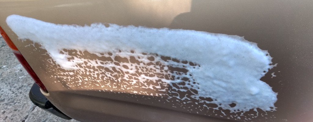

    3) Bug and Tar Remover worked well to remove any adhesive residue and eraser dust.

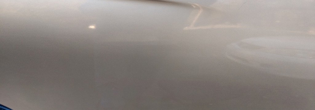

    4) After removal, do not be surprised if there is a difference in the pain that has been covered by the old decal. I will most likely replace the decal in the near future. Otherwise, I will live with the difference until the paint bleaches out from exposure to the sun.

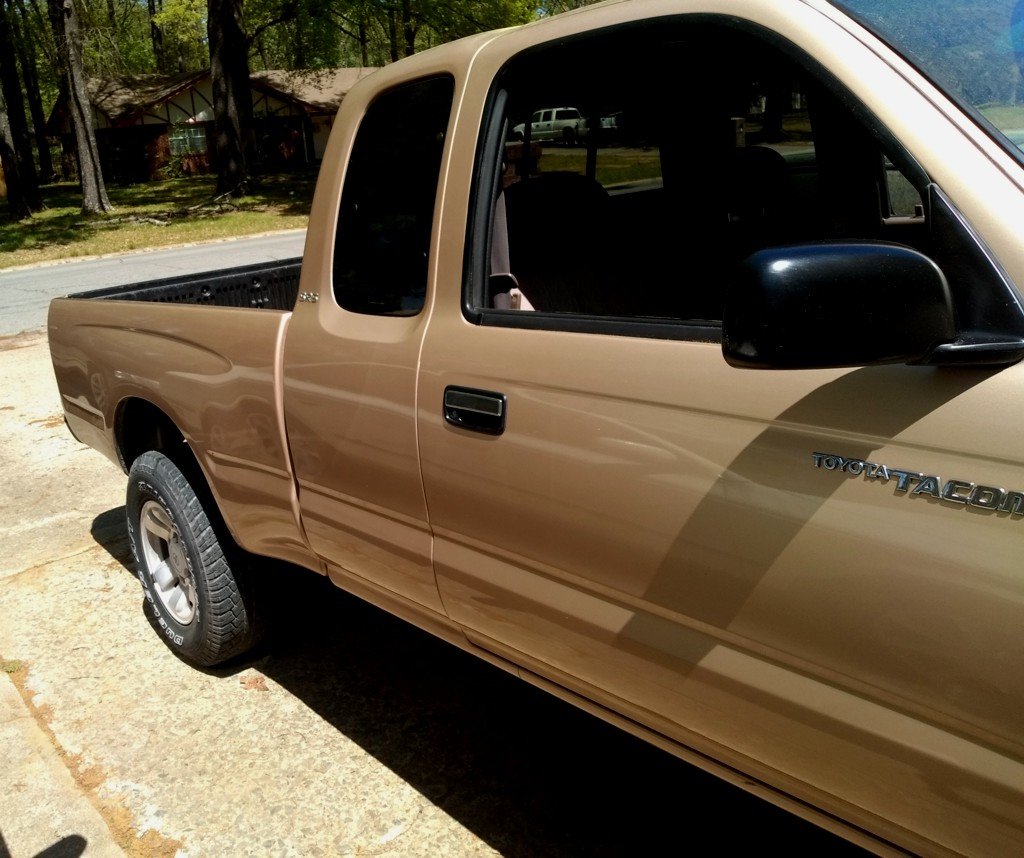

    Finished removing the old pinstripe. It was hard as a rock and cracking. I removed the upper (widest) stripe using my heat gun and a plastic scraper on the passenger side. I still had the smaller pinstripe and a lot of tape residue to remove. The plastic scrapers started melting from contact with the hot paint surface. On the driver side, the stripe was noticeably harder to remove. I suspect that side was exposed to more sun from an open carport that baked the stripe over time. So I used the eraser wheel. It really made short work of the process. I think one "eraser wheel" will remove the TRD and pinstripe before being totally used up. I followed up the decal removal with Turtle Foaming Bug and Tar Remover to clean any remaining adhesive residue. There is very little paint fade under the old pinstripe.
    I plan to get a new black pinstripe and new TRD decal to cover up where the old decals and stripes had been. Here's a picture with the decals removed. You can see the reflection of the Taco's driveway mate showing through in this picture. I will reinstall the wheel flares after I give it a good detailing with my DA polisher one day next week.
