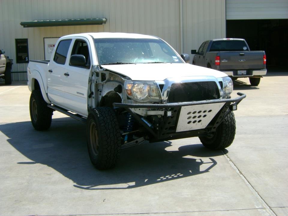

    no big updates other than doing HID conversion on 4 Hella 700ff's, and wiring up Rigid Dullays with diffused lenses for Fog lights.
    spoke with the owner of a paint/body shop and he will be fitting/painting the fenders and bedsides once the right ones arrive.
    Hoping bumper and skids show up this week as well.
    once bumper arrives ill mount the resi's, rear bump stops and all the lights and then go out and get some action shots for yal

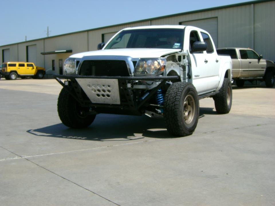

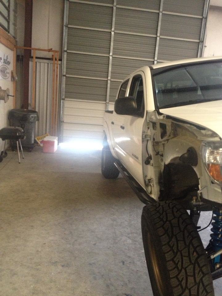

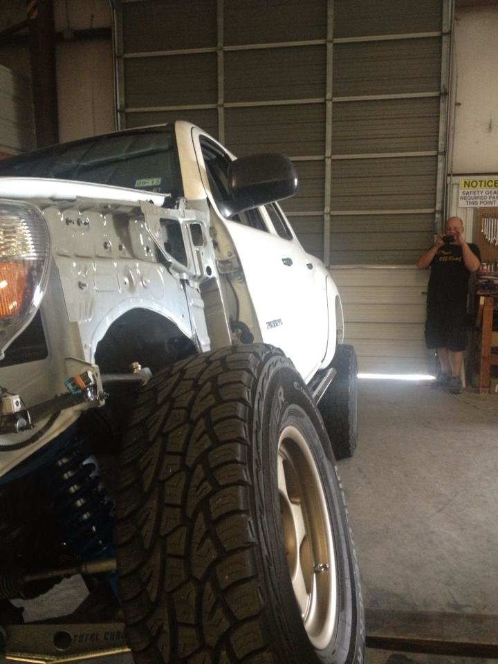

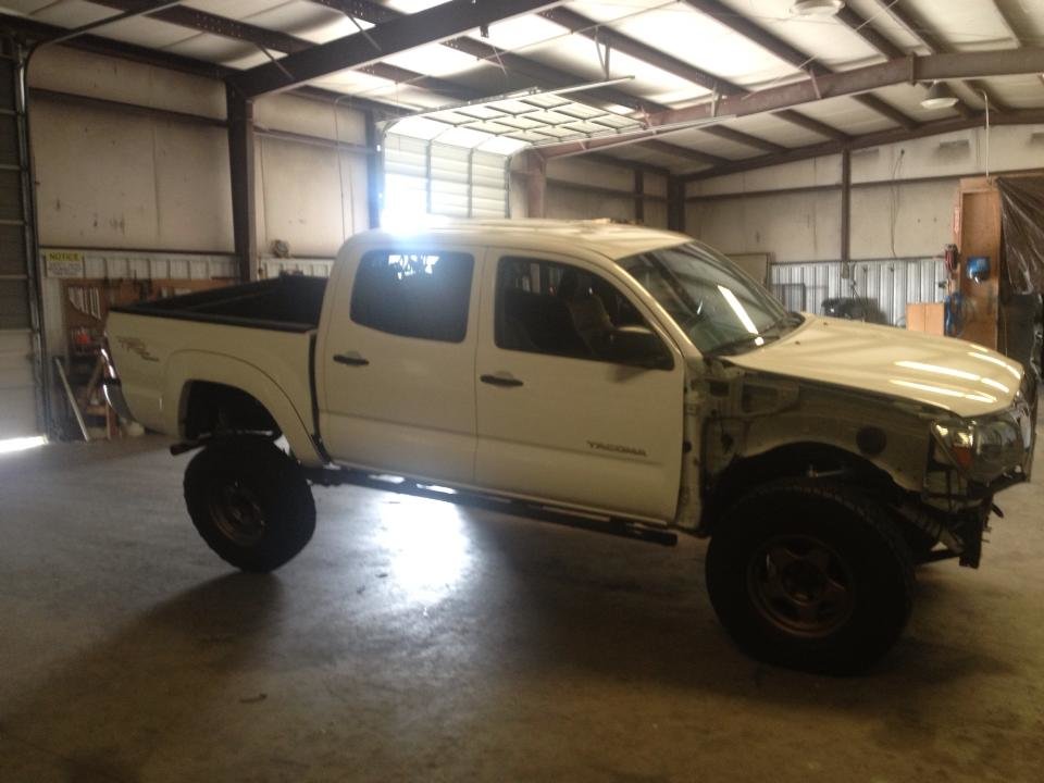

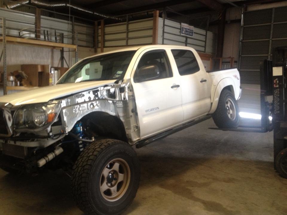

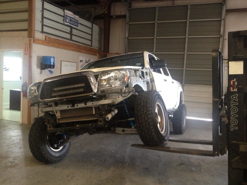

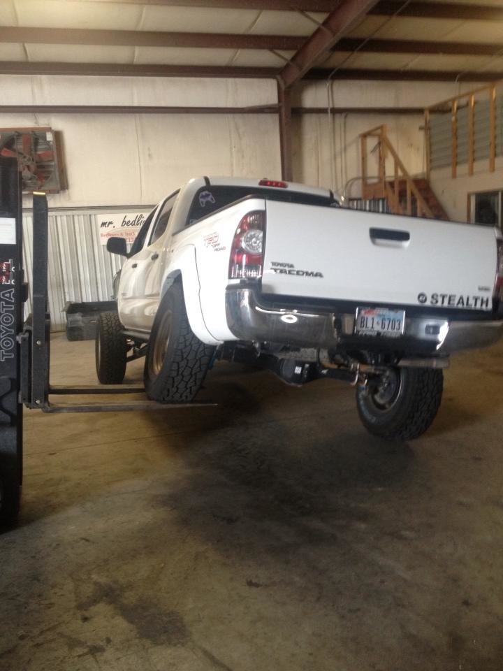

    my friend owns a bedliner and accessories shop and we decided to mess around with the forklift today... when lifting the front tire, the bottom of the tire is about 2ft off the ground when the rear suspension maxes out...
    480636_10151484080778762_1222665829_n_zp_ecf15811f6257cfd432c69ef5f2eaa1525e085b9.jpg
    64287_10151484082318762_1436661927_n_zps_2f9e3d0f484239eeb75594716005829d8273e272.jpg
    483717_10151484084543762_689183266_n_zps_82a58aae288d217b48eb461e8a624059cb84b013.jpg
    lifting from the rear it was somewhere between 1 1/2ft and 2ft off i would guess.
    9655_10151484090928762_2079292628_n_zps6_9de0c6736505e3dd3ea3f5b8cb8f73d6dcc722ba.jpg
    299244_10151484092258762_1789063075_n_zp_b5c107b0f0fa8a5f2cd846a9f092116bbff7507f.jpg
    7555_10151484094123762_659930667_n_zpsc3_8ae1fead54c9af8c87b96c4cce3a62e7fddebbb8.jpg
    front end never compressed enough to even touch the bump stops
    579615_10151484161998762_18847294_n_zps4_81e6876fca05e07e180ca5183a168cf0a2a6f33f.jpg
    i am 5'8" tall and could stand under the drivers side mirror to put it in perspective...
    nothing fancy going on, just boredom ha

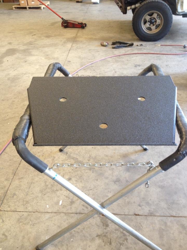

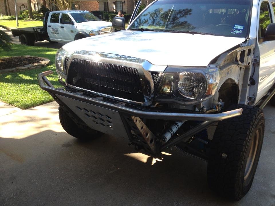

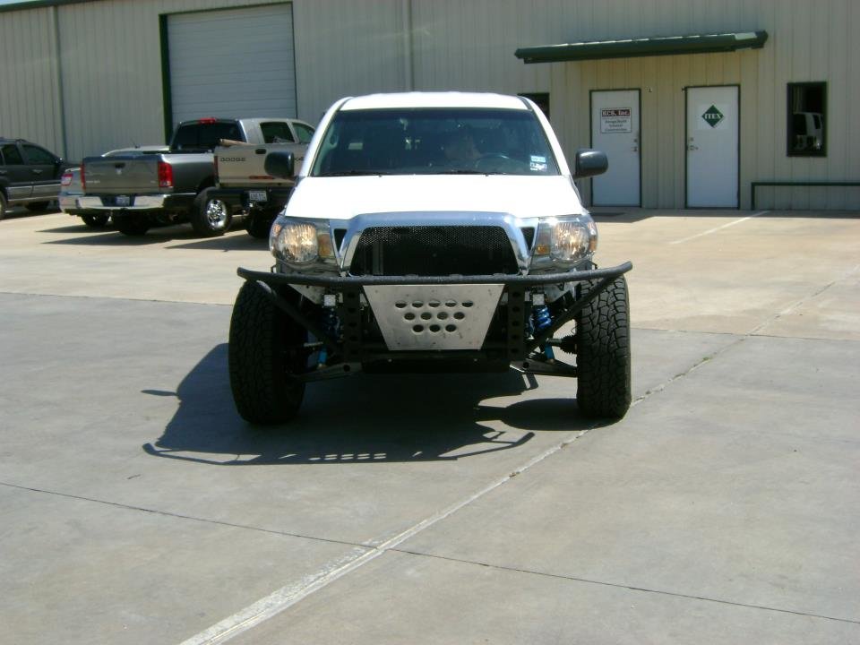

    picked up the bumper and skids this morning, just need to add some tabs for Rigid Duallys, and get it coated.
    going to test fit the skid plates tomorrow and once everything checks out, it gets coated on monday morning. Hopefully drop the truck off Tuesday to get front fenders mounted and painted and just deal with the bedsides whenever they get here.
    522102_10151489627863762_1350738356_n_zp_5f949fe47adeb160b3bcdfeb7f6123be78d67f96.jpg
    524466_10151489627973762_1806817105_n_zp_ef11d646db57023ddd09bf11da5475b4b4c3a312.jpg
    bumper is tabbed for 4 Hella 700FF's which i have done HID conversion on 55w 4500k.

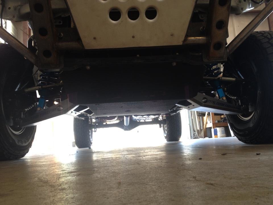

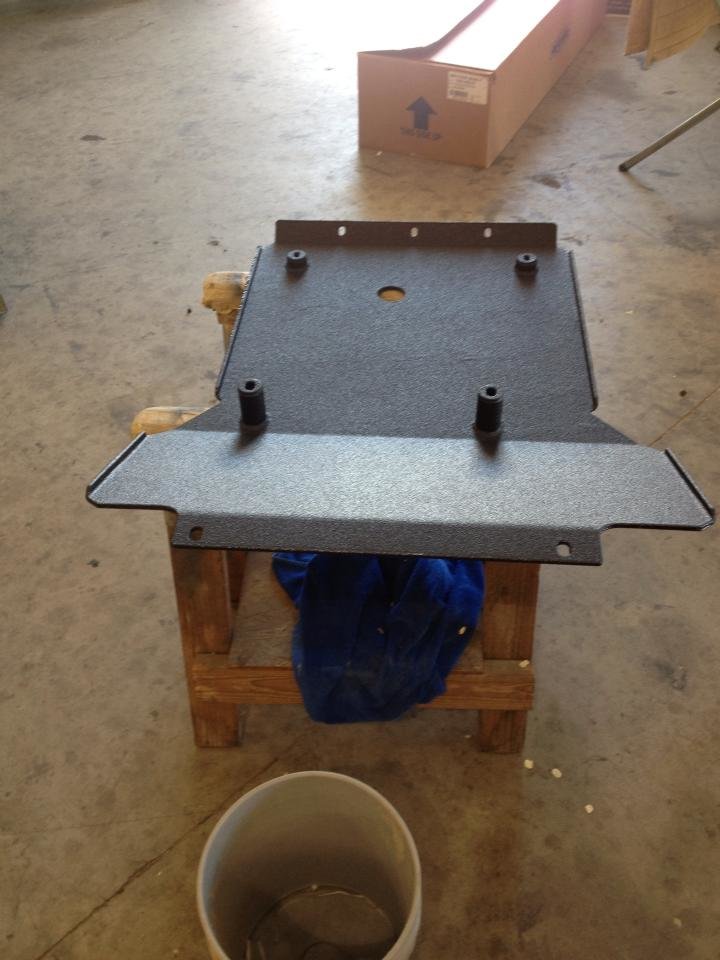

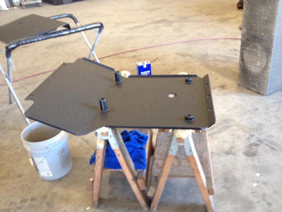

    got the IFS/Mid skid plates sprayed today and mounted up. found out my exhaust has taken a few hits and is bent/smashed/dented to shit so i will probably have a new Y-pipe and cat back built in a week or so.
    waiting on 2 light tabs my friend is cutting out on the plasma table at his work and then the bumper will be done.
    hopefully have the resi's solid mounted tomorrow. i would have done it already but i need to crack the fitting loose and pivot it to get the hose out of the coils, but since i dont have a nitrogen tank to fill them back up i have to find a shop.

    You should be fine loosening the fitting and rotating it. It will be fluid that would leak out from there as it is only half nitrogen/fluid in the resi not the hose.

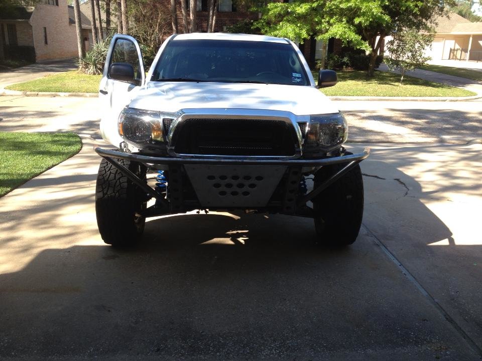

    mounted and wired in some rigid duallys. sprayed the bumper
    just need to finish HID conversion and mount/wire the 700FF lights.
    front end is sitting about 1-2" too low but i am lazy and have not cranked the coils up any yet.
