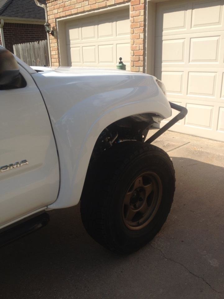

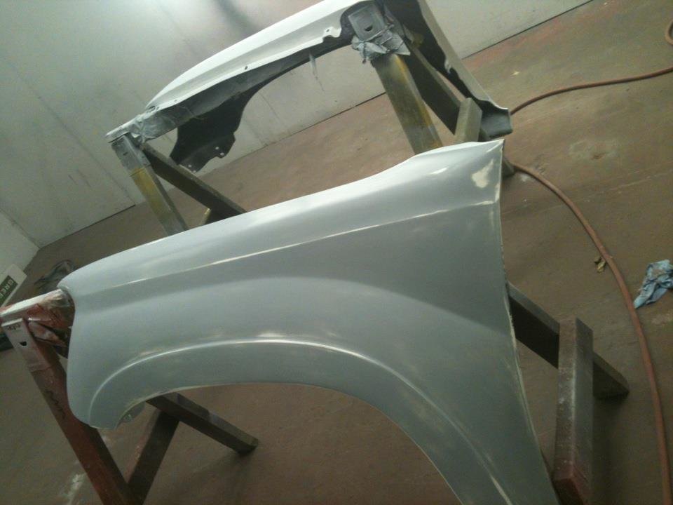

    the fenders are ready for paint now. so for those curious what hannamenn fiberglass looks like.. here ya go.
    31025_10151521098248762_1821578396_n_zps_4d0152fae03b2fb616354fc7a264da90f07bede4.jpg
    935028_10151569232023570_573691715_n_zps_9feb9f73a38c5e9b048fd72bd48aae0002c7e6bd.jpg
    just have to add the small piece of plastic under the headlights
    will have better pictures up tomorrow when i pick it up hopefully.

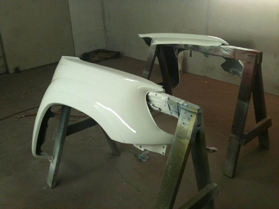

    the guy who is mounting/painting fenders just posted theses pictures.
    935694_10151570661513570_93377313_n_zpsd_b82ca4cb3133fccba7327ded3e49cf62ea9693af.jpg
    934990_10151570660488570_1200405617_n_zp_e38d5880b1892b8e628fb415377f7b202e2d1b6b.jpg
    they will cure over night and then final mount/fitting and wetsand/polish. super stoked

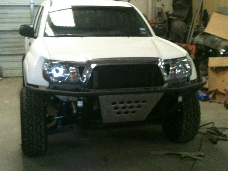

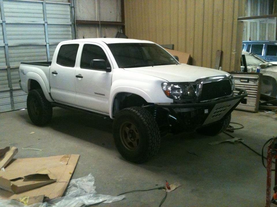

    and now the truck has painted fenders! the fit of hannemann glass is 'ok' but it is obvious it came out of the mold early
    321676_10151523429453762_641360789_n_zps_7b866c8caadd454a5d94475fcd28dacaf3d127c2.jpg
    528263_10151523429558762_285743091_n_zps_f80eb31e08bc16832d289344b411ee5f5aa035ed.jpg
    297953_10151523429493762_1395389216_n_zp_47abb295f20ef193ca44c4bded8c5e6cb7bca71f.jpg
    431841_10151523429603762_1853383817_n_zp_175e7c7eb952ae49104f2add49cfcbceb410fa97.jpg
    936351_10151523383083762_710023234_n_zps_60c05ca9ca6816a48cd37714b799f7289b657450.jpg
    sunday will consist of mounting the spare tire and a yeti cooler in the bed.

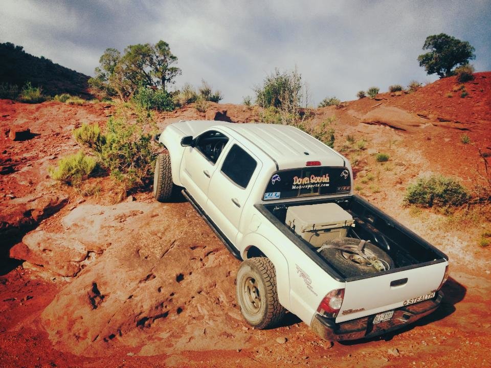

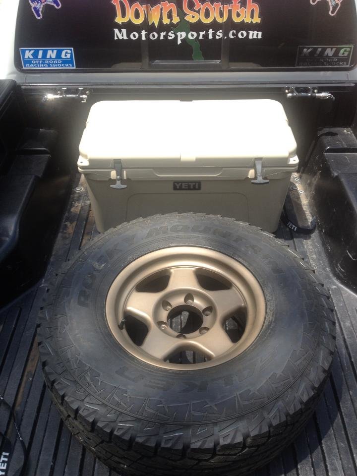

    spare tire and cooler mounted in the bed... will hopefully be able to fit a jerry can for fuel and water back there some how
    not much room in a short bed. thats a 285 and Yeti 65 cooler
    947324_10151527997073762_87776898_n_zpsa_86c21bf4075653321feca2eecbd6d356fb467026.jpg

    That's a badass setup man! How'd you secure the spare right there?
  7. Apr 29, 2013 at 6:24 PM
    #127
    eric3187
    eric3187 [OP] Well-Known Member
    Jun 15, 2012
    #80723
    597
    in that picture it is just sitting there, but i went out and bought 3 5,000lb rated flush mount d-ring tie down points, bolted it to the bed and used a 3 way tie down that i bought from SDHQ. i have some 1,200lb rated d rings to mount under the tire to attach a cable lock, and to secure the cooler down.
    ill snap more pictures tomorrow when i finish it up.

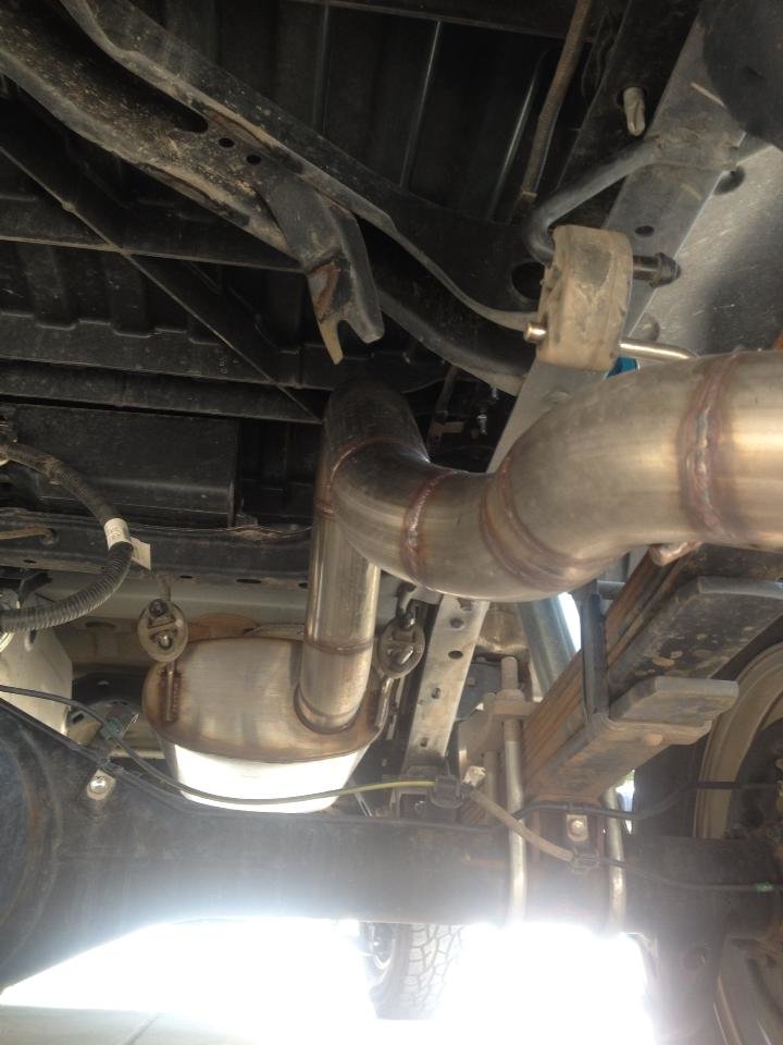

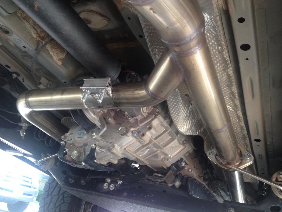

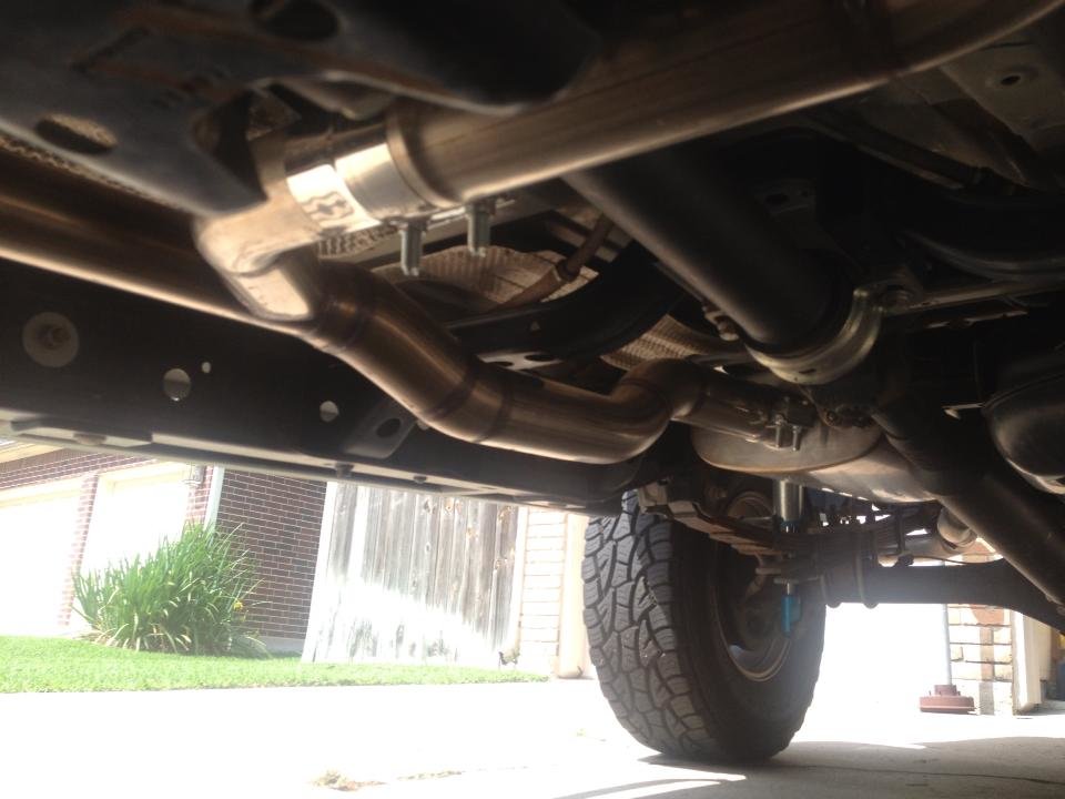

    pictures of the exhaust work i had done. 2.5" y pipe into 3"
    163504_10151530019293762_1322028349_n_zp_6b85e80121dbc27666b2e2d1df05809ecb37eab9.jpg
    942197_10151530019713762_1520893046_n_zp_4d9045d3edfcf8b9671d8223af7cca844dad5fcb.jpg
    308635_10151530020173762_1100676300_n_zp_786250f66e88e92b72e797775a40b77e3ef377d3.jpg
    probably have to redo parts of it if i ever do SUA setup.
    deletes rear 2 cats, 18" magnaflow. under 2k rpm its similar to stock sound, over 2k it gets louder but not that bad.

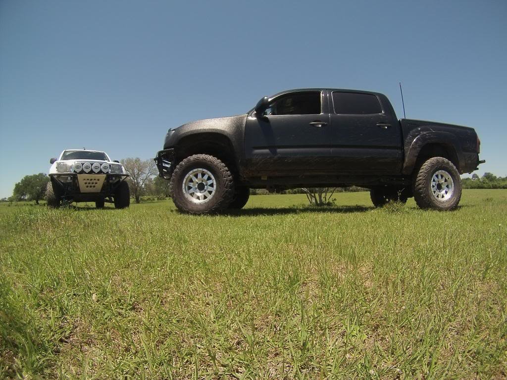

    went out yesterday dickin around at my friends farm... found the weak spots ha, tweaked inner fenders from bottoming out. need to crank coil overs up about 1.5-2"
    heres a video of the suspension.... yes i know the ABS wire is ripped off... and any clumps of "dirt" flying around... well its cow shit.
    rear end likes to buck a bit..

    Exhaust and truck look great. Any concern with burning out the 4wd actuator with this y-pipe reroute?
  16. May 19, 2013 at 8:17 PM
    #136
    eric3187
    Jun 15, 2012
    #80723
    597
    nah, i ran it hard for a bit to get the temps up then crawled under there and grabbed the actuator, no issue from what i can tell/feel. there is maybe 3" clearance between the exhaust and actuator.
    the Doug Thorley y-pipe runs back like this if im not mistaken, and the URD crosses beneath the transmission on the 4wd model. i think ill be alright

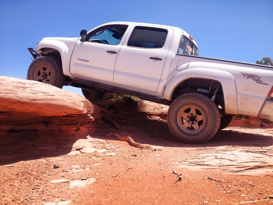

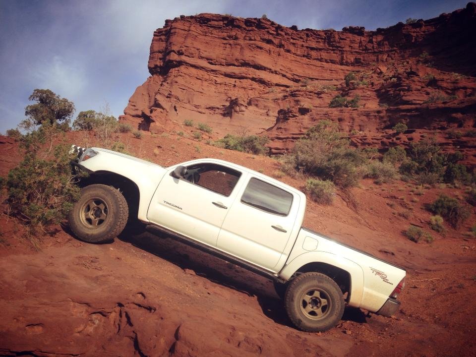

    382418_10151571676623762_1416673288_n_zp_82e0a1634ff1025c6a8dfa9626dc3f96b9433eef.jpg
    264525_10151572523693762_1228926036_n_zp_1e5b4faab43163b6290bea258eda6090a428c088.jpg
    182982_10151566947848762_1679272787_n_zp_b6350ad1d82907343993468ff55d51ff55f358e2.jpg
    970204_10151566949118762_1278740869_n_zp_2ac8c2791e59c8a0bb9312161705b9f46cfdbe71.jpg
    983926_10151571680638762_1667754322_n_zp_10cd294044e621e28f32f0dc47de57f11c0e4f04.jpg
    971159_10151572765368762_2086948886_n_zp_6fbe68c32e21caa75647dd5430e4056942d89005.jpg
    970797_10151572334358762_1285298406_n_zp_09c531b417a03693060cb5d8c0e7ded1453a0f7c.jpg
    968979_10151572766798762_995170516_n_zps_0f479689fdc3a9dcb16298295616edb906fd63f3.jpg
    947038_10151571678788762_210629966_n_zps_ff17fdaa1389d491e04c916df3a053e7ec542c80.jpg
    582103_10151572764858762_81442718_n_zpsd_74fa676b8dd3ad828674967903e95eae6b34d49d.jpg
    580221_10151572334888762_625858225_n_zps_c6af1f94a94402aa542a11074cb8e9a048d5f4da.jpg

    jeeps in moab looked at me like i was insane following them on some trails in the truck
