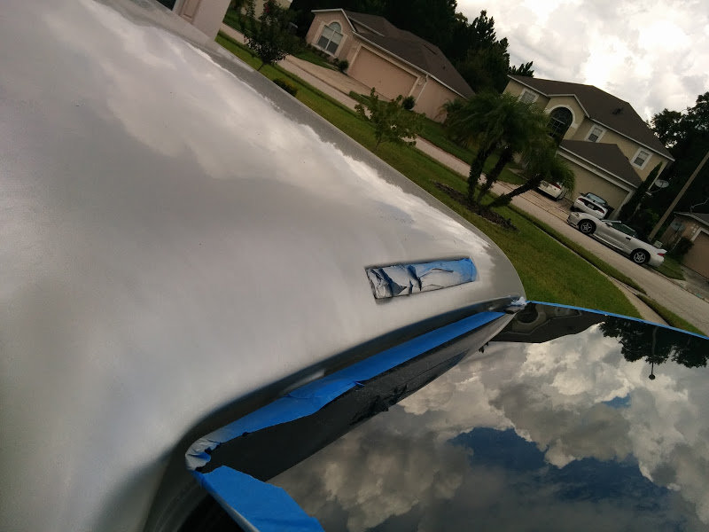

    Painted:

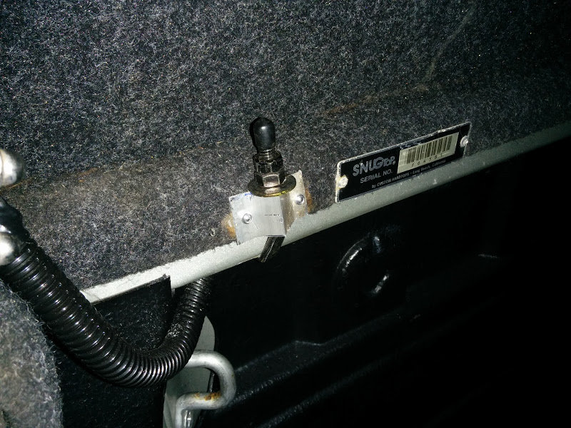

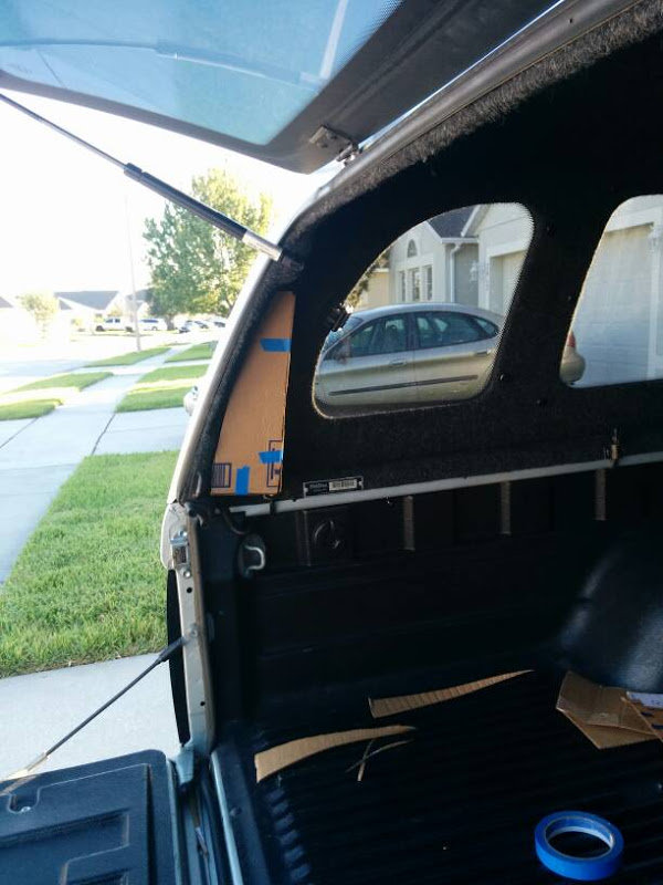

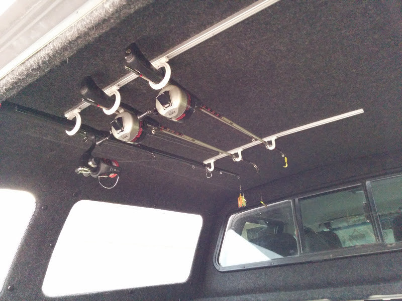

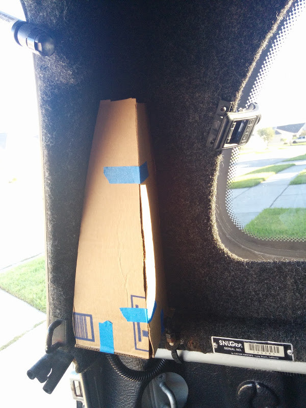

    Today I mocked up an area where I think I am going to put some switches for the cap. The dome light needs to be replaced and I'd rather wire one up to the truck battery than have one that runs off AAs.
    I'd probably have:
    A master switch to bring power to the cap
    A dome light switch
    A rear roof light switch (for when/if I get rear facing lights for on top of the cap)
    What else?

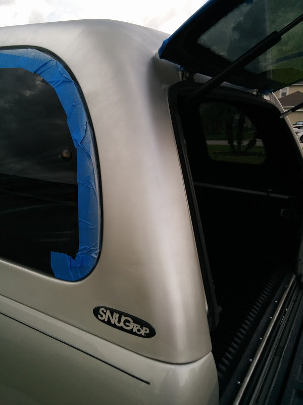

    Today I replaced two brackets that the PO had screwed into the topper to replace ones that the rivets had broken on. I bought a rivet gun and did some riveting for the first time :). My replacement brackets are made from aluminum angle bar that I cut down to 1in and bent to allow mounting to the topper. I am no master craftsman but I am happy with the results, they might get painted black one day.

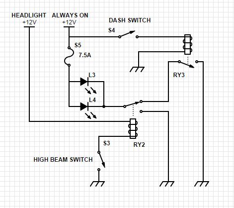

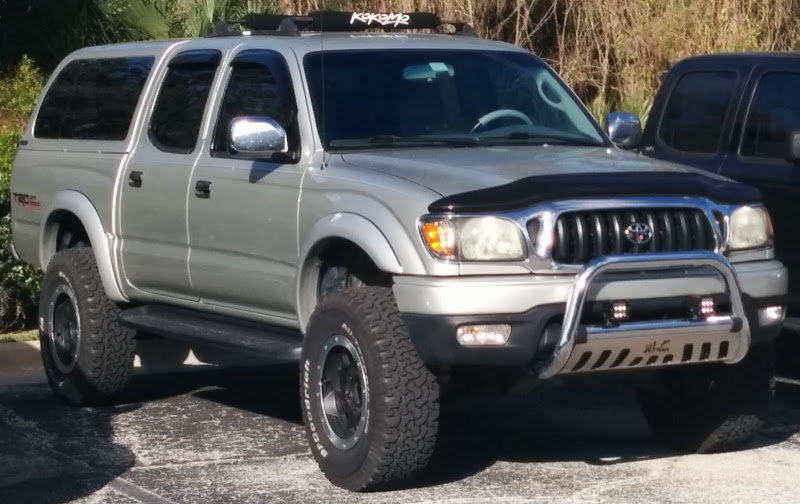

    I also have finalized my driving light circuit (I think):

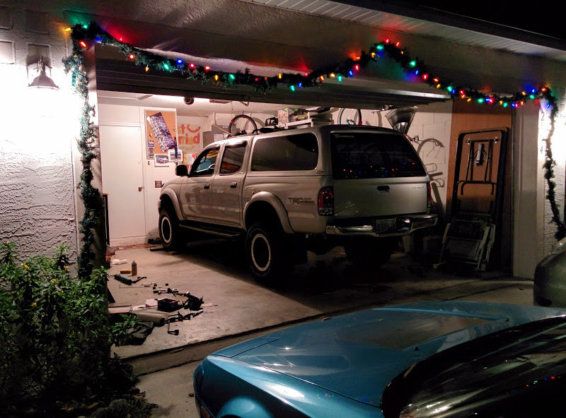

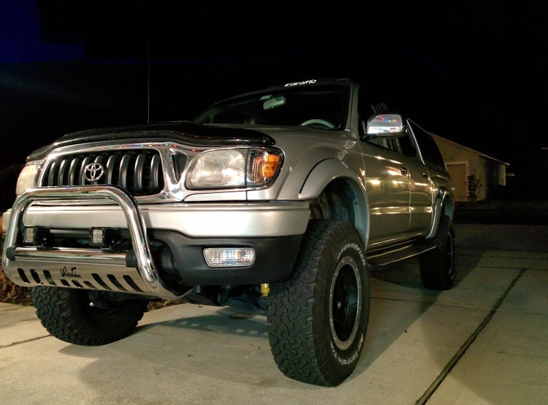

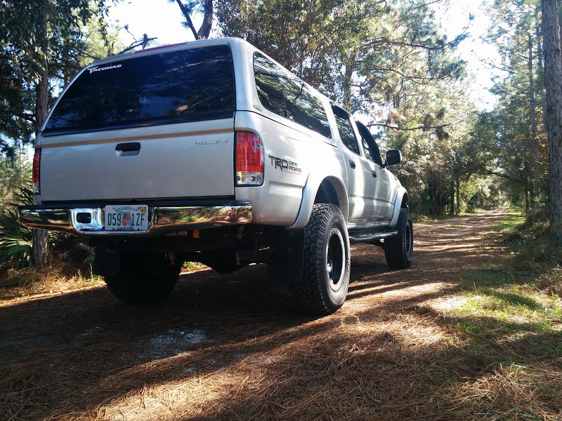

    Package delivered today at noon, wrapping up about 11 hours later.
  9. Jan 5, 2015 at 8:53 PM
    #29
    20vmki
    20vmki [OP] Well-Known Member
    Jun 20, 2014
    #132329
    464
    Eric
    Florida
    '03 PreRunner Limited
    OME 3in lift, Spidertrax 1.25in spacers

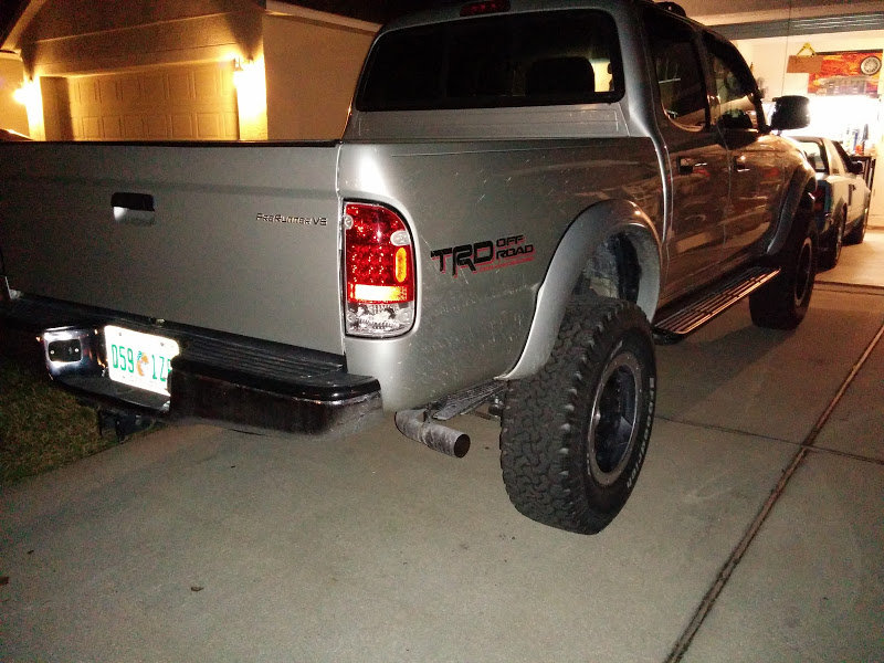

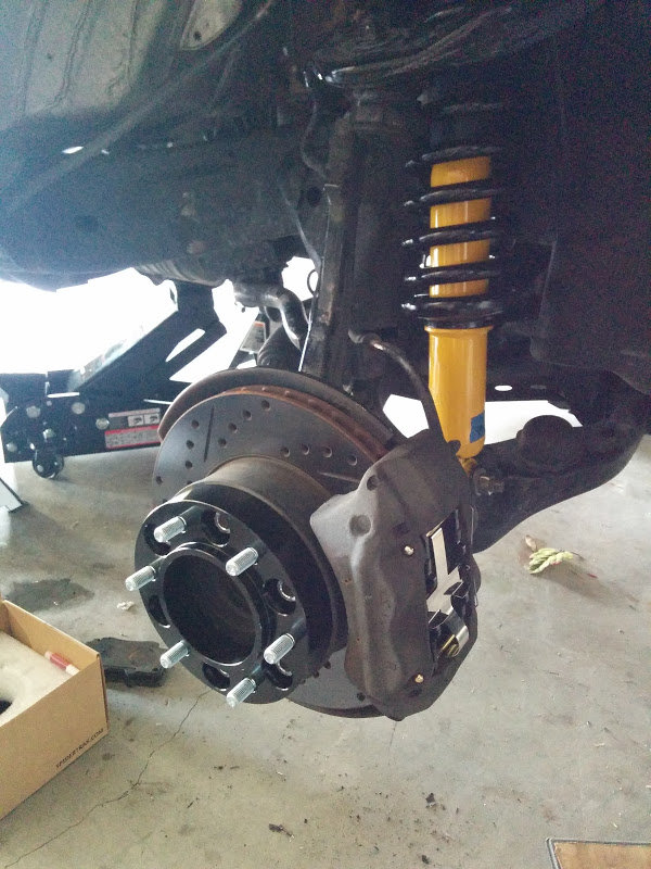

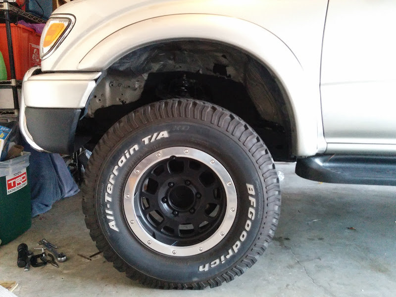

    99% done. OME lift with 881 front springs, 1.25in spacers all around, and new front brake pads. Silly brake fitting tried to round out on me, so going to get a flare nut wrench tomorrow to install the extended brake line.

    I finally beat the brake line tonight and got the new one installed, installed the proportioning valve adjustment plate, and bled the brakes. Lastly I finished torquing all the bolts and went for a test drive. All was well! Will go soon, maybe tomorrow, for an alignment.
    Crappy photos but it was late again by the time I finished...

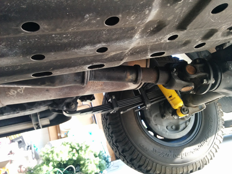

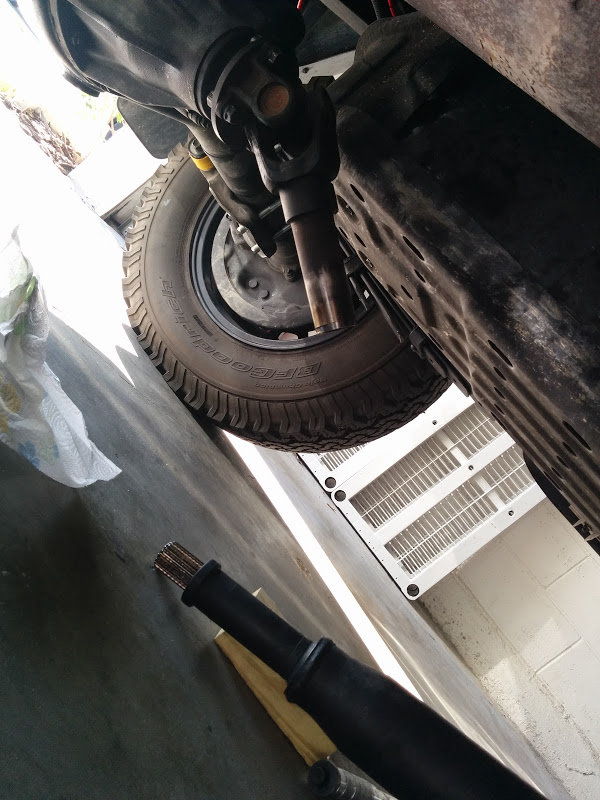

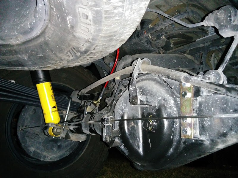

    Popping has gone away, but I still had a clunk issue. Today I dropped the carrier bearing and separated the spline so I could apply grease directly to it. Once back together my clunk problem seems to be fixed, I'll give it a few days to be sure though :)

    Well the clunk in the rear end is still there. I took some footage to try and see what might be happening a the rear end. I plan on checking all my torque values and re-greasing my shackles. Also I bought new brake shoes but on removal of the drum I found plenty of life left on the existing shoes so I didn't replace them. I might still revisit them and ensure proper adjustment and grease as needed.

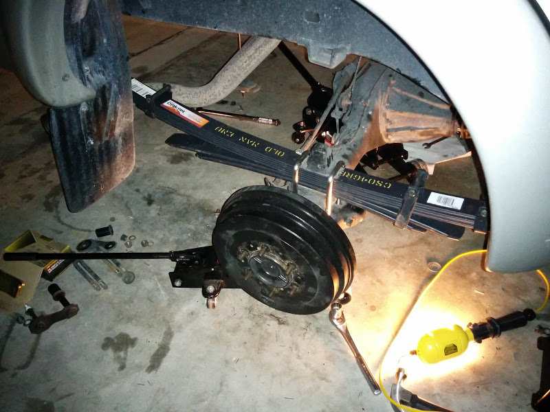

    Here is some better footage. Shackles were taken down and greased. I think I am leaning toward the spline again with this new footage. Maybe need a carrier bearing drop?

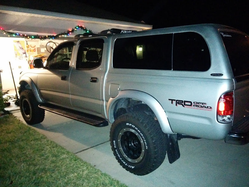

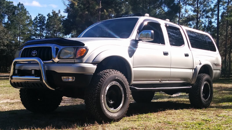

    Topper came off recently, really enjoying how the truck looks without it

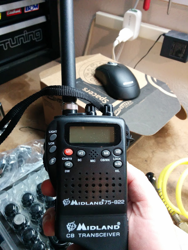

    Also got a CB for an upcoming Florida meet!
    Also, later in the night my rear mud flaps might have come off :)
