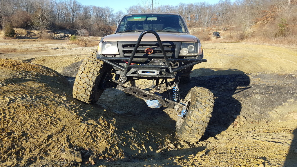

Eric's Supercharged Shit-box
Discussion in '1st Gen. Builds (1995-2004)' started by Supra TT, Dec 30, 2011.
  1. Dec 30, 2011 at 8:08 PM
    Supra TT
    Supra TT [OP] Supercharged Lifter
    Jan 3, 2011
    #48645
    7,226
    Eric
    Indiana
    2000 SAS D60 F/R Supercharged

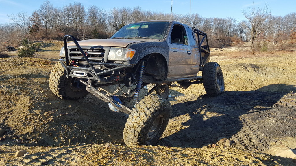

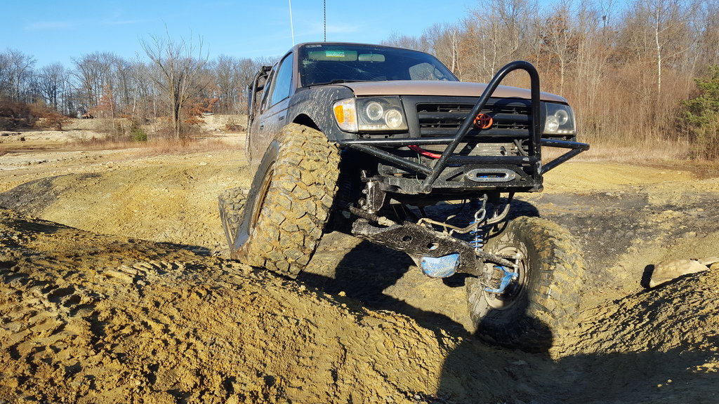

    After another year or so I realized I hated IFS so much I decided to SAS cuz it's what the cool kids were doing at the time.
    Ford 9" and a Ford D44 HP reverse cut, full width axles from a 1976 F-150.
    Did some cleaning up on a warmer day.
    New tires? :D Practically new 37x12.5x15 Goodyear MT/r old styles.
    Not many pictures of the swap... Long story, shop owner was a cock sucker.
    I brought the truck to SidCo 4x4 in Glencoe, Mn. Last year right around this time. We worked out a decent deal, which I believe is right, but we'll see for when it turns out complete.
    Specs: Simple leaf sprung swap,
    Front Axle-
    -1976 Ford F-150 Dana 44 HP RS.
    -5" lift springs, Marlin Crawler
    -5.38 Gears, Superior Axle and Gear
    -Powertrax No-slip locker, Just Differentials
    -300M U-joints, Longfield axle
    -Warn Premium Hubs
    -Reid Racing Knuckles
    Rear Axle-
    -1976 Ford F-150 9"
    -1.5" lift springs, WheelersOffRoad
    -2" AAL, Fabtech
    -5.43 Gears, Superior Axle and Gear
    I had purchased almost every part myself, leaving all the fabrication to the shop. Shop is providing me a driveline, and steering links.
    I am sticking with the 5 on 5.5" bolt pattern, since I had the matching ford 9" and didn't want to convert everything.
    Throughout this build I couldn't get many pictures due to the shop owners disrespectfulness and wouldn't allow me to get any pictures, not to mention ever time I showed up he never had any progression.
