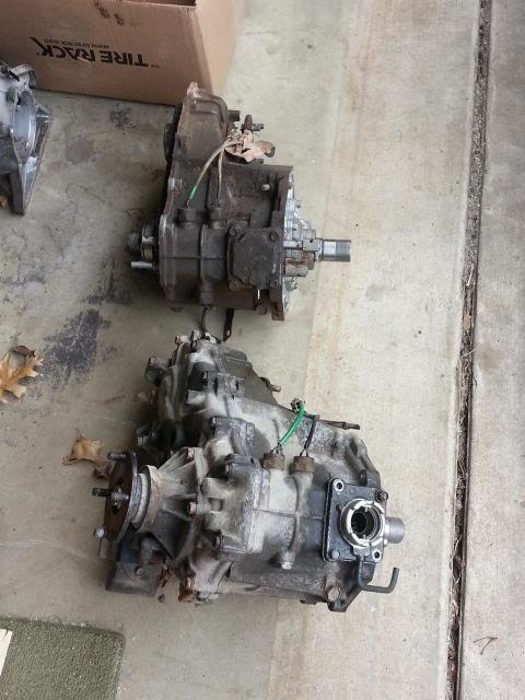

    Coulda been done but I didnt wanna cut up his tranny tunnel...lol. His case was a forward shift and the donor was a top shift so had to convert it. What a PITA. Anyone who takes apart one of the case beware...dont play with the shift rails :eek:
    I ended up doing this thing three times bc I would test it and move the 4wd rail a little too far and then you just hear "tink tink tink" there goes the pawls on the 4wd drive synchro dropping in the case...shit do it all over again.
    Anyways pics and a video when I get to a PC. Peace yall.

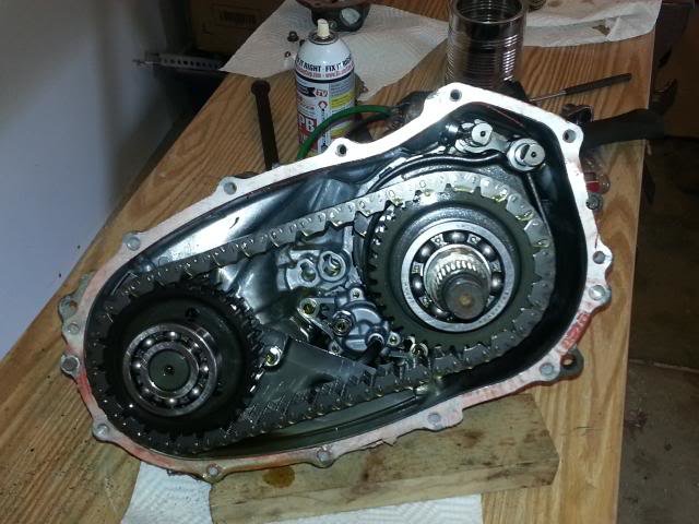

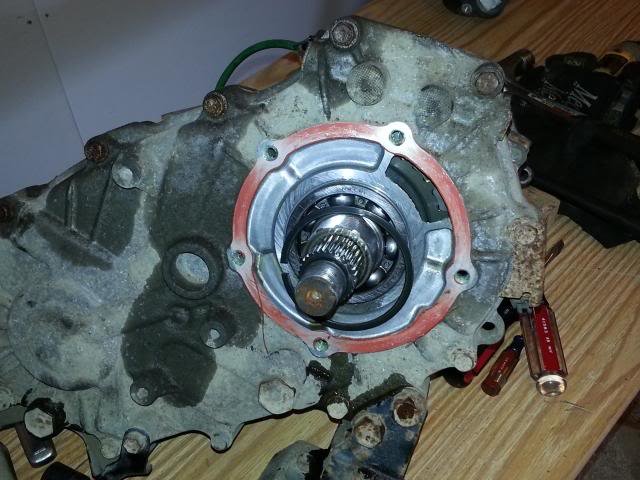

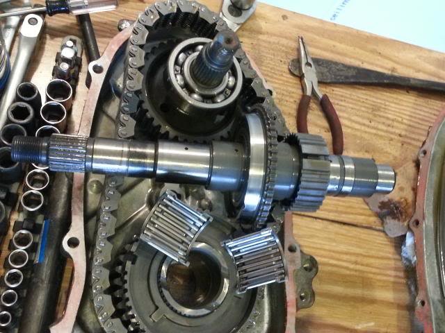

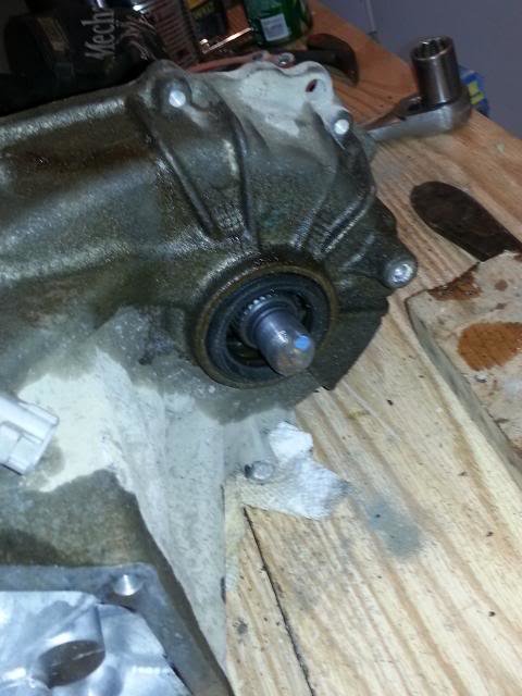

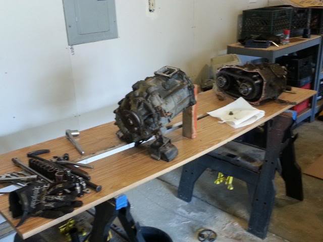

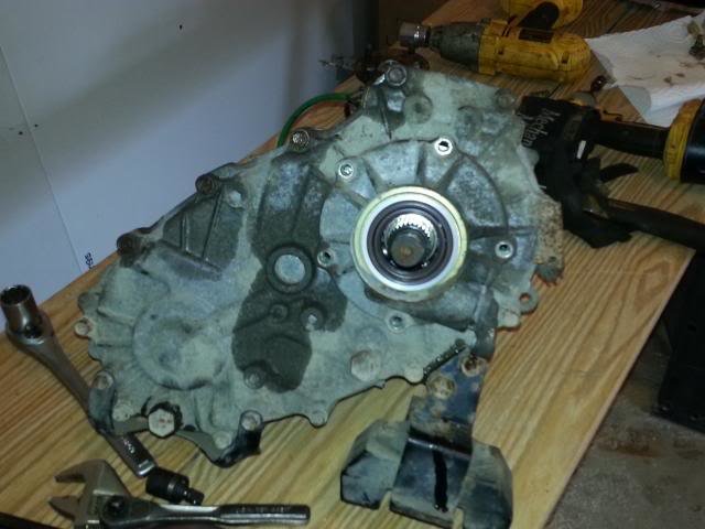

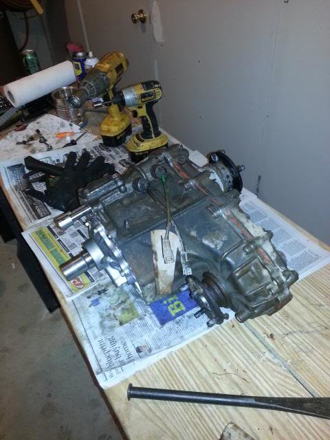

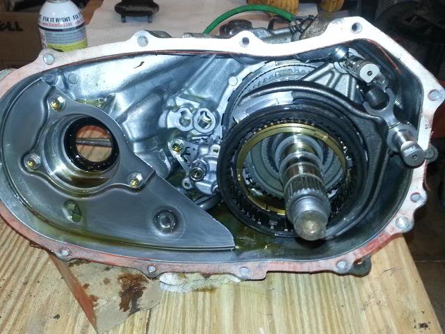

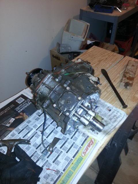

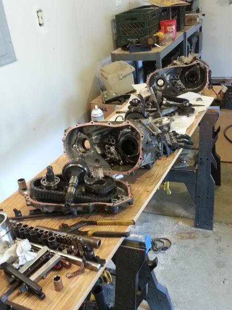

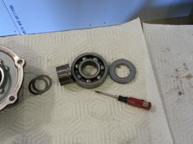

    Out with the old in with the new right? Wrong. Top shift vs. Forward shift:
    Its either swap the rails or swap the inputs...dont know how to do either so lets tear into it :D

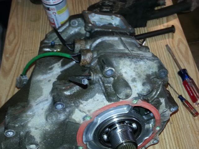

    Remove rear output flange:
    Output cover removed and bearing c-clip removed:

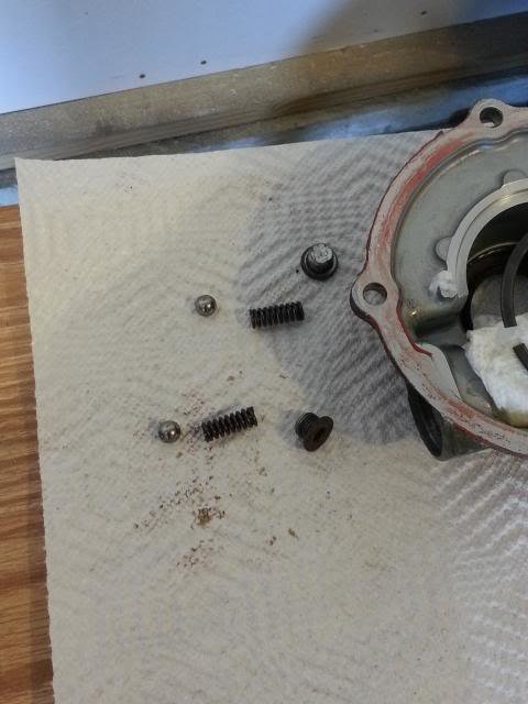

    Remove shift rail indent balls and springs:
    Split that shit!

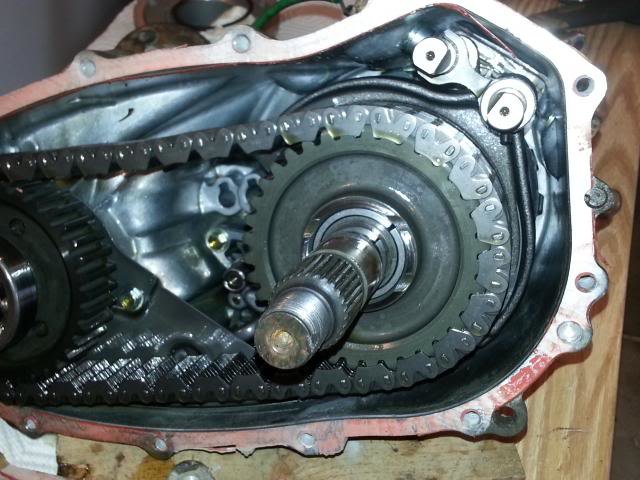

    Speedo gear, output shaft bearing, sprocket retainer and ball:
    Getting closer to an empty shaft:
    Remove front output:
    Remove sprockets and drive chain:
    B-I-N-G-O !!! Theres the shaft we need!
    Now repeat for his case :(
    Both torn down:
    Eric's case back together...good as new! :D
    And proof that it actually works! (Clicky for vid :D, pay no attention to the crappy narrator and the upside down video)
    In the end I reused most of eric's original case except the output shaft (duh!), the ouput cover, and the speedo gear. And thats how thas done. :D
