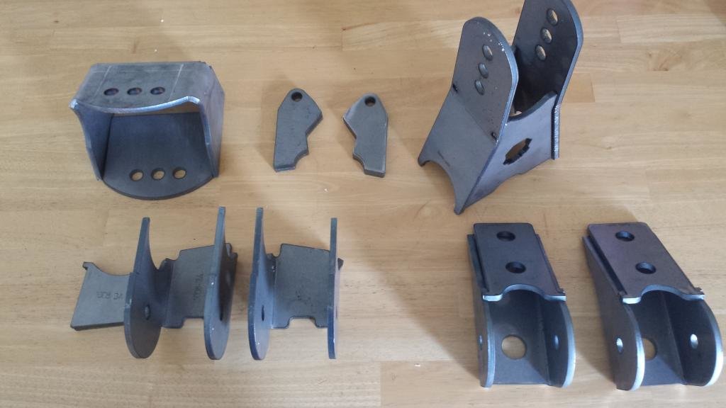

  13. Feb 8, 2015 at 5:57 PM
    #993
    Supra TT
    Supra TT [OP] Supercharged Lifter
    Jan 3, 2011
    #48645
    7,226
    Eric
    Indiana
    2000 SAS D60 F/R Supercharged
    Supercharged on One Tons
    No kit, just random shit from ballistic. HD frame link brackets with DIY axle upper link bracket and a 22 degree frame upper link bracket. The shock tabs are inner c gusset/CO tabs. And the lower link axle brackets are 10 degree angled brackets.

    Yea that is an excellent kit and I would go that route except I don't believe I need heims all the way around. Slightly rougher ride due to the heim. I went with barnes enduro joints for my lowers. Also, I don't need a 1.25" heim for the upper and I am going with a 7/8" heim as I believe that will be plenty strong.

    Hmm my truck will still be a dd so I wonder if i should do heims. I didnt know they produced a rougher ride?

    It's not that much difference, but supposedly there is a slightly better ride with the joint style vs heim. Heim is the stongest though, but are you doing ultra 4? Probably not needed! This bitch best ride like a couch with $1500 in fucking shocks fuck that noise!!! CO FTMFW
