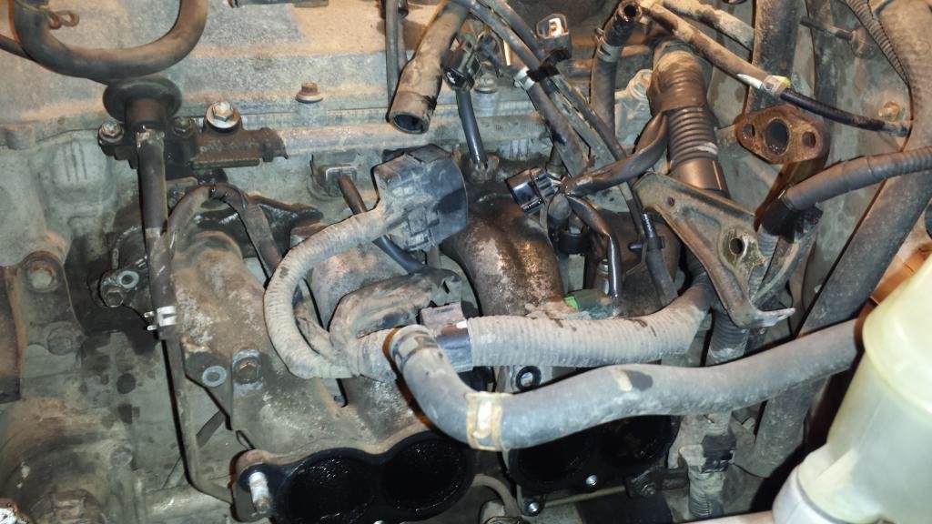

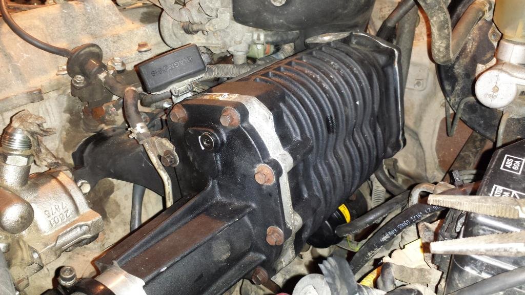

    Anyway, here are the rest of the photos...
    Big thanks to Mark (NwiTACO) For lending me a hand and letting me steal his entire weekend as this project took at least 20+ hours
    BUNCH OF RANDOM SHIT...

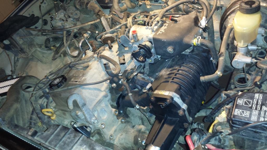

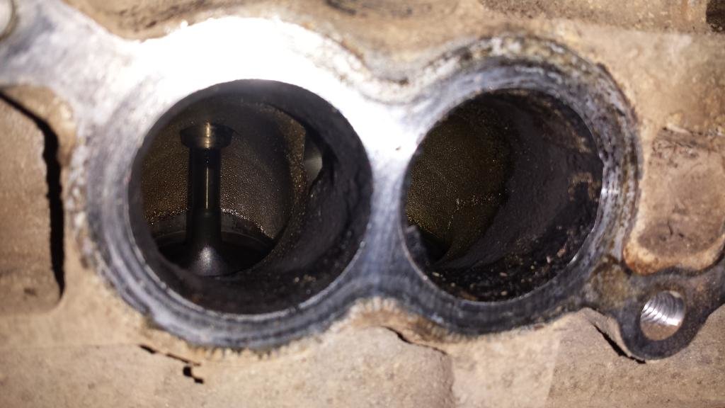

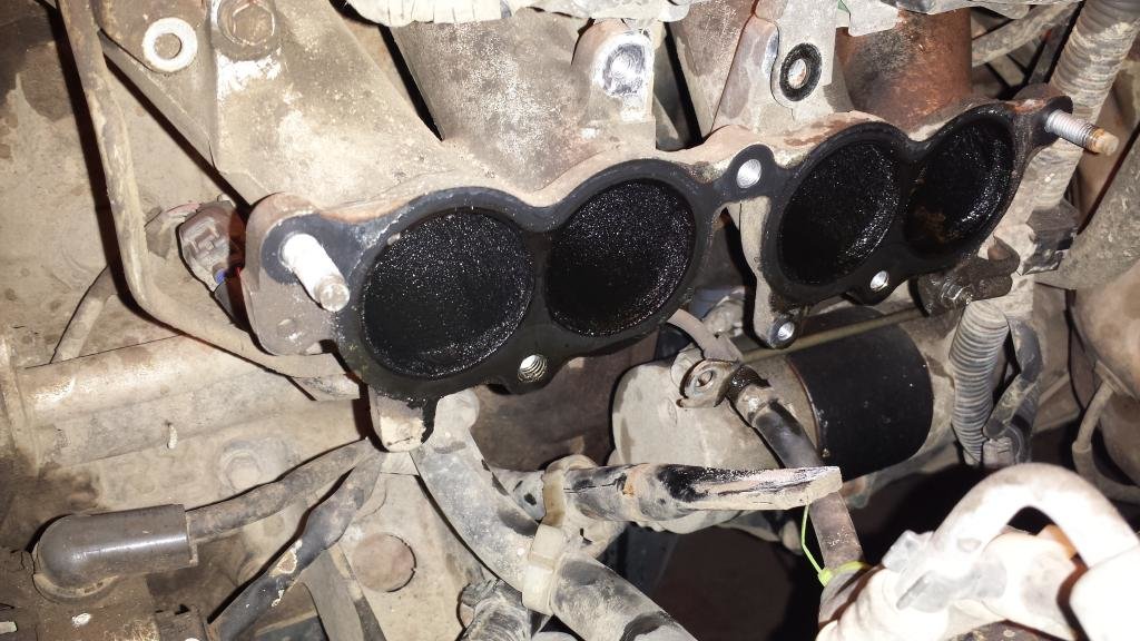

    Nasty intake side of the 3rz... these engines are dirty.
    At least the valves look straight.

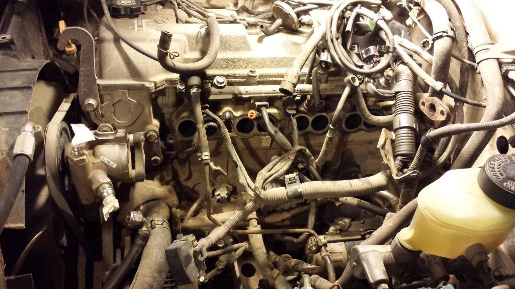

    Half ass in there

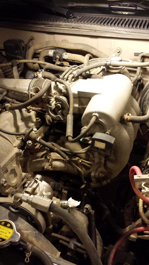

    DONE!

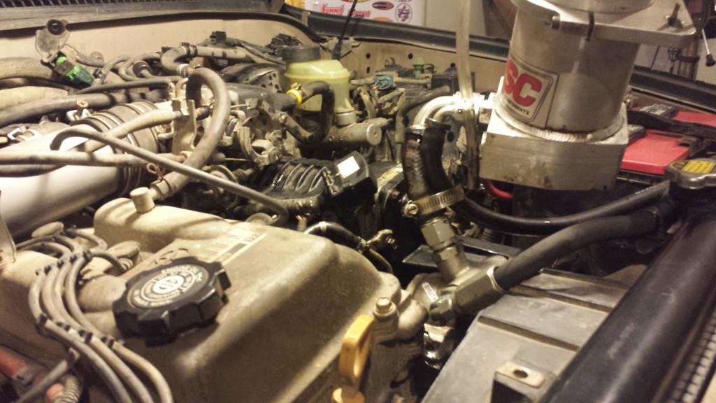

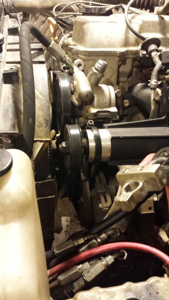

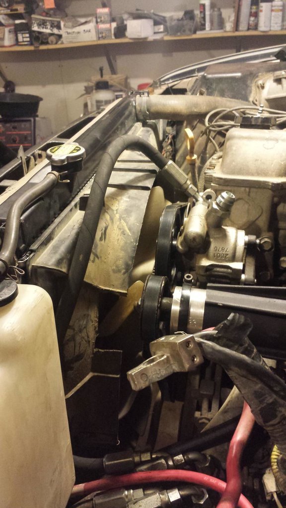

    Ran into issues with the PSC pump since it's not stock and neither was the resivoir... We had to rotate the pump back to stock location and well... it's a bitch
    You can see How shitty the hoses are now because of the pump. Gotta get new fittings and clean it up.

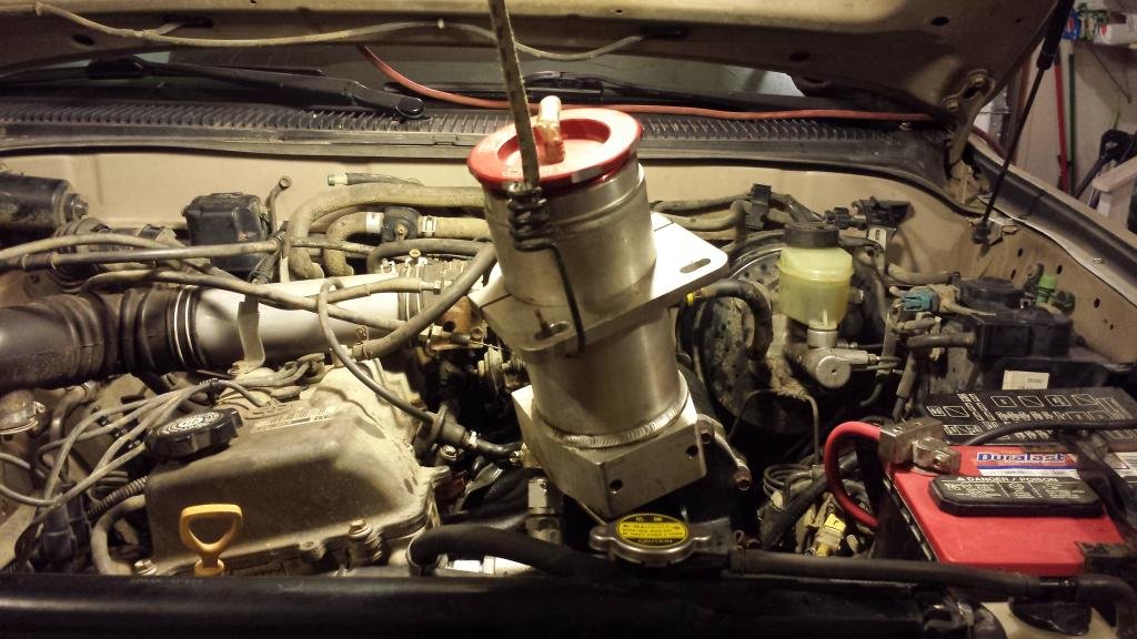

    Basically in order to heard the truck run again we had to prime the PS system again and we had to hook up the resi for that obviously.
    Since the resi is so large and the pump is so HIGH on the engine, in order to have a proper flowing system the bottom of the resi needs to match the top of the pump in order to gravity feed the system... Thus... leaving the PS resi too tall and it needs to be cut into the hood. Next project...

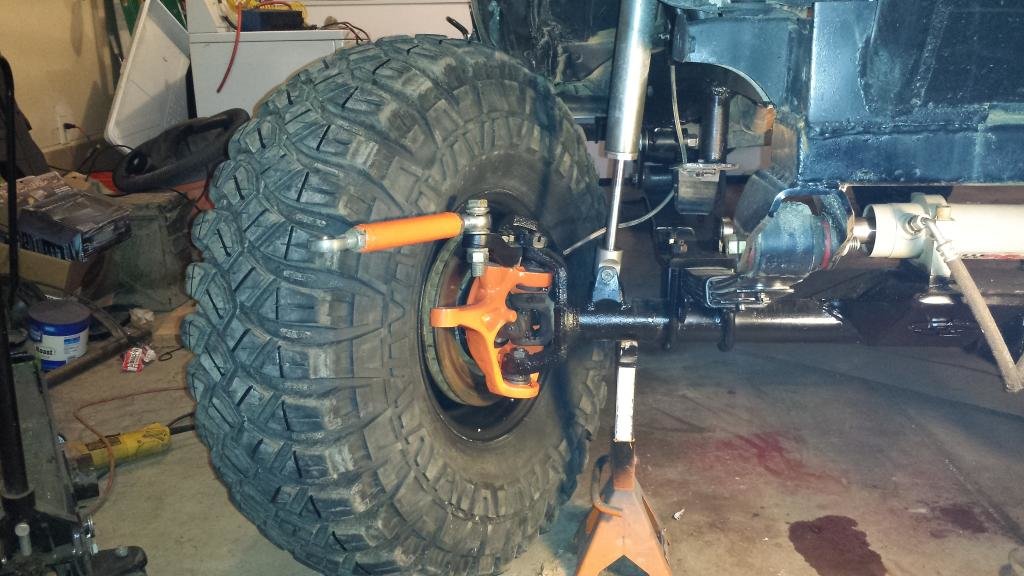

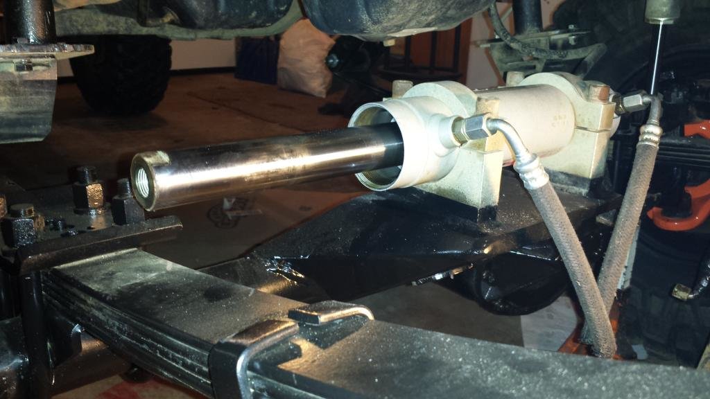

    Also while I was at Marks house we took out my steering stops and shortened them as I was being limited a TON of steering. Took an entire 1/2" at the tie rods in turning distance. Probably about 5* of steering.
    Old vs new

    Damn that intake is nasty! Get a catch can :goingcrazy:
