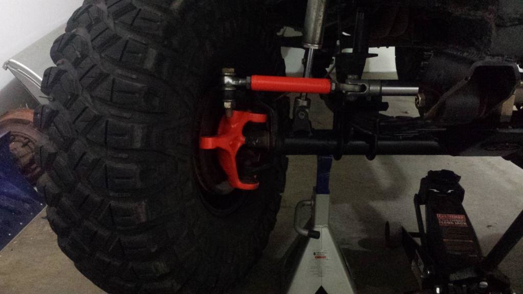

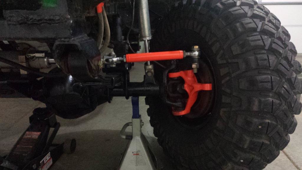

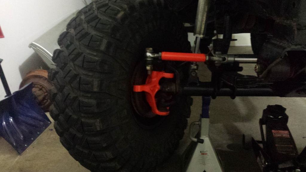

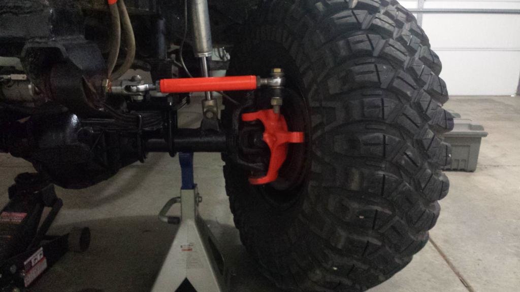

    Well since the videos are still not working and I am trying to figure it out lol...
    I adjusted my steering stops and ram stops and gained a TON of steering. It steers SOOOO much better now. I honestly am not sure what I am more excited about... the SC or the steering.
    B4
    After
    Before
    After
    Pirhett likes this.

    Why did you have your steering limited so much?
  11. Feb 25, 2015 at 5:42 PM
    #1051
    Supra TT
    Supra TT [OP] Supercharged Lifter
    Jan 3, 2011
    #48645
    7,226
    Eric
    Indiana
    2000 SAS D60 F/R Supercharged
    Supercharged on One Tons
    Because of the previous leaf spring width I had at 36". Now they are at 31" and I can exploit that turning radius now!! I basically went until the u-joint binds and backed it off 1/8" and limited the ram there.
