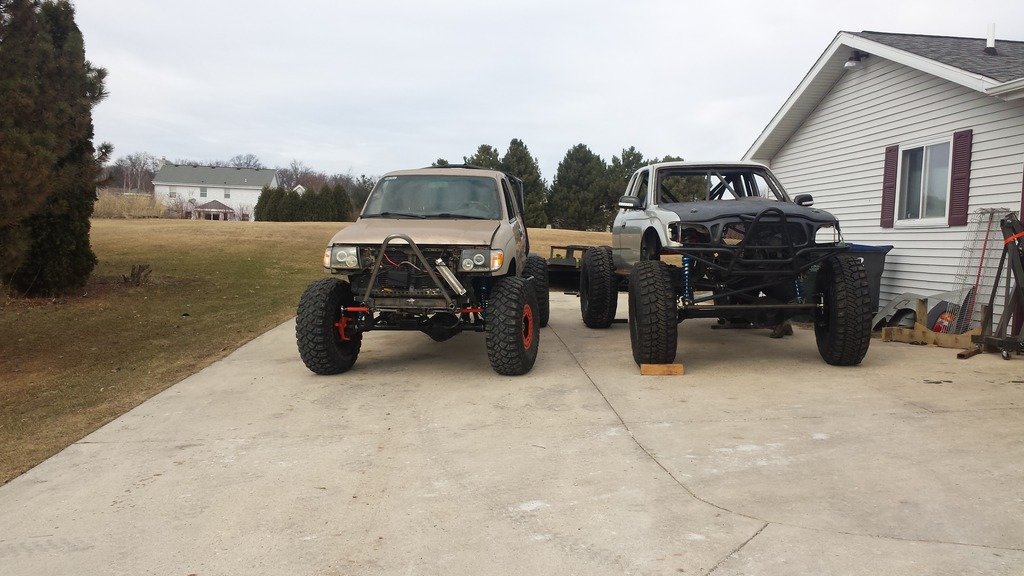

    BRING ON PICS OF THE SHITBOX!!

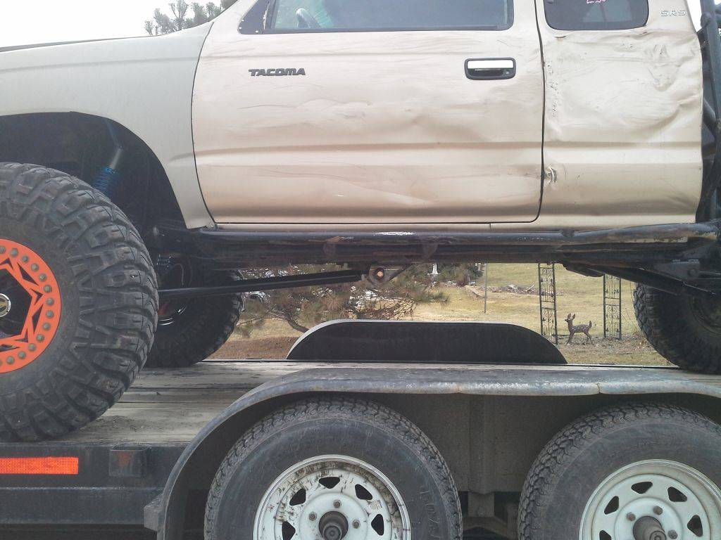

    The location of the frame end link mounts turned out nicely. Should really help with protecting the T-case.

    Coming coming coming..sheesh

    Damn! Those links are long! I knew the spring rates would be too light :p

    How long are your links? Mine are 44" eye to eye. I thought that was normal... I dunno. Yea after seeing so many people with 200/250 or more I was like Yea.... These ain't going to work lol

    41.5 I think. What material? Mine are 2.25x 3/8" thick DOM. Overkill but I will never bend one :D
