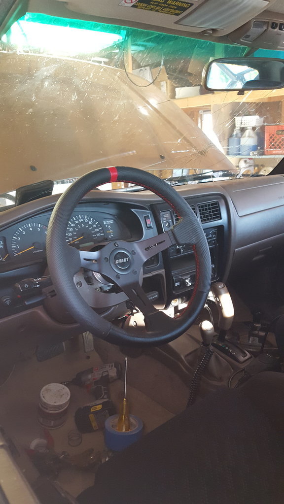

    Yea, I don't have cruise anymore, or a horn. Full hydro ruined that haha. My stock wheel was just worn out and I hated the size it was. And now I can recenter my wheel much easier with the quick release.

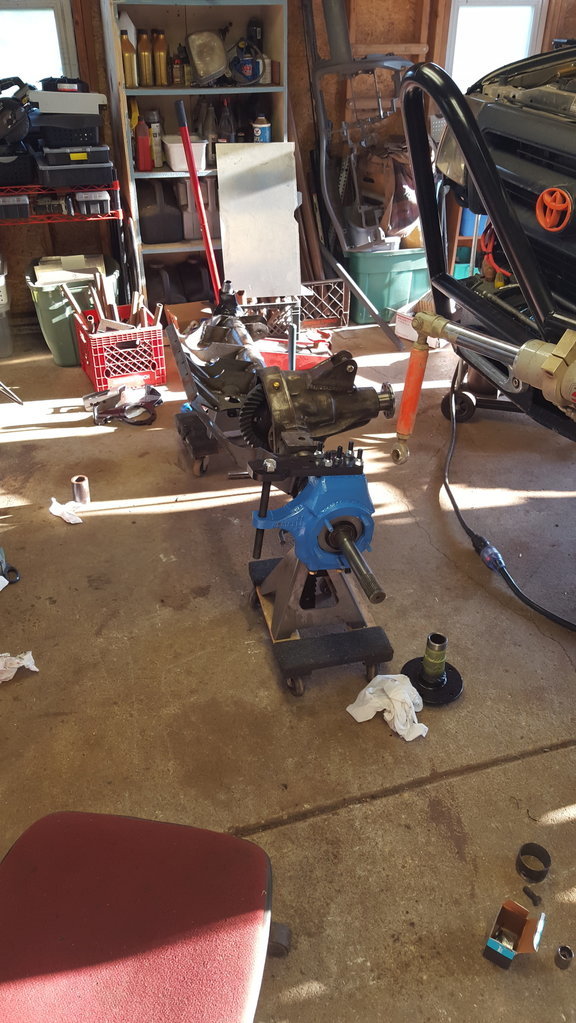

    Used a bronze sleeve/bushing I had laying around. It fit perfectly in the splined coupler and over the OEM splined section of the steering shaft to get it centered before welding it on.

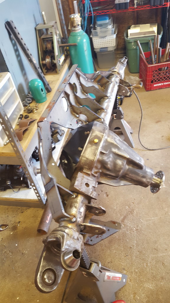

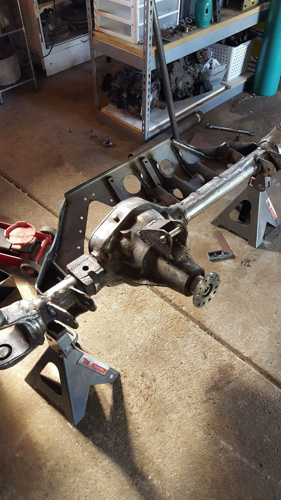

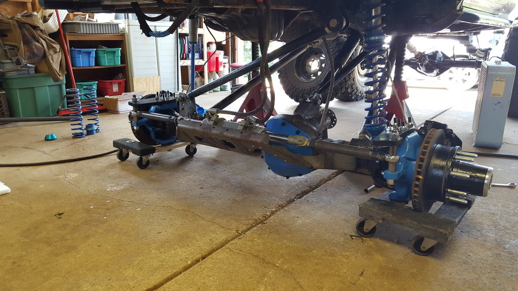

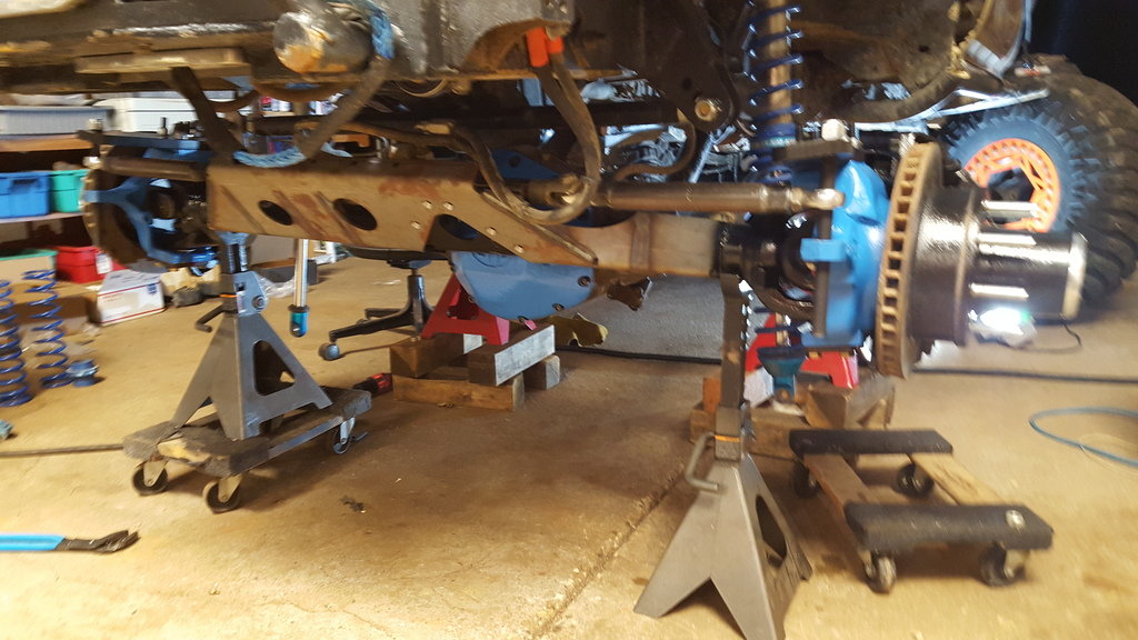

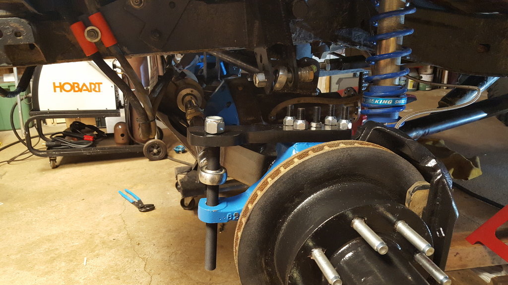

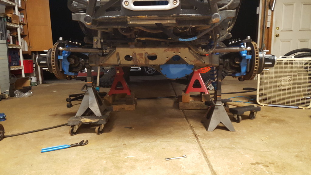

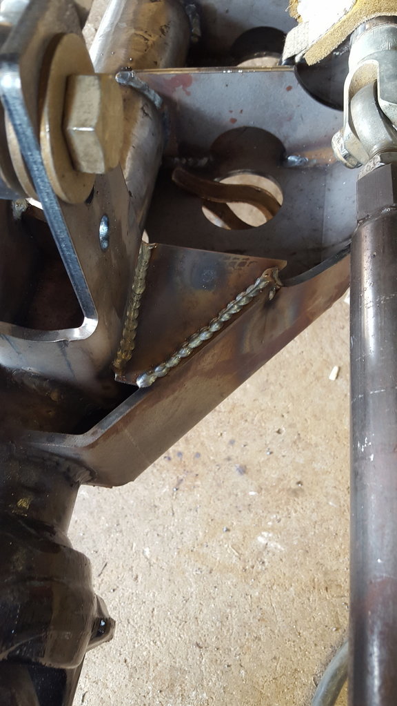

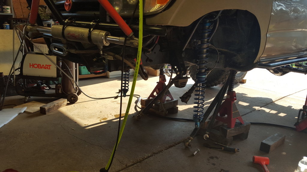

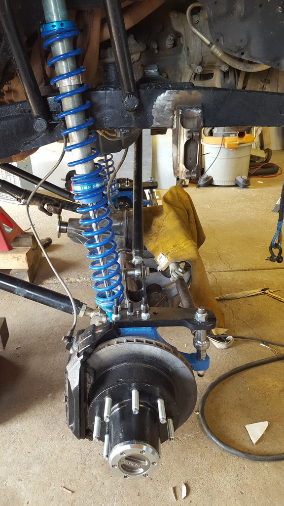

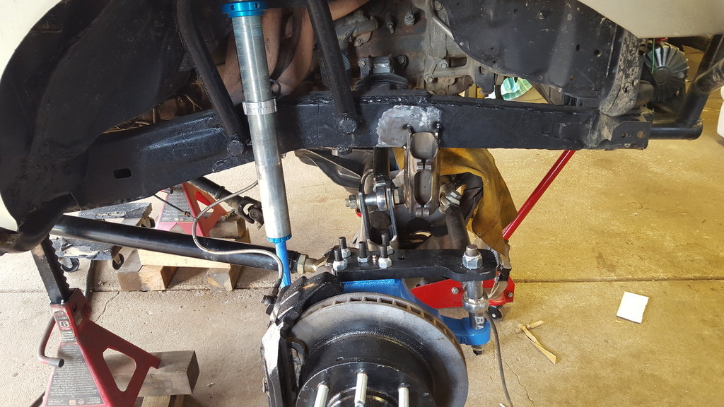

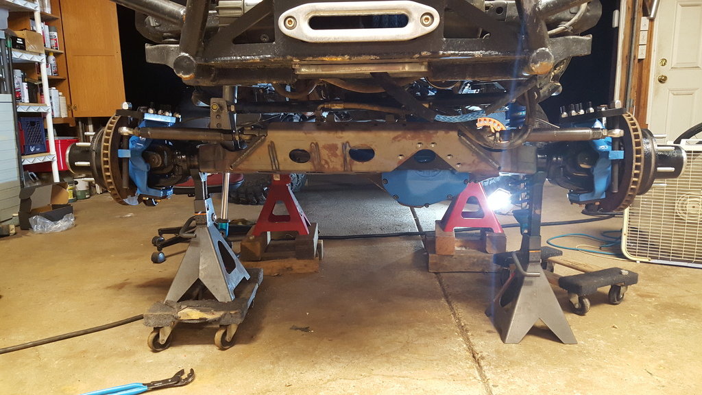

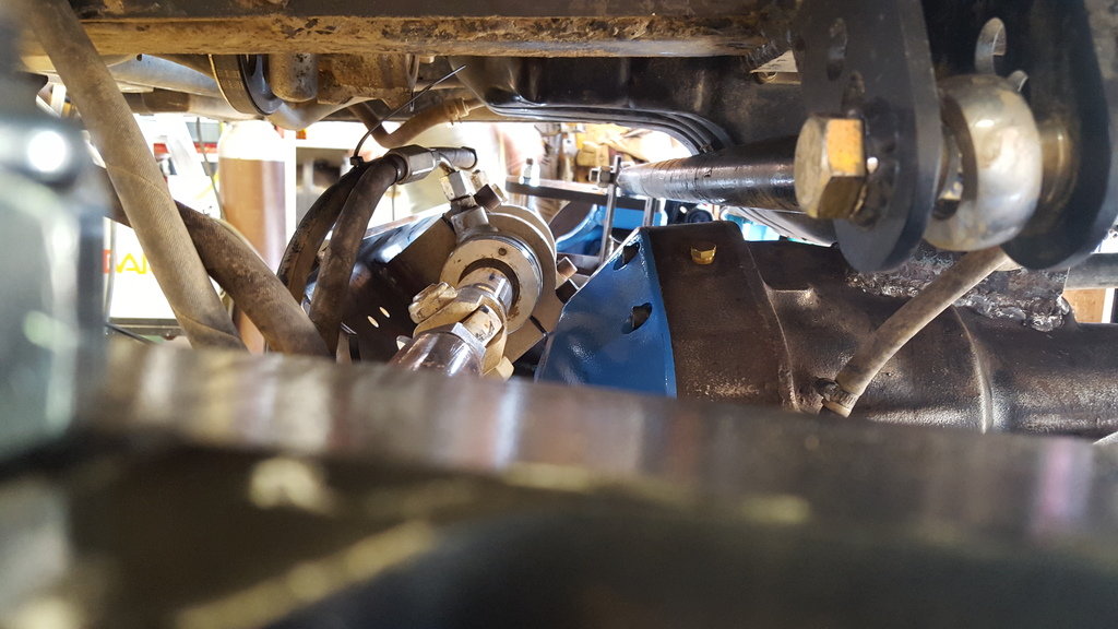

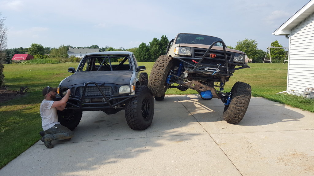

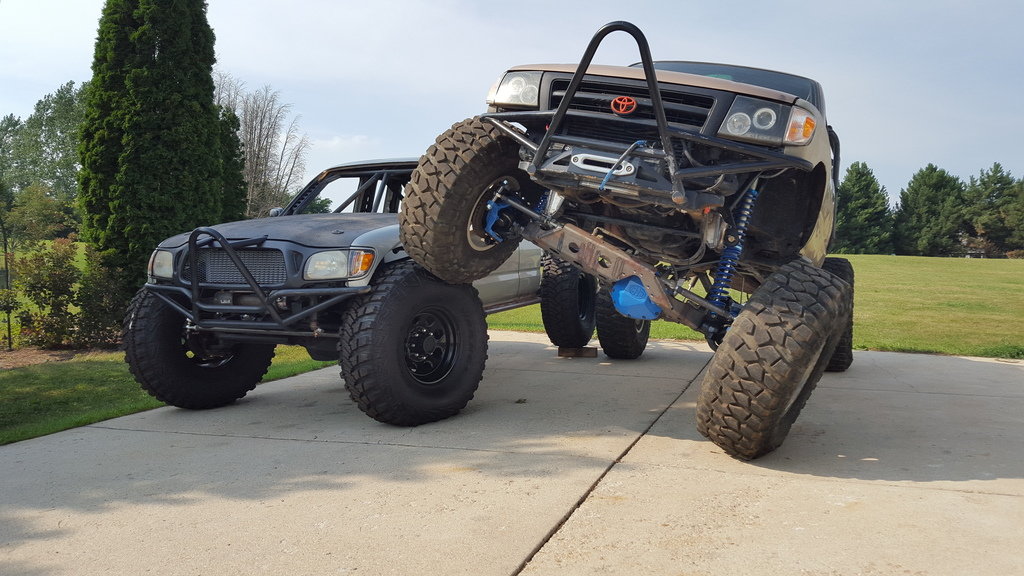

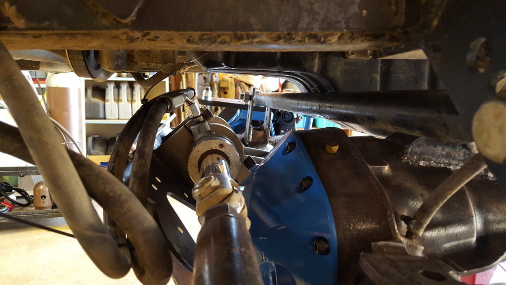

    OK, got some time finally. First.... Thanks again to Jon (45acp) For making this shit happen... muchas gracias!
    First step, remove old axle...

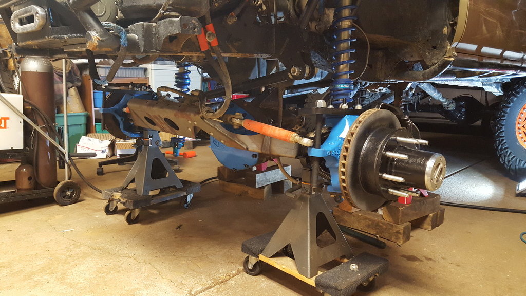

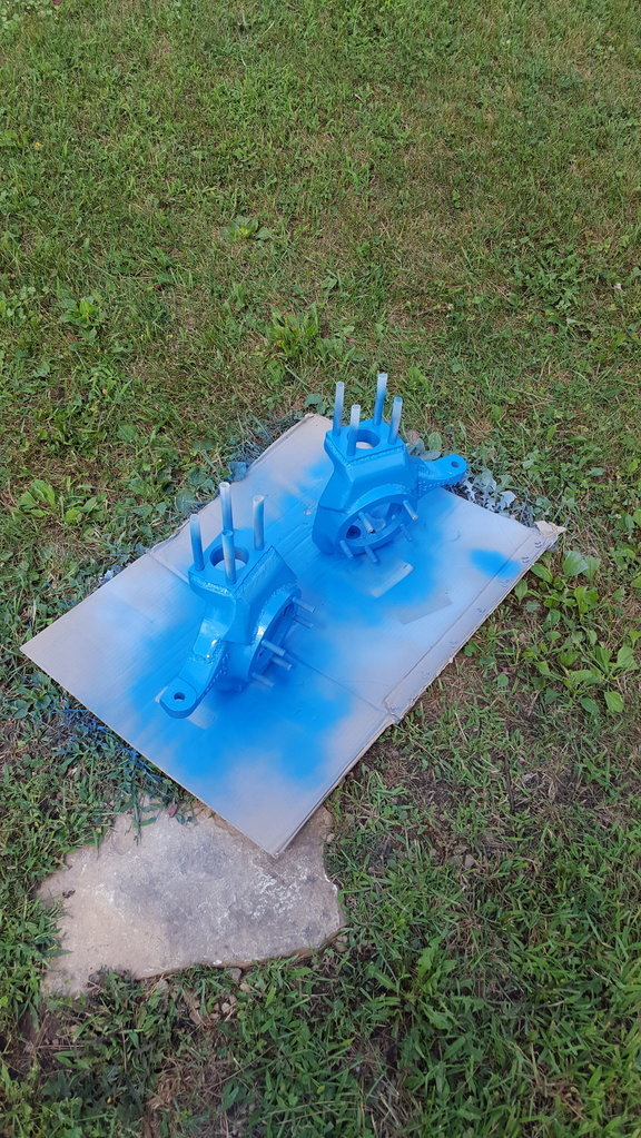

    Went with blue accent to match the kings.
    Jon put the new wheel on for me. Slightly smaller and got rid of the ugly beat up tacoma wheel. So much nicer it's stupid. I should of done it years ago.

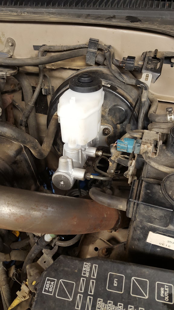

    Got the T100 1 ton MC... DIRECT BOLT IN. Awesome.
    Test fitting
    Looks SO GOOD in there.

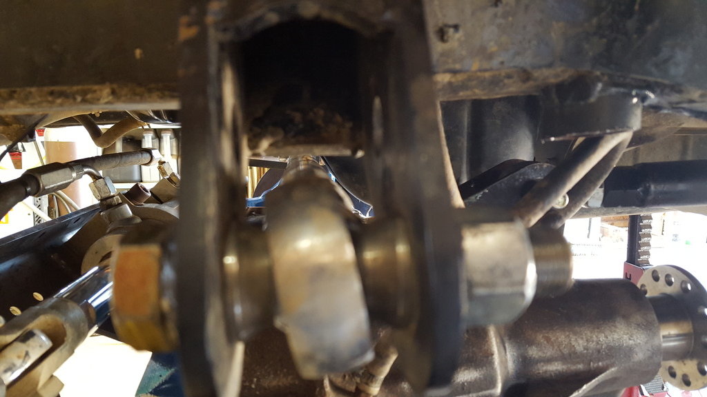

    It's tight in there.
    Mils from the oil pan.

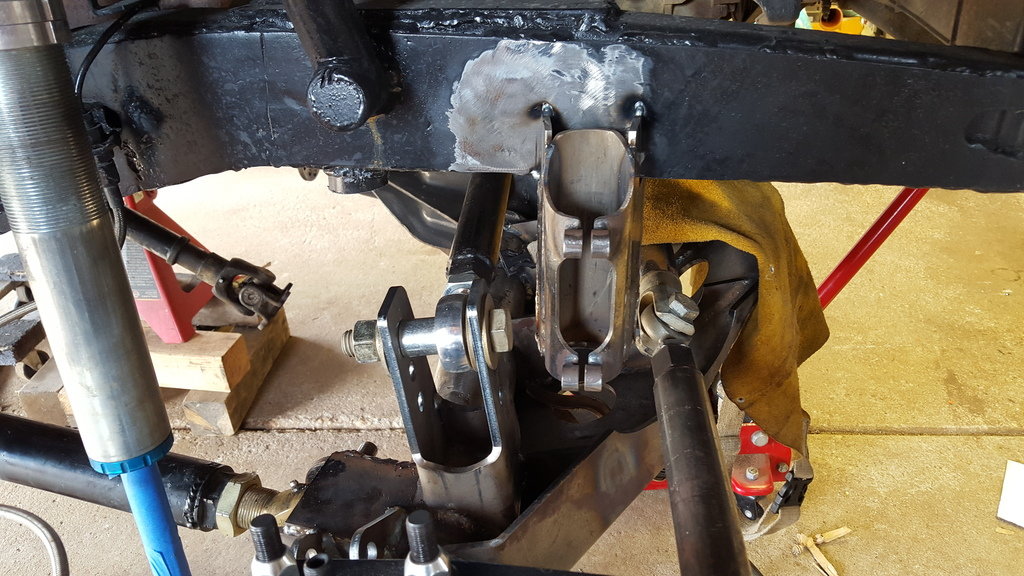

    Bump stops Jon designed...
    Driveshaft doesn't have enough droop... it's never ending with these fucking trucks I swear.
    Adding the bump stop reinforcement for the pads (not the actual pad)
    It's IN!!!!!!!!!!!!!!!!!!!!!!!!!!!!!!!
    Jon putting his truck together for a photo... GTFO JON!!!!!!!!!!!!!!!!!!!!!!!!!!!!!!!!!!!

    How's the t100 MC work? Make braking better???

    Hard to tell just yet, Monte. We got the front calipers bled. But despite using penetrating oil, BOTH rear bleeder valves ripped off they were so seized up. :mad: Both rear calipers will be replaced.
    On that note, does anyone know why the bleeder valves are ALWAYS a pain in the ass? Is the brake fluid acting like loctite? Good or bad idea to put anti-sieze on those?
