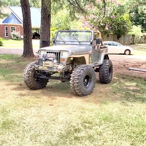

    good axle choices. nice build. helped my roomate swap his dana 30&35 out of his 88 jeep yj. now he's sitting with half tons, d44 front and 9" rear with spool in back. 5:13s lift springs and a stretch kit and 38 in bloggers. hope you have as much fun with your build as we do with ours (his)yj.jpg

  19. Nov 18, 2016 at 11:09 AM
    #1459
    1999RegCab
    1999RegCab Well-Known Member
    Apr 4, 2014
    #127007
    1,522
    Cacti Land, AZ
    1999 Reg Cab, 2.7, 5 speed
    3-link SAS
    Very true. Not exactly the same situation, but When I had IFS I had a lock right in the front axle while the rear axle remained opened for years. It worked out great for the very reasons you mentioned.
    Now I have 1tons and 40"s with a grizzly locker in the rear and air locker up front. However, I have an Atlas transfer case... so front digs takes care of the turning radius in tight spots :D
