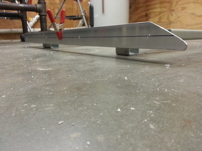

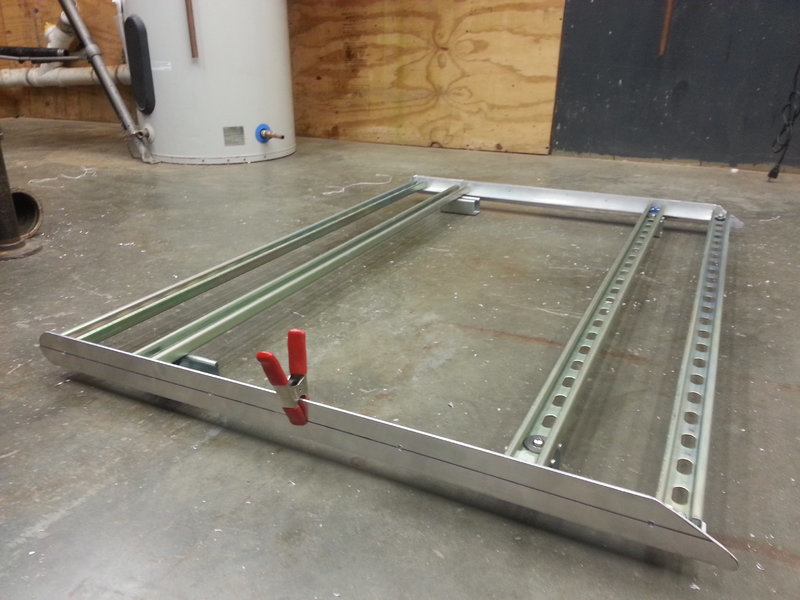

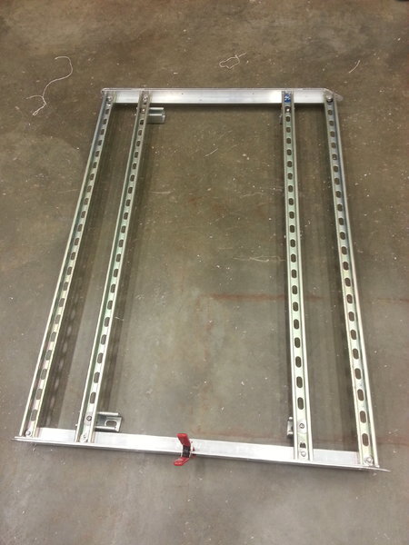

    Here's a peek at my cab rack I'm building right now. Its just about ready for paint and may be ready to mount it on Monday hopefully if things go right.

    Nice! so it looks like you went with crossbars mounted directly to the side panel (no unistruts used for "frame"). is this to cut back weight? the side panel cut is killer. nice job.

    Well this is an experiment to see if the angle bar is sufficient, I may end up running one along the sides between the middle two cross members.
    Not really planning on this to carry a whole lot of weight since the rear rack will be doing most of that. I just wanted to be able to carry longer loads like ladders and dimentioal lumber so I wanted something horizontal over the cab .
    We'll see how it goes, I'll give it the 200 lb test tomorrow when I stand on it and see what happens. :D

    What kind of info are you looking for? The materials and fasteners are all the same as my original post, only difference is I changed the shape and size for the cab rack to 30in.

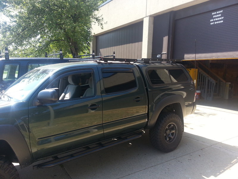

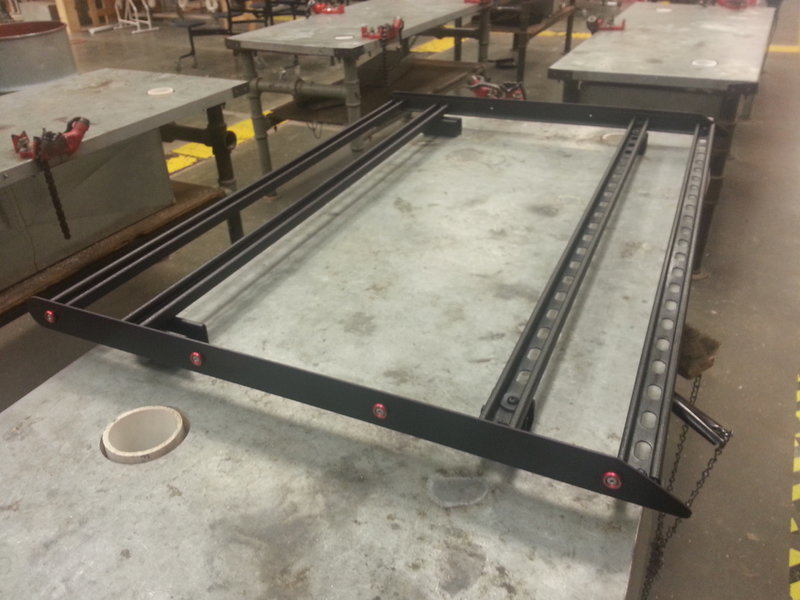

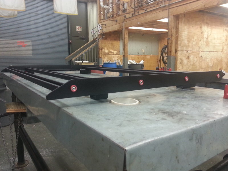

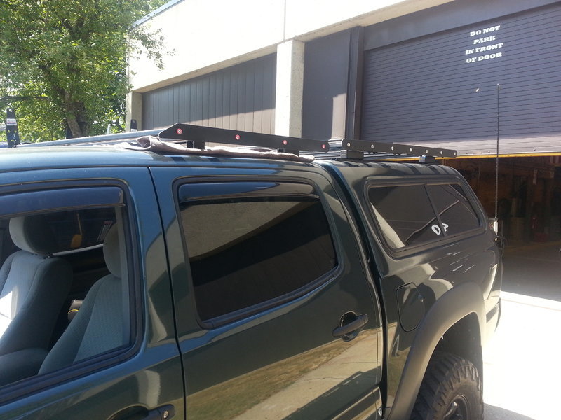

    Here's the cab rack all painted up then I did a dry fit. I'll need some spacers to get it up flush with the rear one. I see some trial and error coming soon in my future.

    Looks great. If you plan to keep the weatherstrip that runs through the roof channel, there is a wire that runs through the center of it. I assumed it was 100% rubber and tried to drill it. Don't do that. The best method I found is to use a hobby knife to cut the holes for the spacers and then snip the wire at either end.
