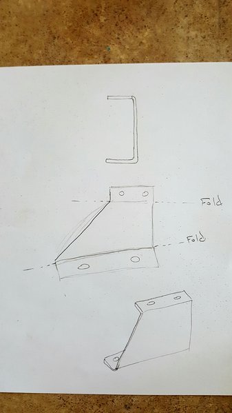

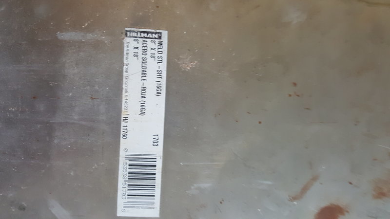

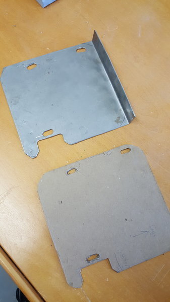

    Sorry my class need a little more attention than I was expecting, but I've been building a few mounts lately for other projects around the truck and this might be your silver bullet.
    It's 16 gauge steel sheet. Cuts easy enough with a grinding wheel or jig saw with a metal blade and if you have a vice or strong clamps you can bend it with a mallet or brute force. Same thickness of of steel used on joist hangers for construction.

    So you think I'll be able to bend it with my strength and a mallet. But it will be fine to support the weight that it will take?
    scottalot likes this.
  19. Sep 27, 2016 at 11:49 AM
    #319
    ERMB
    ERMB [OP] Well-Known Member
    Mar 11, 2011
    #52813
    10,395
    2002 Land Cruiser
    Yes, with some brute strength you can definitely bend it, and because your essentially creating a C channel it's quite strong. remember the weight is going to be distributed along all three bolted positions but from a top down strength is still going to be able to bear pretty much what ever you can dish out.
  20. Sep 27, 2016 at 11:50 AM
    #320
    CO_0321er
    CO_0321er Well-Known Member
    Jun 27, 2015
    #158286
    1,850
    Hmmm. I like the idea. But I don't know if I'll be able to bend it precise enough. And it's only bolting into the front and rear holes. The middle is no dice
